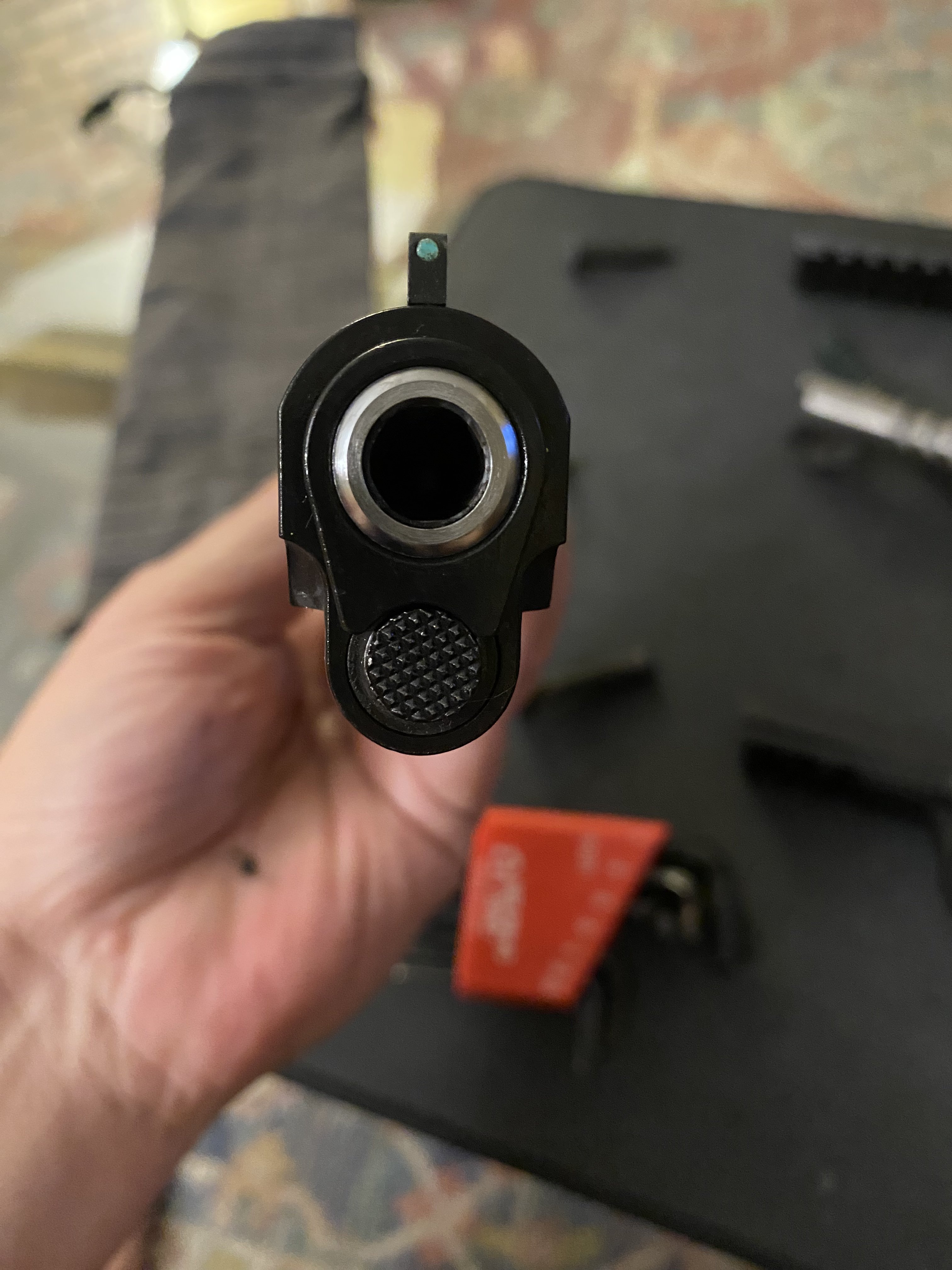

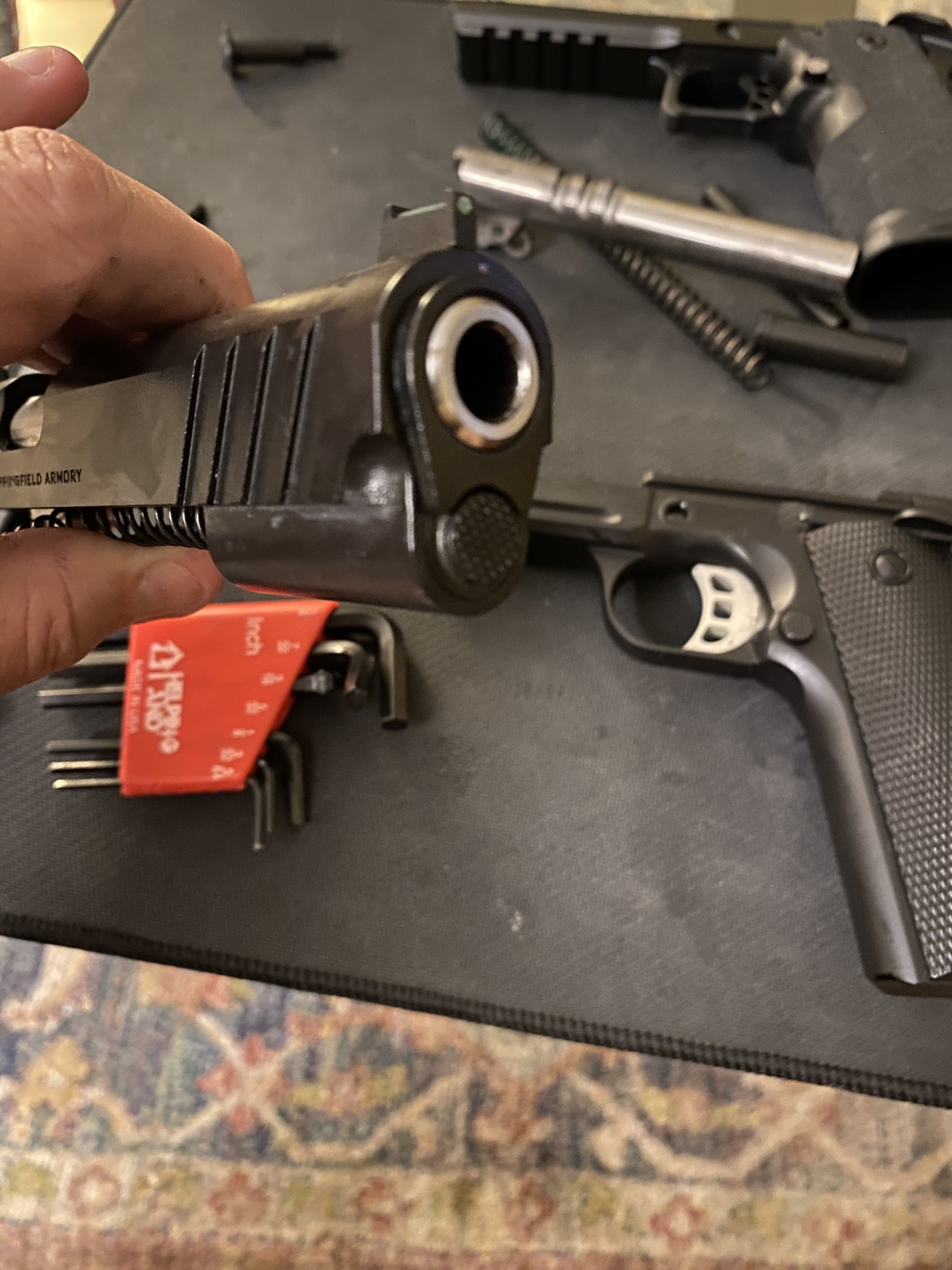

Can you check yours and maybe post a few pics? Let's see the inside of the front for the bushing cuts?
I can confirm that the bushing from a regular 9mm will fit the Prodigy. I took the bushing and barrel from my Tisas Duty BR and had no problem fitting them in the Prodigy slide. The slide has the correct cuts for the bushing and it installed as normal
DSC has a drop in compensated barrel, and it's a production gun, I wouldn't think the barrel would be fit to the slide. This is my first 1911 style pistol and it's bushingless. Is a bushing needed to get the threaded barrel? Also how is the build going? Run into any problems yet?
