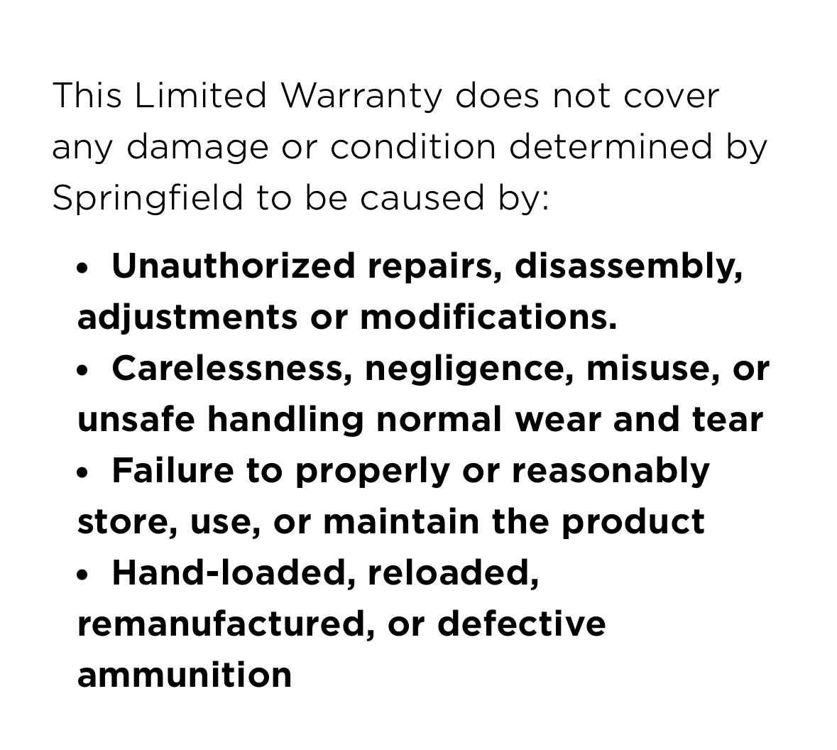

I recommend a gunsmith, plus note then likely you will void the warranty,
Plus I wouldn’t listen to those YouTube stuff on any gun modifications, always use a reputable gunsmith, just sayin
