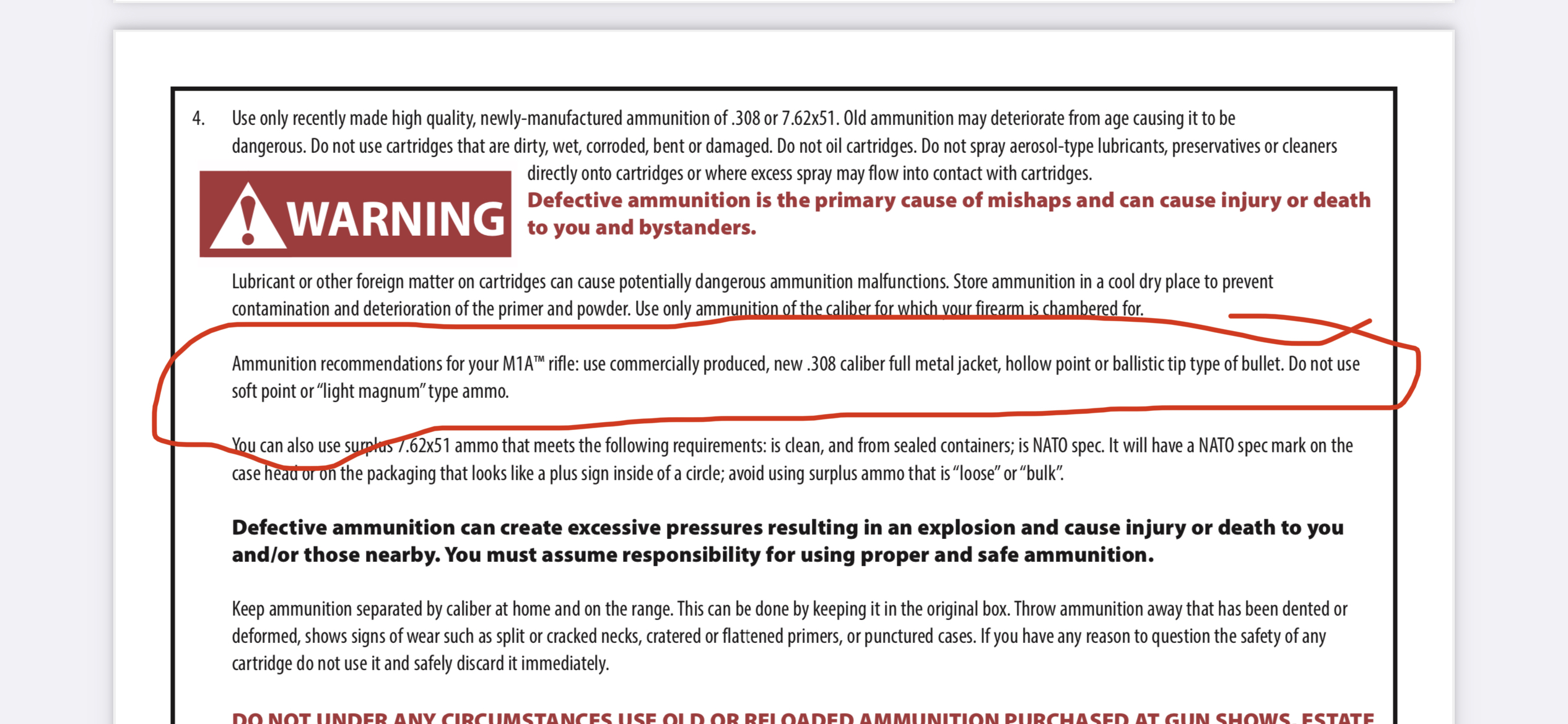

To all the new M1A owners out there:
Congrats on your new rifle!
FYI ….
Did you happen to read page 6 of your manual?
Probably not is my guess.😏😏🧐🧐
It pertains to ammo and what NOT to use . Soft tip or magnum is a no no.
Lots of folks didnt know about soft lead tip. Like the “powerpoint” soft tip ammo.
Results in chamber build up of the soft components
Beware of “slam fire” as well.
Pgs 5,6,7 cover the ammo to use

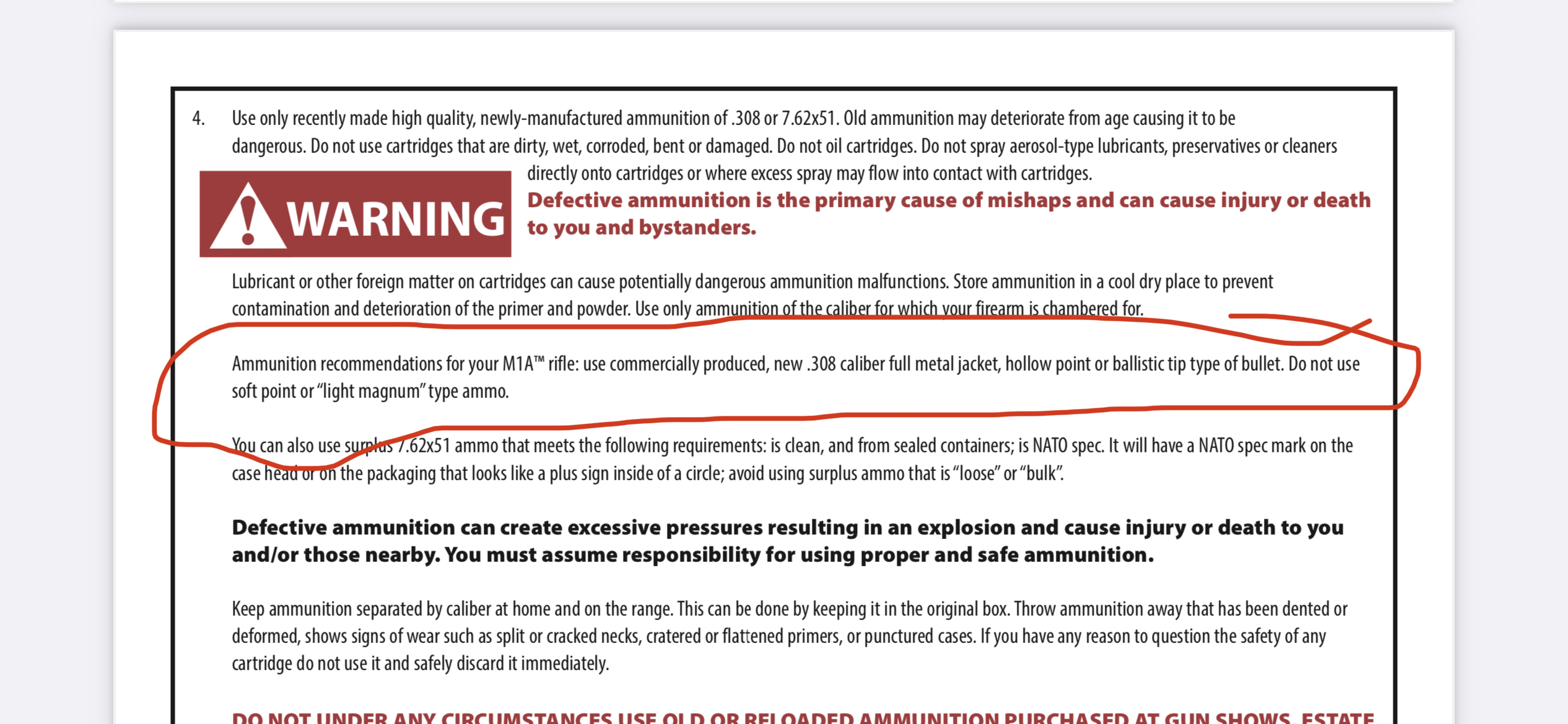

FYI ….
Pgs 5,6,7 cover the ammo to useView attachment 30427
