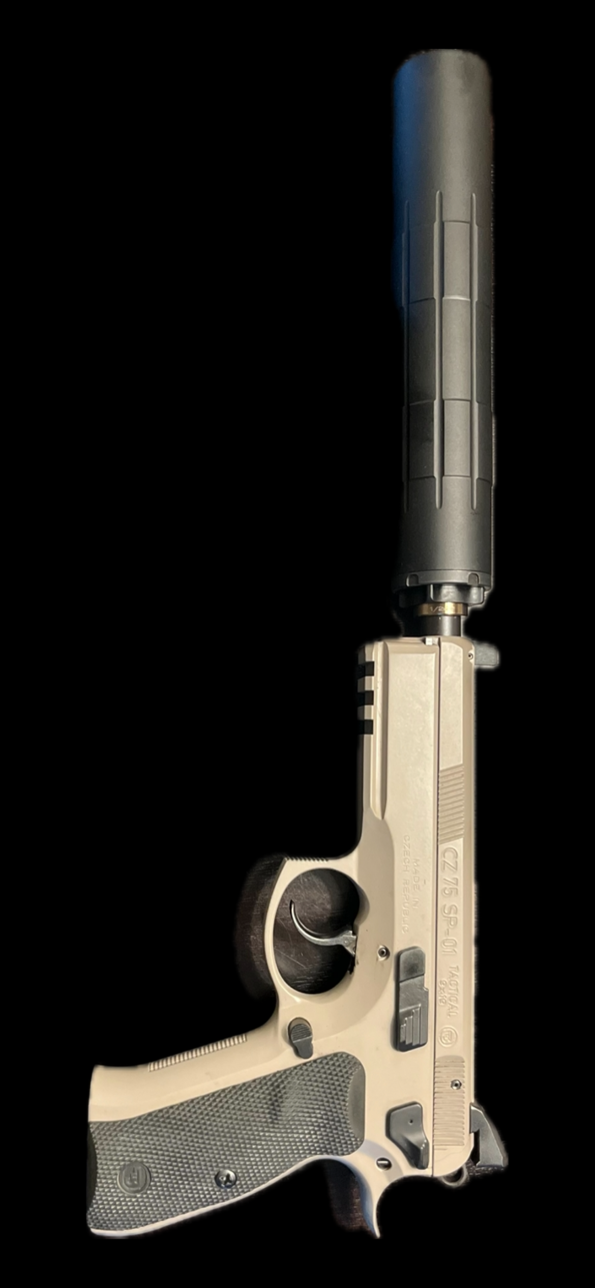

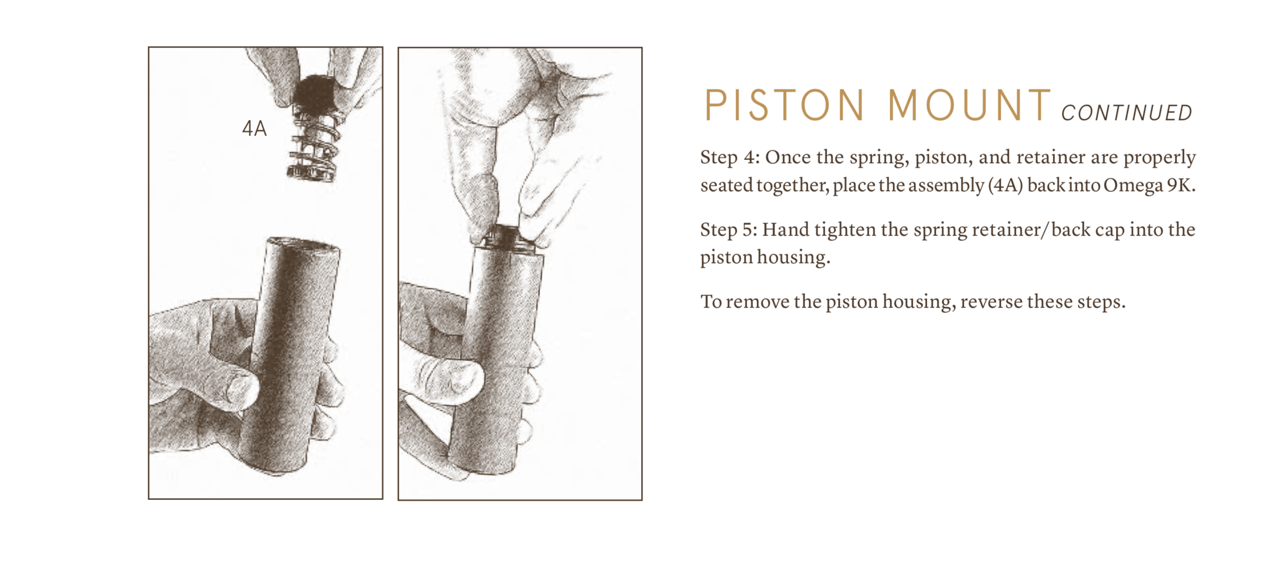

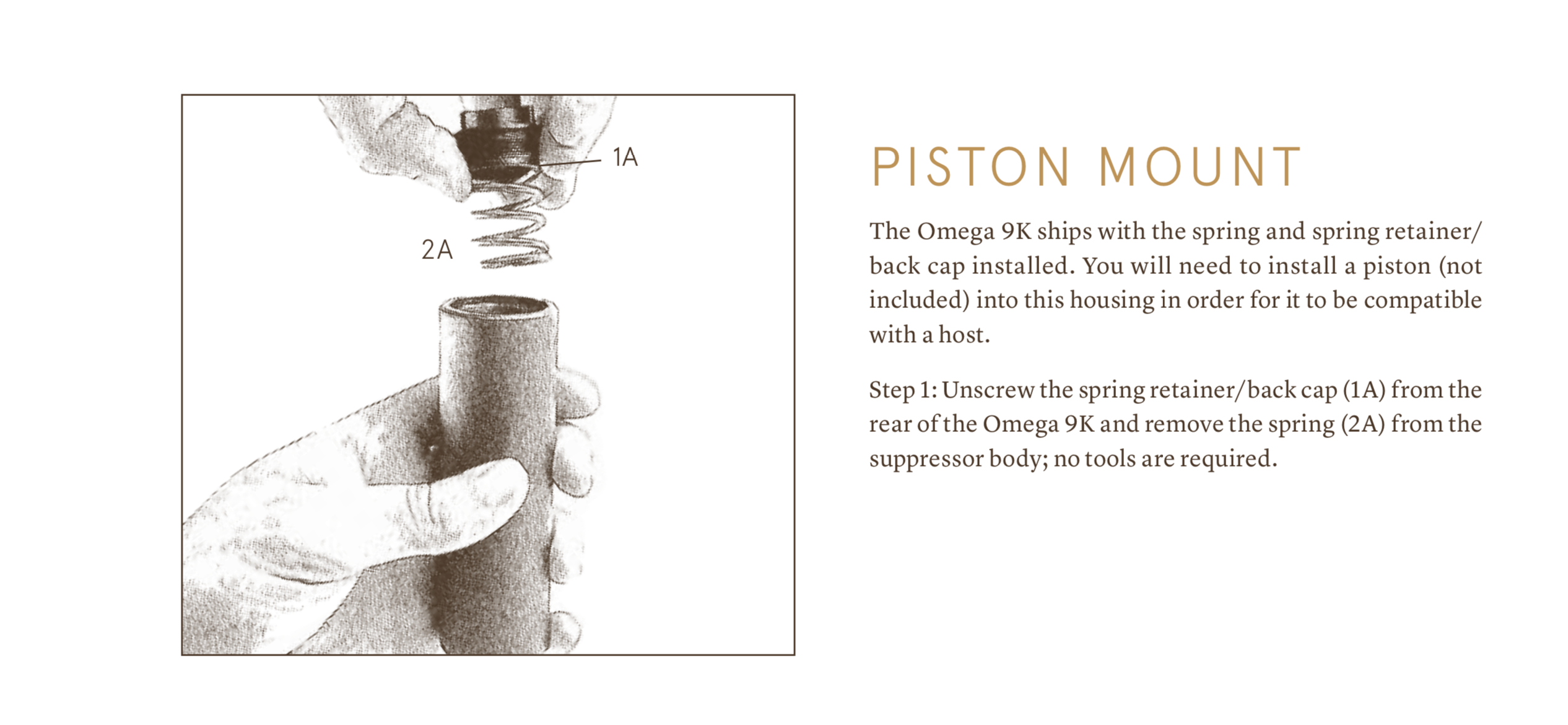

Almost all suppressors you want to put on a pistol need a “piston”.
This can be purchased from the suppressor manufacturer.
You replace the internal spring assembly with the piston. Pretty quick change over. Allows the suppressor to work with the slide/barrel going back and forth when fired.
Yes, then you just screw the suppressor onto the barrel.
Example here for my suppressor
View attachment 47578View attachment 47579View attachment 47580
