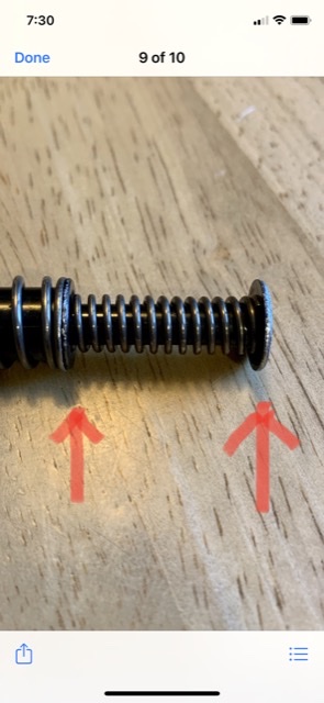

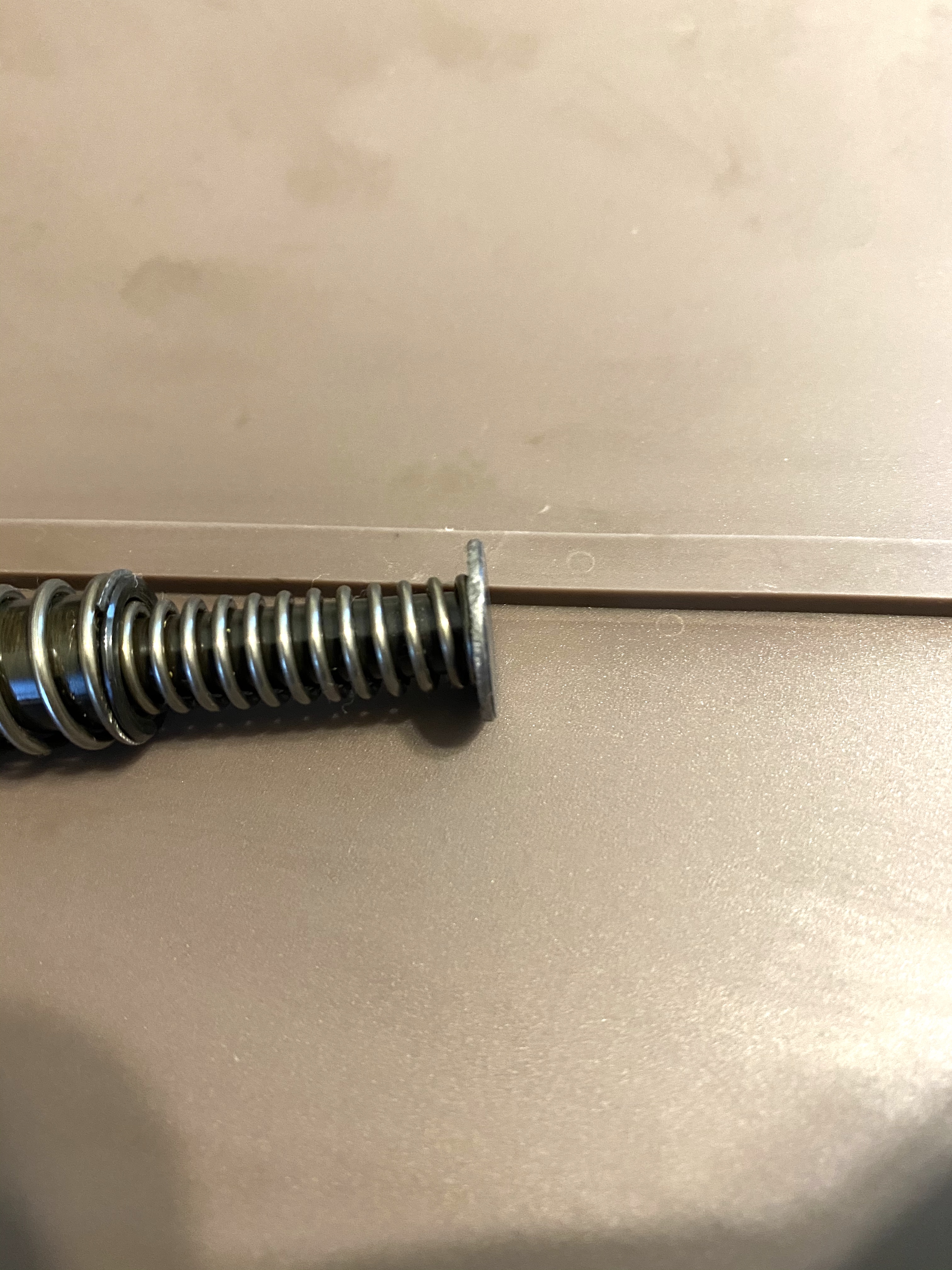

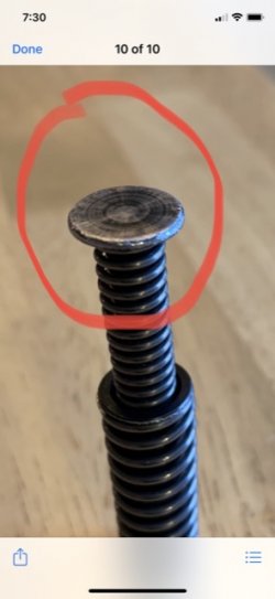

I’ve also noticed some abnormal wear on the guide rod assembly for my XDS45 during my last cleaning. This is my carry gun. I’ve shot maybe 200/300rds. I’ve contacted Springfield customer service via email and telecom and they’re telling me this is normal for the spring assembly. I still beg to differ. I own or have own many handguns with 5x the amount of rds shot and have never seen damage like this on a spring assembly before. The service agent told me on the phone that I could purchase a new one. Why would I buy a new one if it’s gonna do the same thing. Very disappointed with Springfield on this matter.
