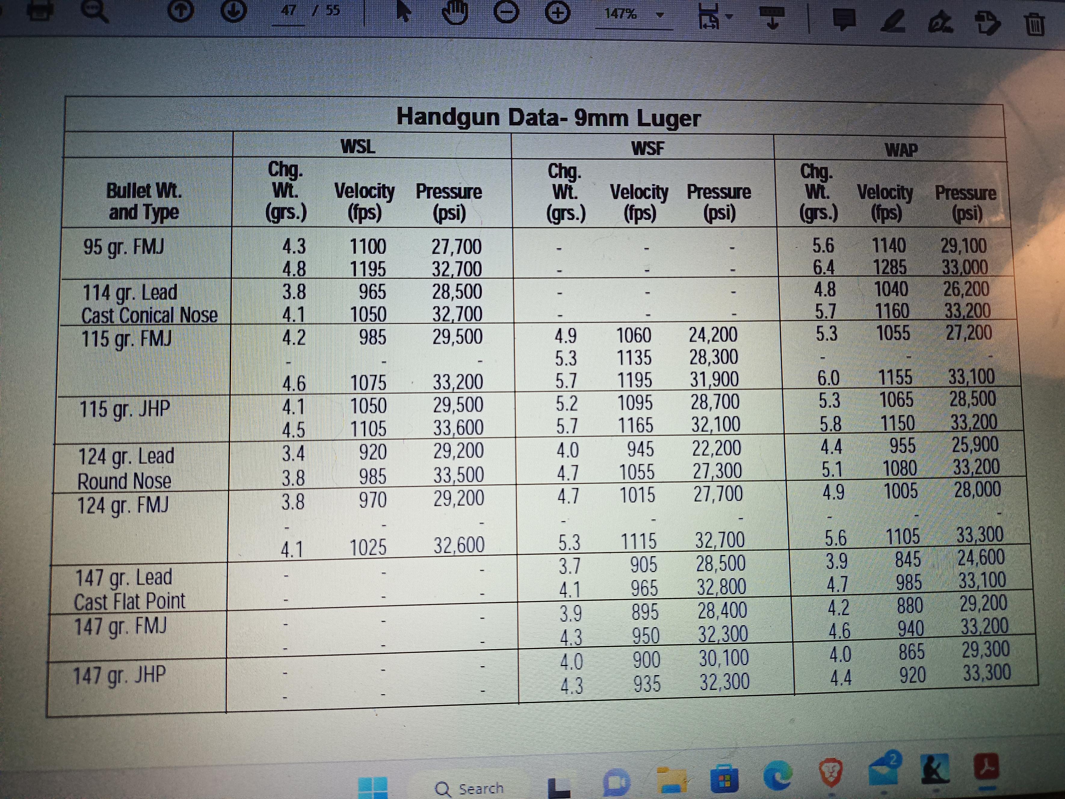

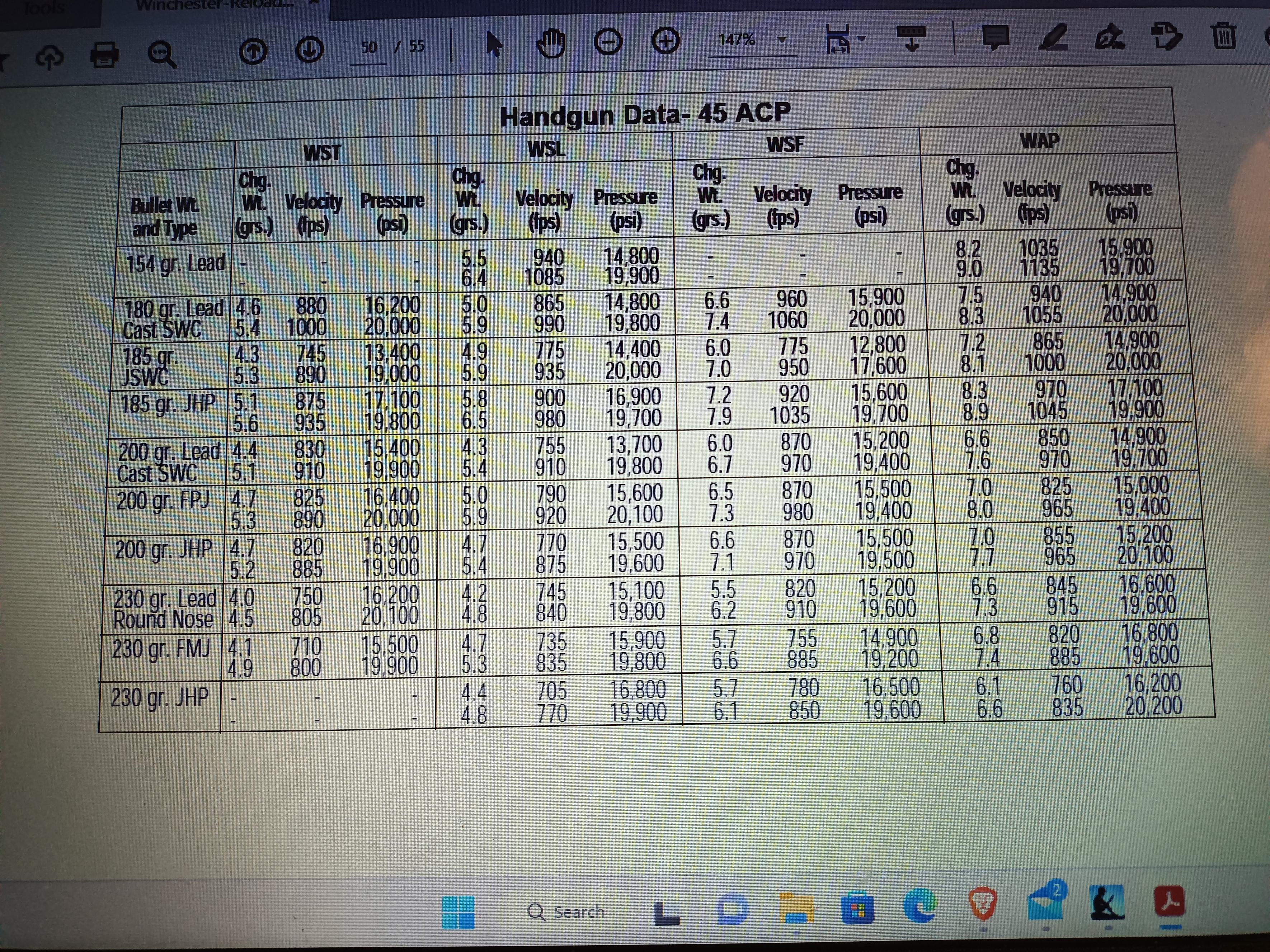

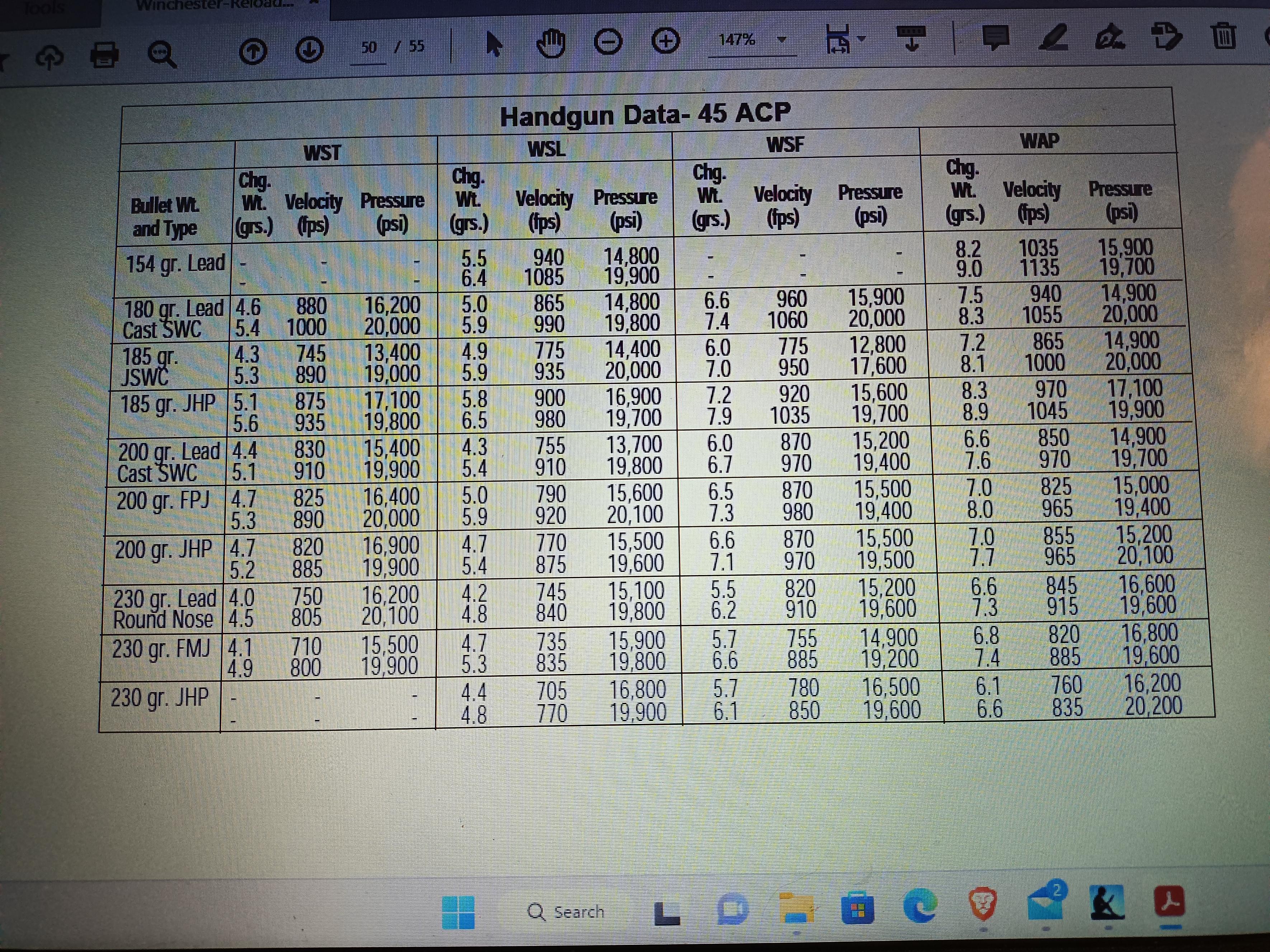

Here are 2 pages from a Winchester Reloading manual. I'd have to check my scale to see what I'm using for 9 and .45, but I did use these as a guide. I found the reloading manual by doing an Internet search. It's the 15th edition, 1997.
