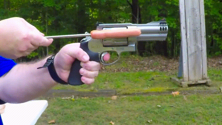

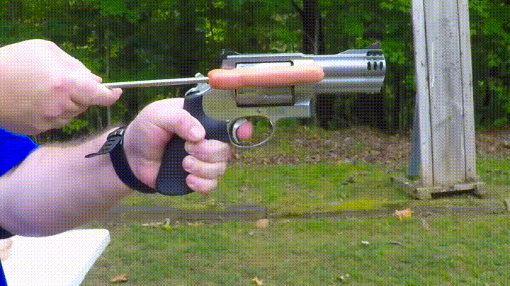

yeah, i am an avid viewer of "Hickok45", and a long time ago, he did a segment on the dangers of the revolver with the wrong hand grip.
always a great idea to repeat this information, for newbies and others who may be "absent minded"
(he has way too much fun..... :ROFLMAO: )
