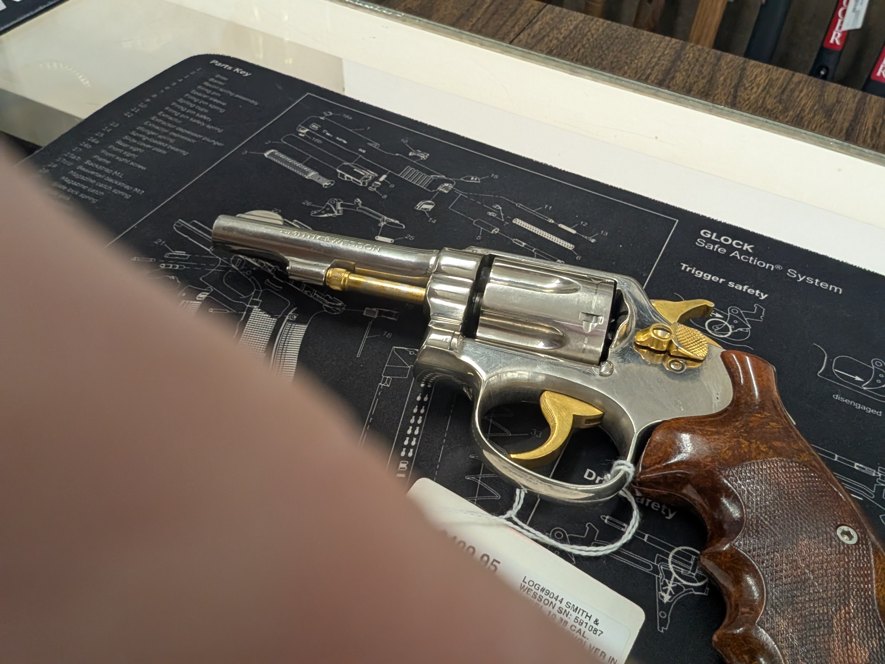

Found this at pawn shop. I assume it has been refinished? It is 5 screw. Obviously grips are not original. Wondering if 2 tone has any special significance . Looking for any info before returning to pull grips to see actual ss#. Value??

If the serial number starts with a "V", its a victory model. Otherwise its an old Military and Police Model of 1905. In that case the nickel finish may be original. Check the sides of the grip frame and underside of the barrel for a "N" marking indicating a factory nickel finish.
Its definitely not original. Nickle with gold accents were fairly popular in the 60s into the 70s. In the current market, it hurts the value a lot.
JMHO, I'd guess about $400 tops. Personally, I'd pass.

Yes, some folks like aftermarket parts. For collectors, however, it hurts the resale value. But I think it looks pretty cool. I like the grips on it too. Are the grip panels wood or ploymer? I'd say Mr. @Grayfox is pretty close with his $400 value. Buy it for less if you can. ;)
Edit: I did a quick look around on gunbroker.com. Depending on barrel length, the "Victory" models are listed between $250 and $800.

Check for any re-importation markings and cartridge chambering markings. Some Victory models were originally chambered in 38 S&W for use by the British during WWII. Upon re-importation, they were "re-chambered" to take 38 Special cartridges by lengthening the charge holes slightly. Unfortunately, these altered guns aren't safe to shoot as-is. The 38 S&W cartridge is slightly larger in diameter than 38 Special. Not good. The Victory models which were re-chambered thus will suffer split cases. Also, the bore/groove diameter for the 38 S&W is slightly larger (by about .002" to .003") than the 38 Special, so accuracy will likely suffer. On the other hand, if it IS a 38 S&W and hasn't been monkeyed with, it should be safe and reasonably accurate to shoot.
Plated finishes are not my thing, by the way. Just a personal opinion based upon personal experience with a factory plated Colt. They're gorgeous while the finish is intact, but the plating can be damaged by certain common gun cleaning solvents. Once damaged, the plating goes downhill FAST.

My 2 cents worth as far as the value of the revolver: First of all, any collectible value for the gun has been erased. Look upon this as an old S&W that MIGHT be a useable shooter/beater gun. IF it was originally chambered in 38 S&W and remains so, factory ammo will be scarce and relatively expensive. Reloading will help, but factory made projectiles (.360" or .361" diameter) will also be relatively scarce and of limited variety. Casting your own slugs will help make shooting it a viable (maybe even fun) proposition. IF it was originally chambered in 38 Special, then the ammo availability / cost situation will be considerably improved, but it still will be only, at best, a "shooter grade" old revolver, and should be priced accordingly.
If the serial number on that hang tag is correct, 581087, that gun falls into a very large block listed in the Standard Catalog of Smith & Wesson ending in 1942 with serial number 700000. Best guess would put this gun as being from the late 1930s. Therefore it would be chambered in 38 Special and the nickel finish could be original.
But it still ain't worth much in that condition. :rolleyes:
