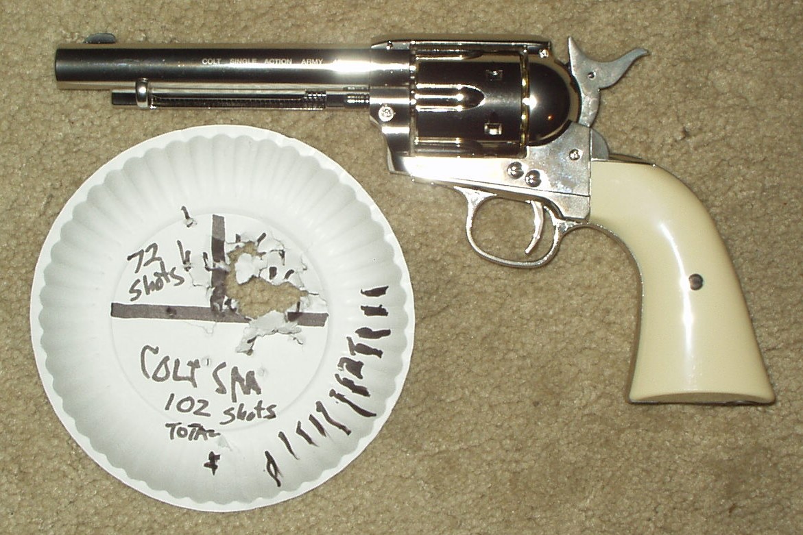

Yes, you have a great project here, and it even cost less than my CO2/BB gun! :eek: ;)(y)
