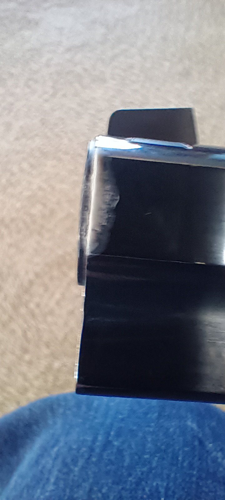

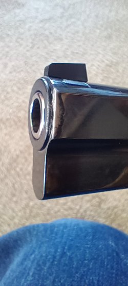

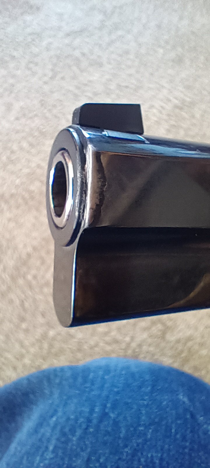

I have the new High gloss model and when I picked it up from my FFL, there was a white, powder like build up on the forward end of the left side of the slide near the muzzle. After getting it home. I removed the marks and stored it away. The very next day I found that this substance had returned and was a little harder to remove. It has been doing this for the past several days. I don't know what this is, why it keeps returning, and how to keep it from coming back. Any ideas, or does it need to be returned?

That stuff has been noted before...
The Springfield Armory SA-35 uses a threaded, secured barrel bushing rather than the soldered-in style of original FN/Browning High Powers. It has been reported that factory-new SA-35s may show residue of a thread-locking compound, which looks like bluing salts, around the muzzle area, indicating a Loctite-type product is used to secure the bushing to the slide.
I have cleaned this off several times. Is there no end in sight? What is the recommended fix for this to stop occuring? I appreciate all your responses. I have been a gun owner for decades and have never seen this sort of thing before. It will appear on its own without the gun ever firing a shot.
