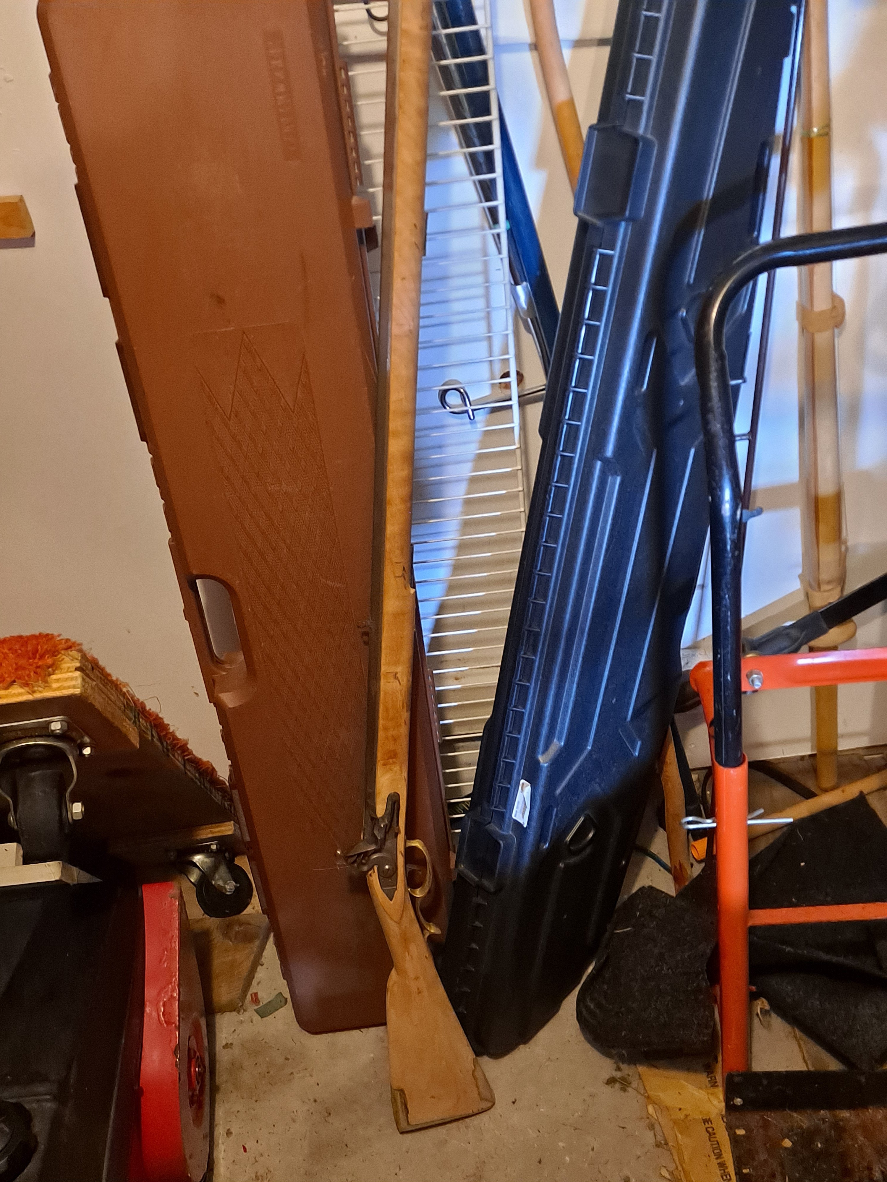

Or you can go the route I did with this one. But it's a heck of a job, and I would never do it again from a rough uninletted blank.
