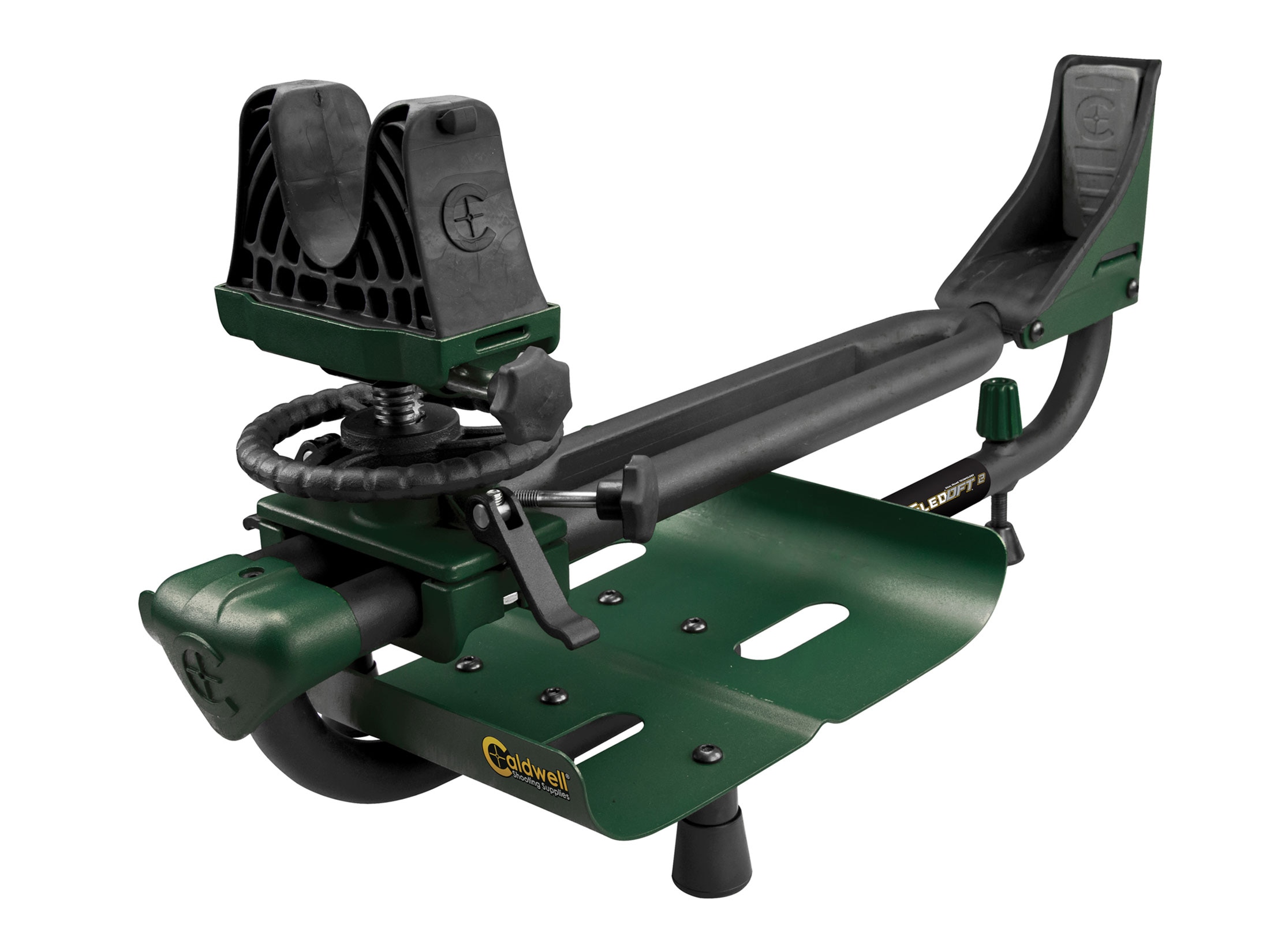

Looking to buy a shooting rest. Intend to use to zero my M1A, AR-15....was also hoping to find something to assist in zeroing pistols...although I might need a different rest/vise for that. Caldwell, Alpha, Foxtrot, Sinclair...any and all comments welcome...I am NOT a 1000 yard shooter...just looking to zero rifles better than bracing off of a wood block.

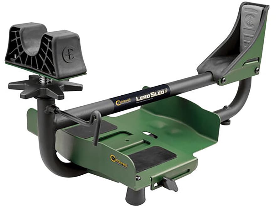

Here's a couple of decent options in two different price ranges.
Midway USA has these on sale pretty often.
I loke the caldwell and lead sled.

If I go the Caldwell route, the Lead Sled 3 is not an option, all of my long guns are box magazine fed, and that main frame bar for the 3 model prevents use of anything but a 5 or 10-round mag with most rifles...The DFT 2 is on my radar at this time...

I totally get that Keystone...but thinking long-term, I rationalize that $200-$400 for a rest that can be used on almost every long gun over a lifetime, might be worth the initial investment. I'll have to re-zero each one at least every year if not more. Every new optic = reuse the rest. I know you can zero with a bag or foam block...my dogs would love those foam blocks by the way...Not sure why but I guarantee they (dogs) would think they look delicious.

I anchor my sled down to my shooting bench using a 2x4 and two C clamps. The whole point of using a bench rest when zeroing in a scope is each shot is made from the same point. Sandbags can move around and cause a change in the point of impact. Nowadays, at $2 a round or more a shaky rest can drive up the cost of sighting in. Now if I'm shooting at groundhogs, I do use a sandbag.
