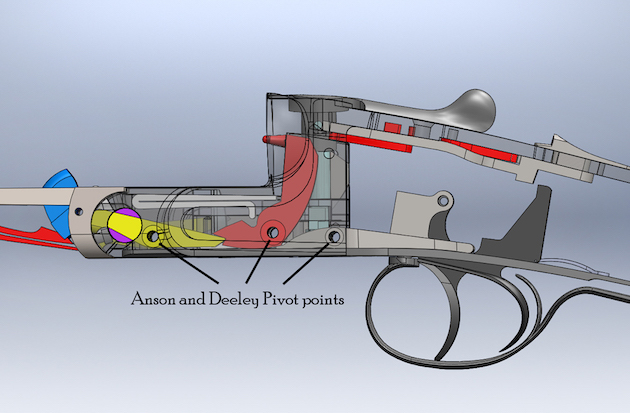

The internal Hammers are cocked when the cocking limb(s) are leveraged back when the shotgun is opened, so if someone pulls the trigger(s) when the barrel is removed they've really screwed up.
The leveraging forces the limb back against the spring tension which can be substantial.
Cocking limb: The cocking limb resets the chain reaction. When the gun is opened, the cocking limb is forced down by the fore-end to the point at which the hammer, main spring, sear and trigger are back in their original "cocked" positions.
