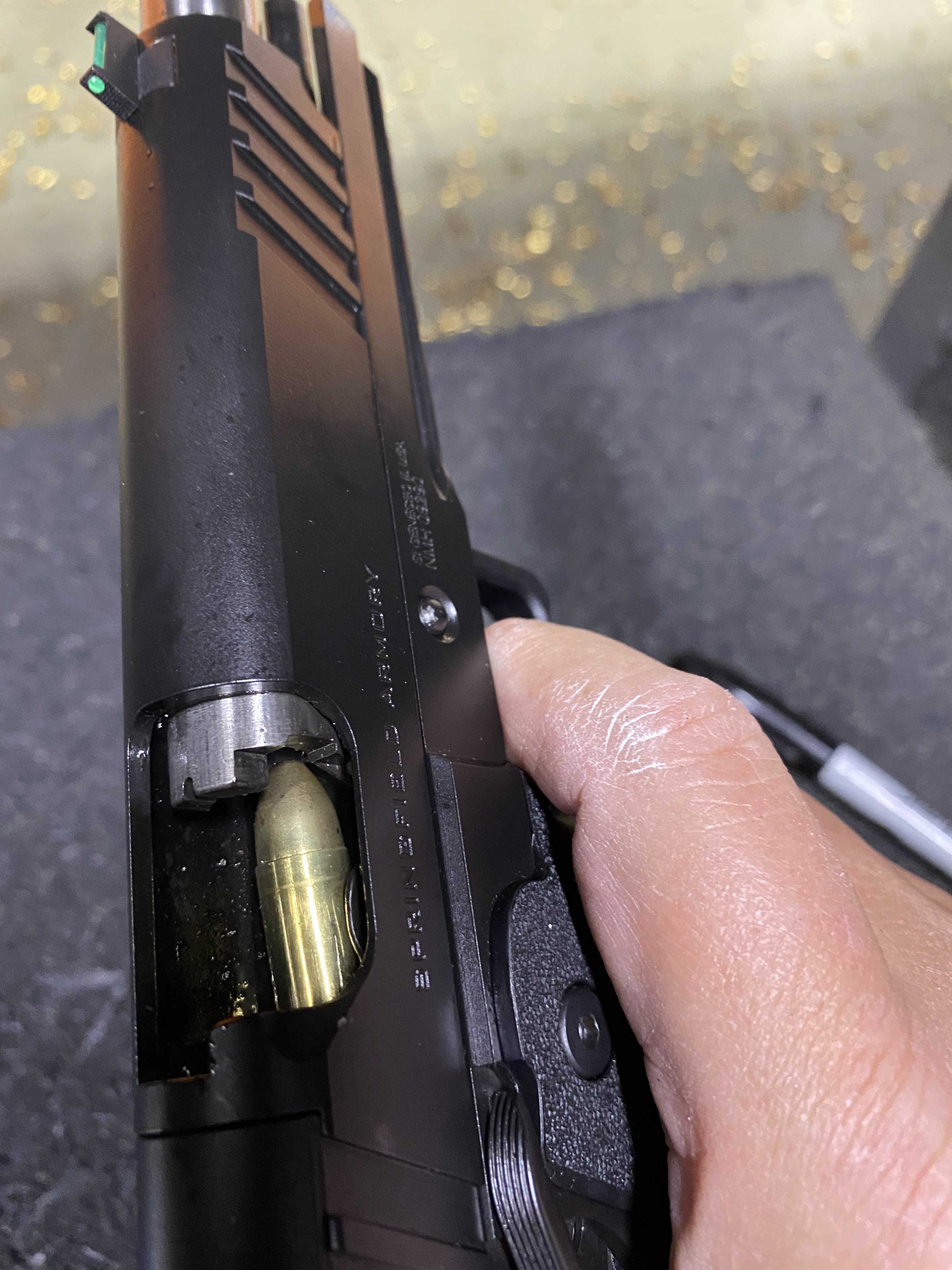

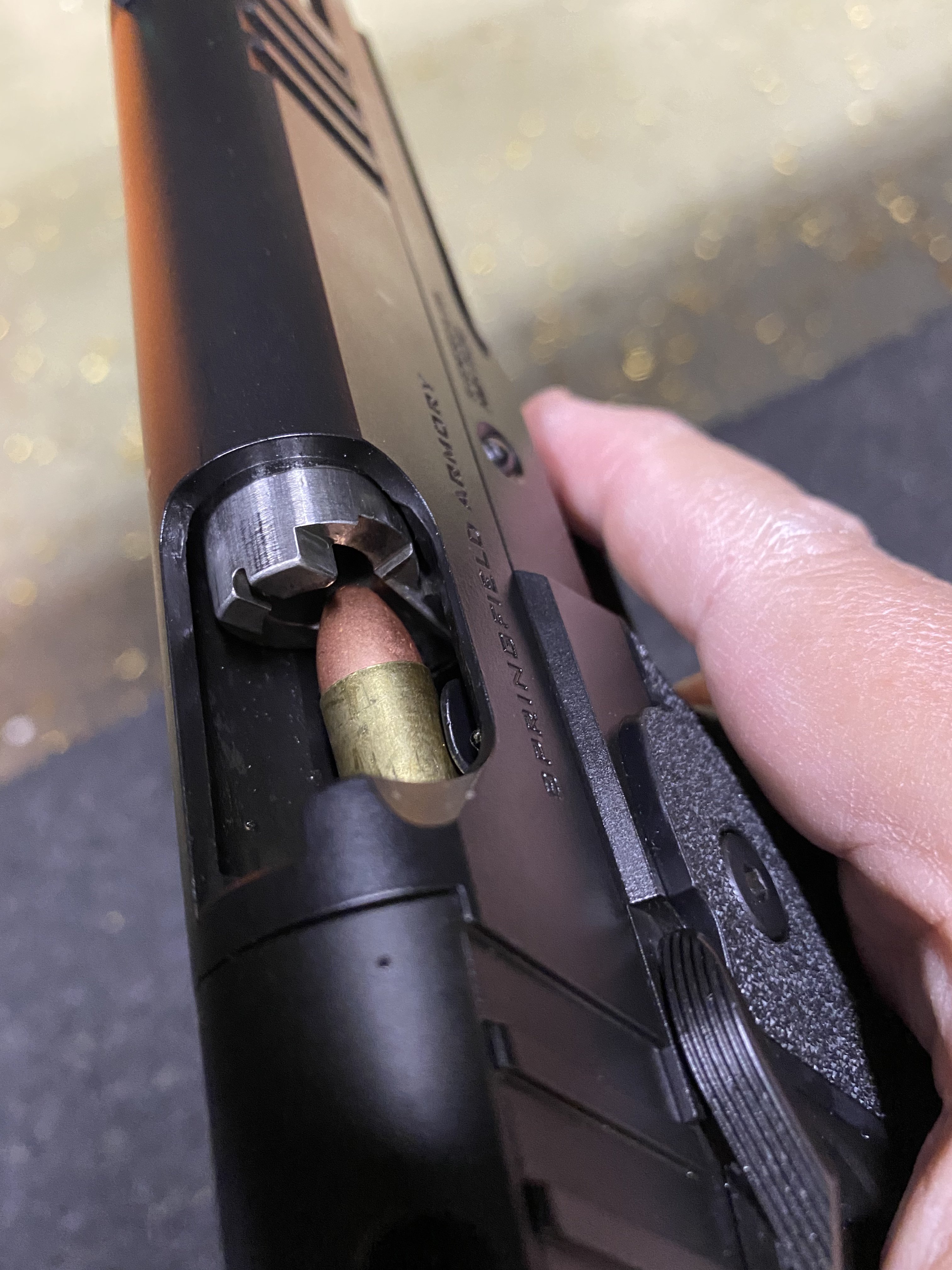

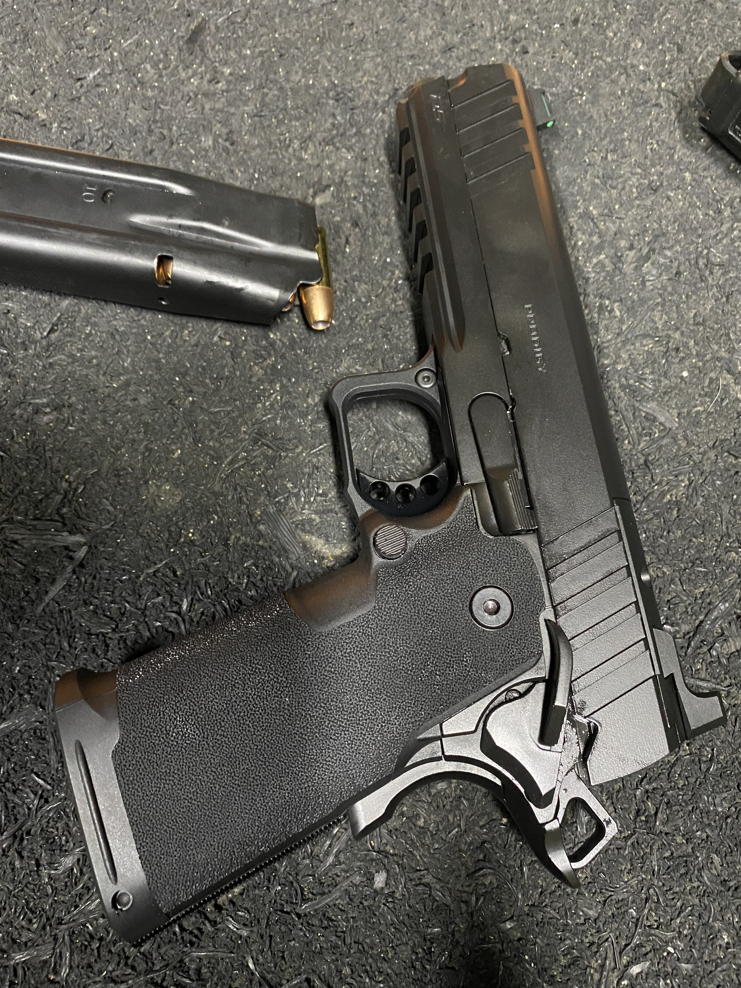

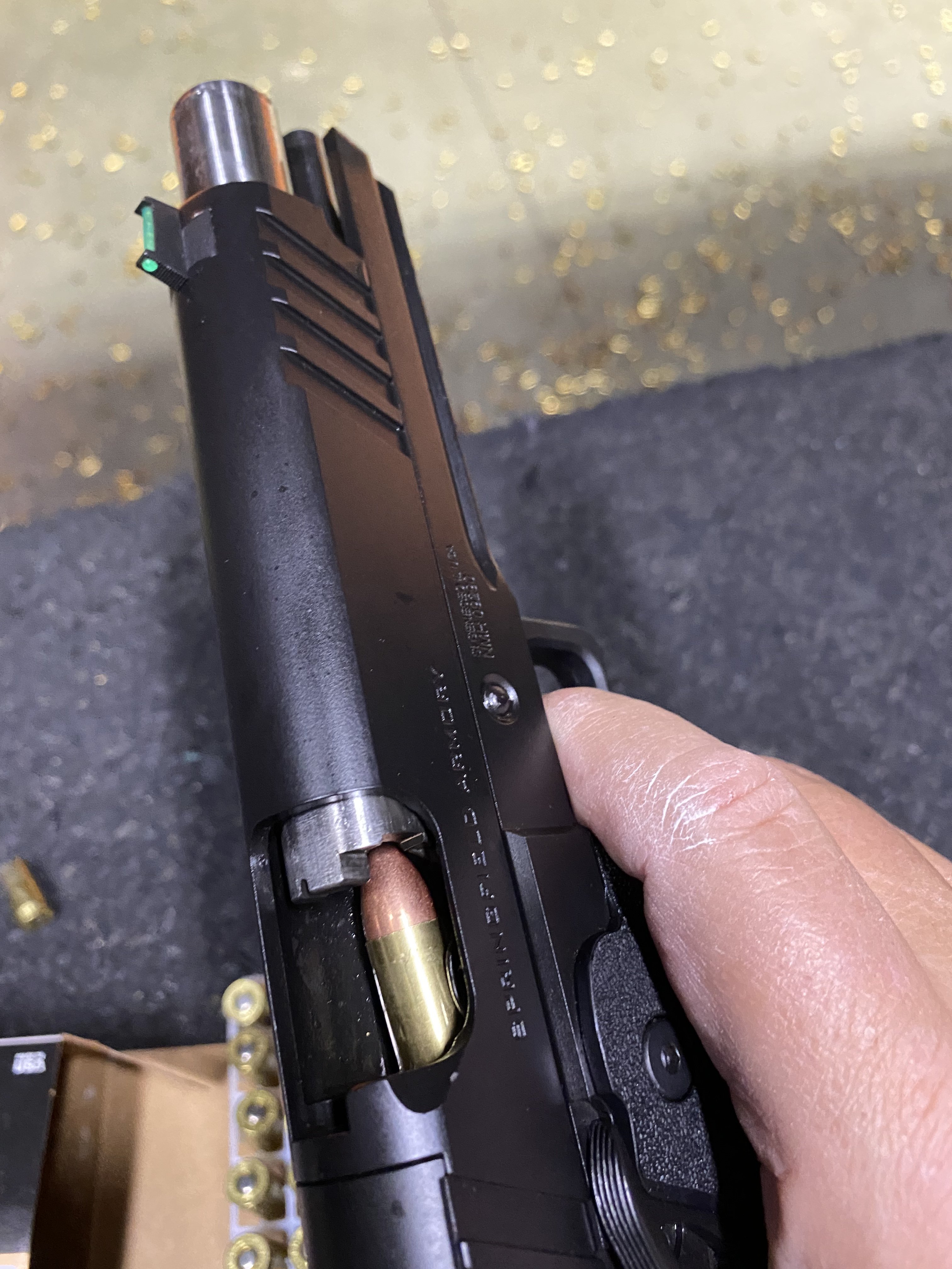

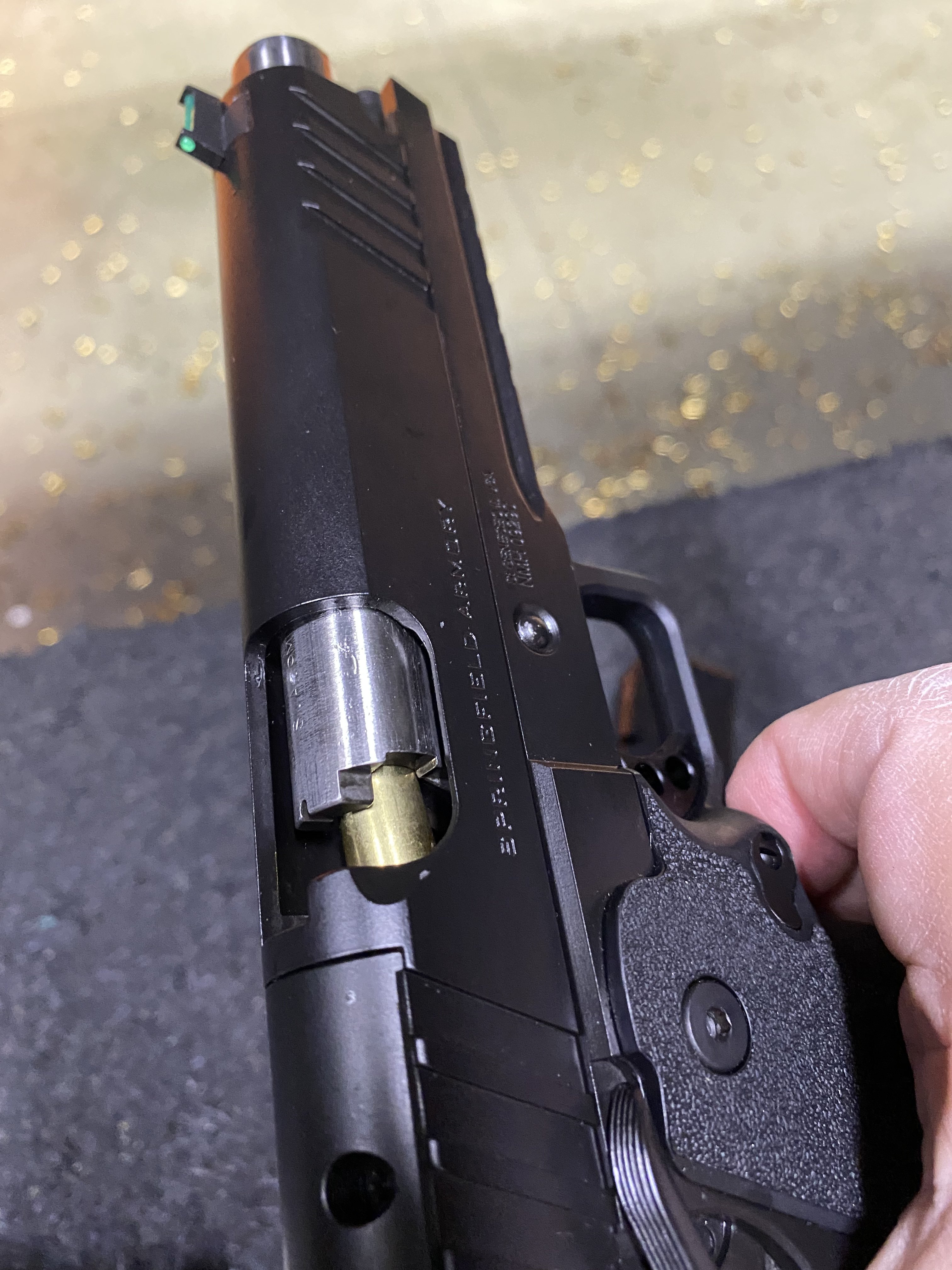

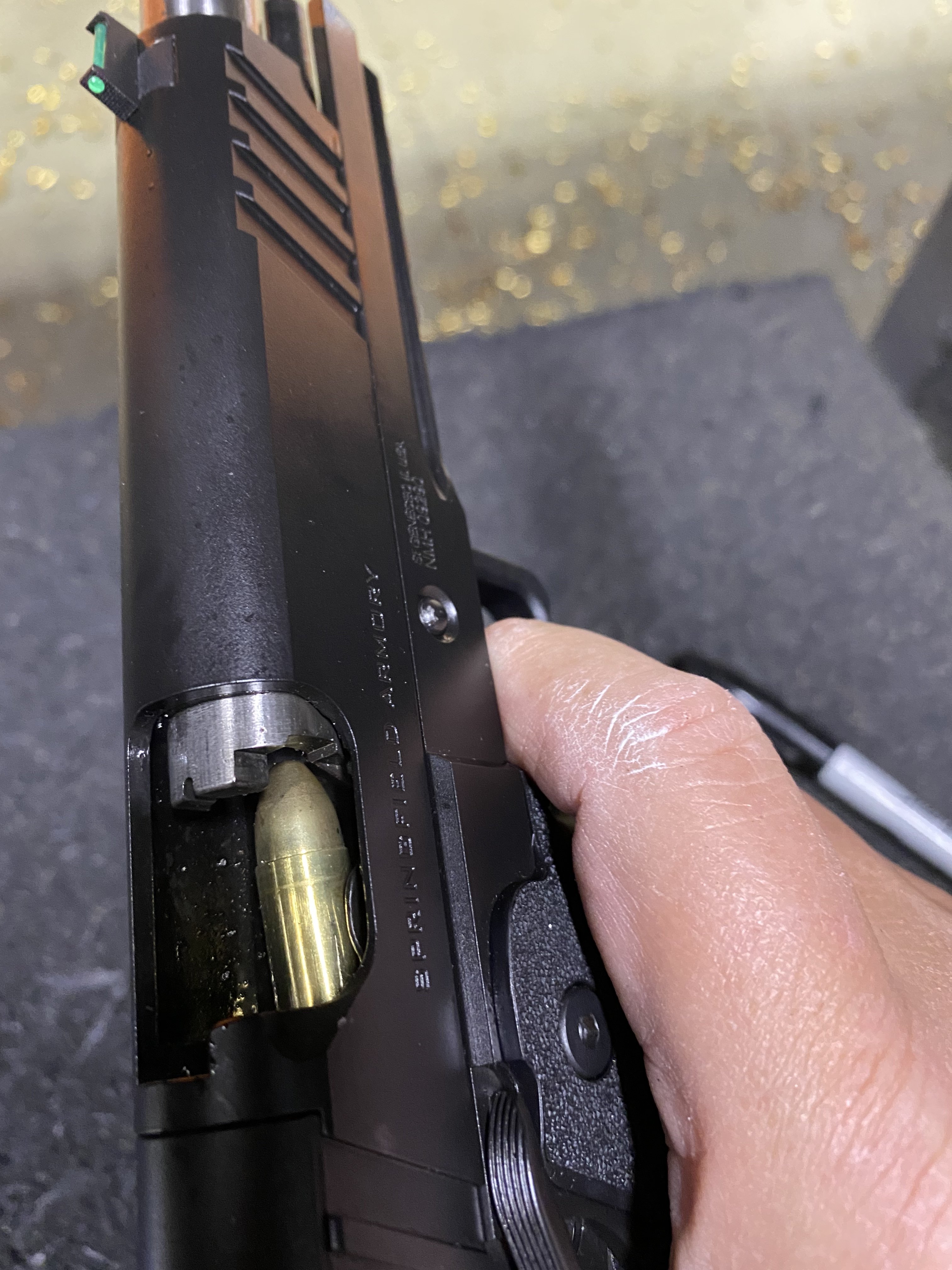

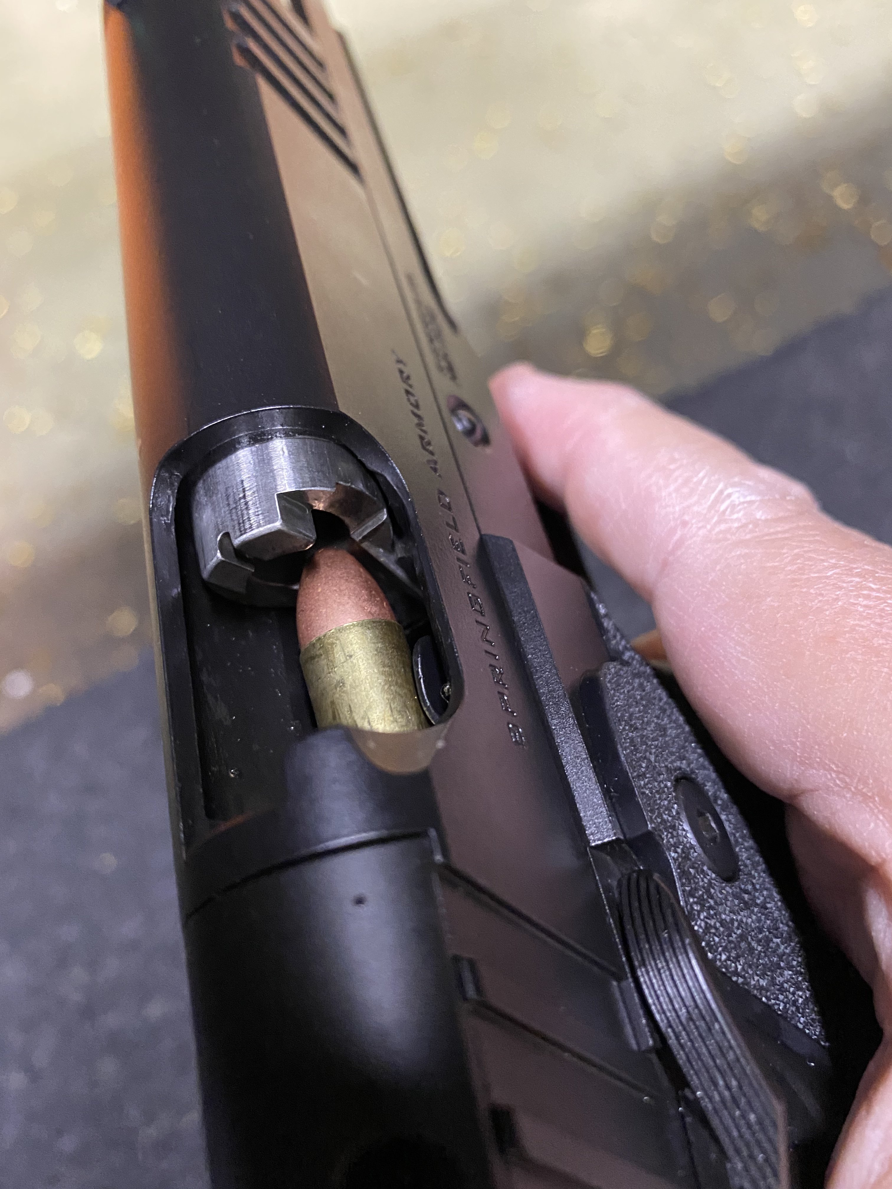

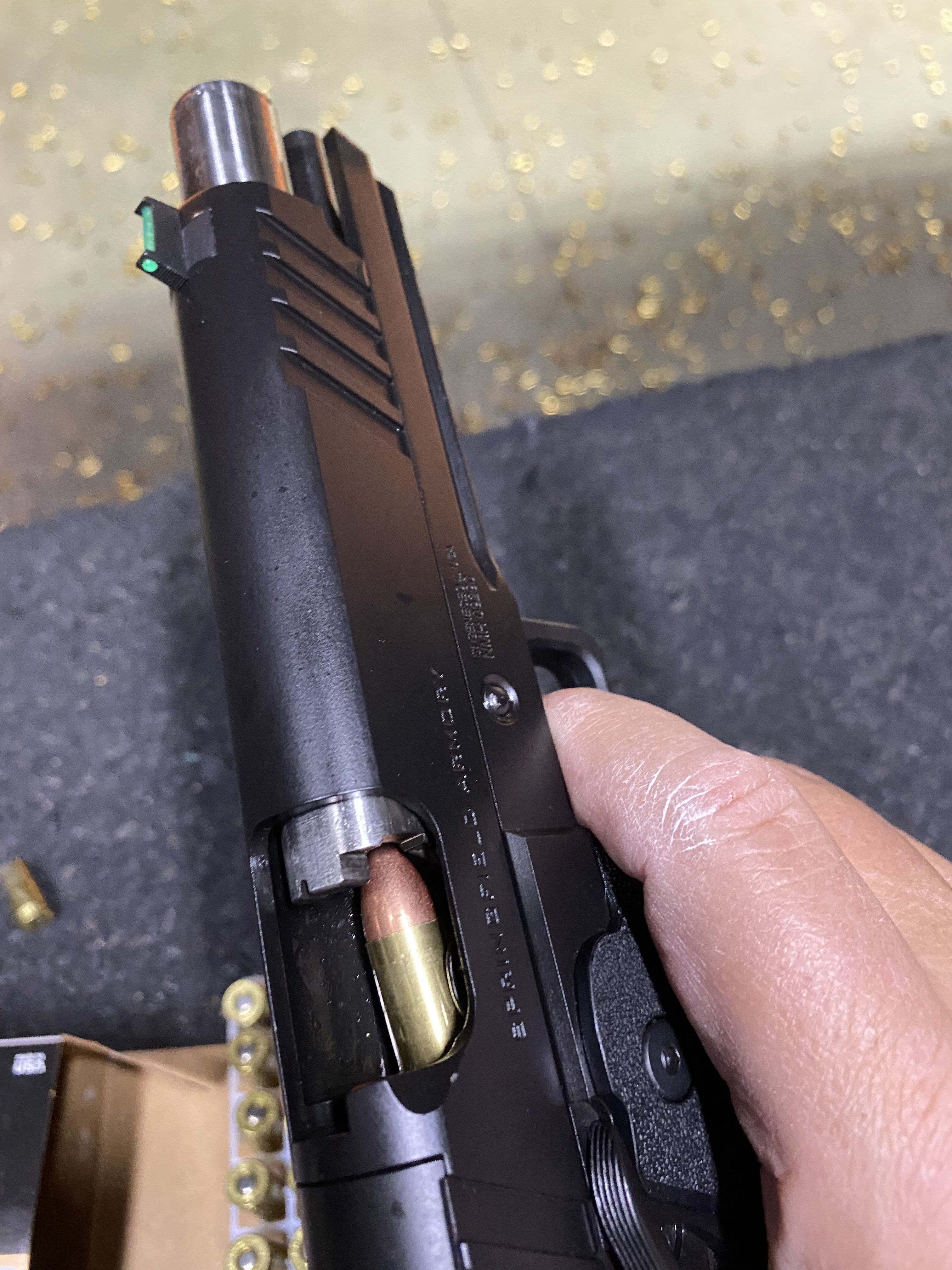

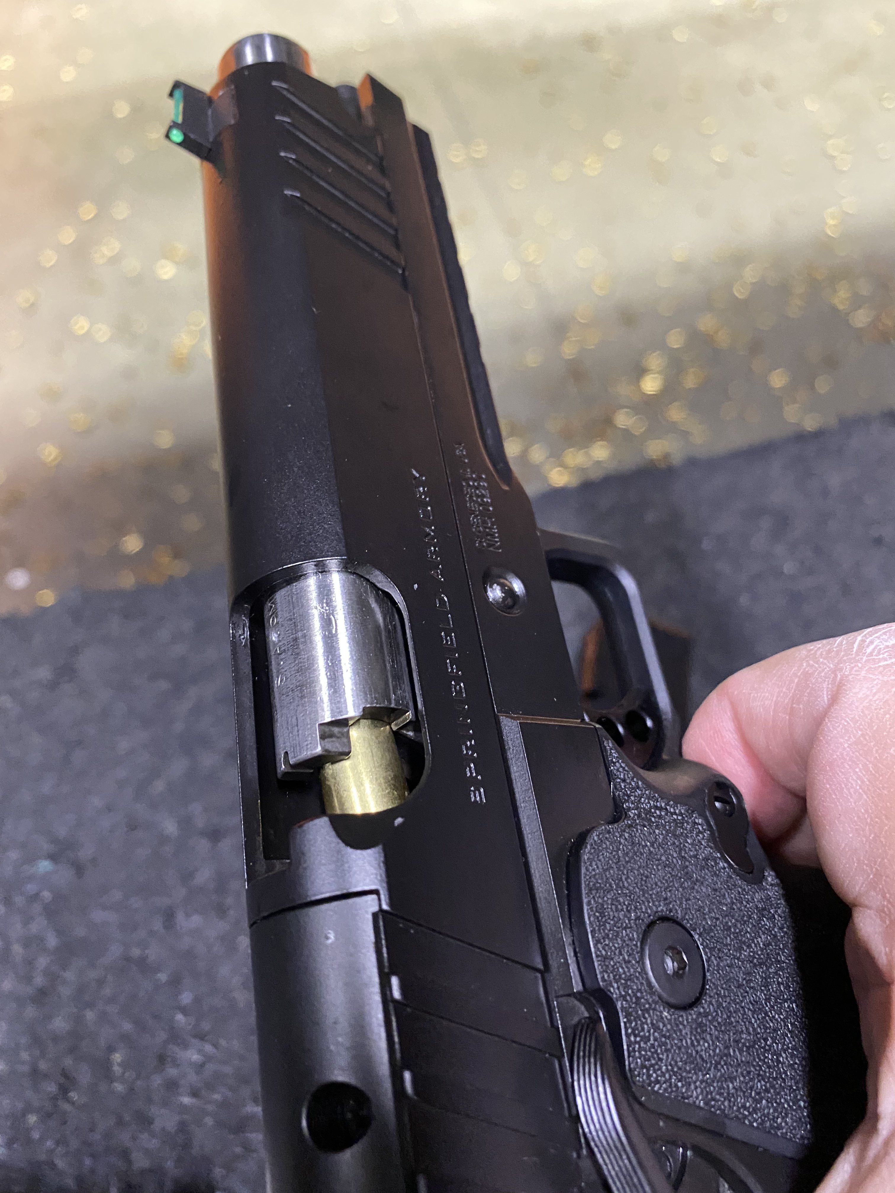

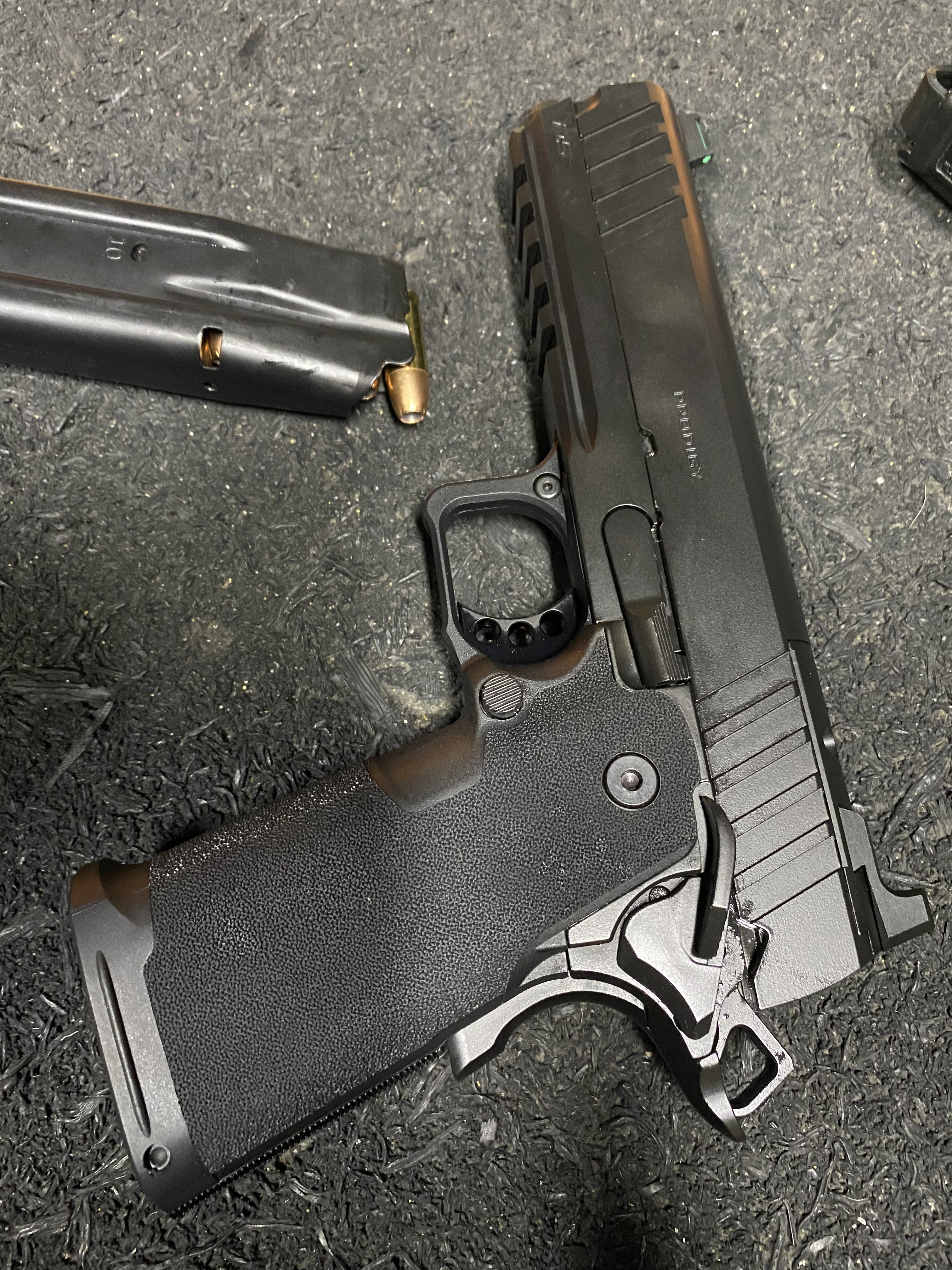

Well, well, well, as promised I took on the role of Prodigy beta tester and put 151 rounds through it today. “That’s very precise,” you say. More in a moment.
So, here is is: The Prodigy is exactly what we’ve been looking for - a 1911 that will hold 17+ rounds. It looks like a 1911, feels like a 1911 and shoots like a 1911. It’s nearly perfect.
“What would make it perfect?” You ask.
If it didn’t do this;
This:
This
This
Or This
I had four failures to feed - all from the 17 rd mag on rd 6 or rd 7, which is really weird and 1 rd that chambered but the gun jammed. The 20 rd mag ran fine. I did not illy load the mags until the last 50 rds and they both ran fine. I tried to run Sig 115gr V-Crown and the 1st and 3rd rds jammed so badly that I had to shotgun the Prodigy both times to get it I jammed. Rd 2, however hit bull. I went no further with the V-Crown. I ran 124 gr Blazer Brass and 115 gr MagTech for the other 150 rounds. I shot at 7, 10, 12 and 15 yds.
As you’ll see from my target the gun ran fine despite the assorted FTFs and for straight out of the box I would consider today’s foray a success. I found the iron sights a little difficult to get used to and they seemed to shoot a bit high for me, but I will sort that out once I get a red dot on it.
I completely lost the plot top left, but got it together top right. 2nd row, right is the last 50 rds at 10yds. That pretty much says it all, as does the the 7yd target at the very bottom.
As I said previously, some glitches, but straight out of the box I will take this all day long.

ThisView attachment 30441
Or This
I completely list the plot too left, but got it together top right. 2nd row, right is the last 50 rds at 10yds. That pretty much says it all, as does the the 7yd target at the very bottom.
Good shooting, have you thought to change the recoil spring from the factory 9 pound? Read somewhere, think it was here about the spring may be to light. My RO Operator had similar issues and Springfield said the factory spring was the 9 pound, I switched it to a 12 pound like my Kimber 9mm had and the issues went away, just a thought. Nice gun though
That will probably be my next move. I have a set of Wolff springs. I’ll give it a try.
Nice. I had a similar incident like you are showing on your 5th picture where the gun looks like it almost went into battery. I noticed a gun of mine did that when I installed an after market barrel. I had to hone the chamber some, until then it was very ammo sensitive. Maybe the chamber is tight? I'll see if I can measure mine.
That was with the Sig V Crown hollow points. I’ve got some Underwood and some Speer Gold Dot hollow points that I’ll try next. I think it’s the tightness of the gun. I’m hoping more rounds down range will sort it out as it wears in.
