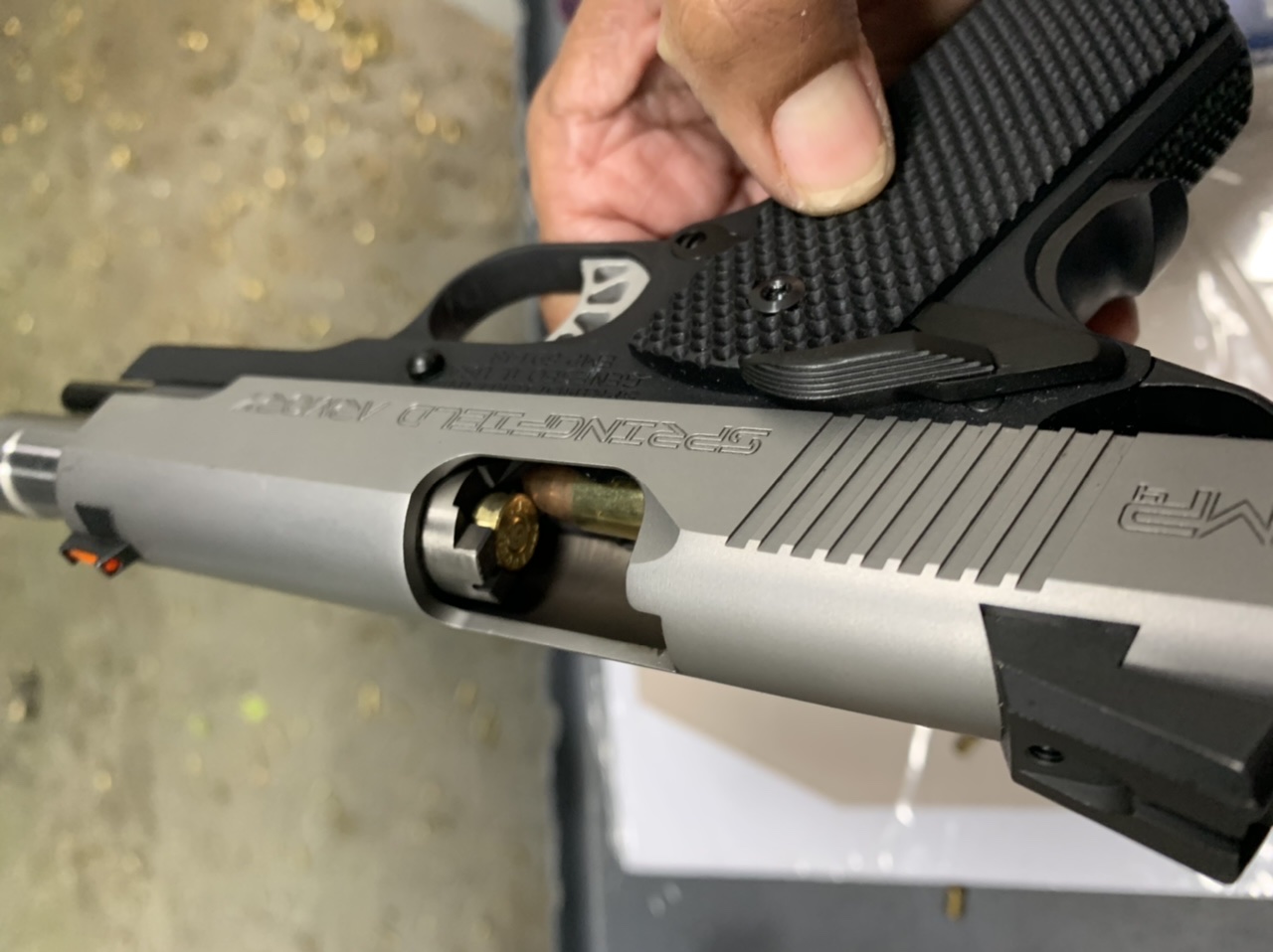

I recently purchased a EMP CC Contour and have been experiencing a problem. I’ve run several hundred rounds of various brands of 9mm and have experience at least one or more “failures to extract”. It’s starting to cause me to doubt the reliability of the piece...additionally the extractor leaves a definite indent on the rim of the case. None of my other 9s leave a mark on the case...thinking about returning it to Springfield for warranty work..I understand that some firearms require a break-in period but after at least 400-500 rds of various brands it should be “broken-in”...

I plan on giving it a good cleaning and run a box of different brands, record results, before I contact Springfield CS...attached an example of ejection failure
