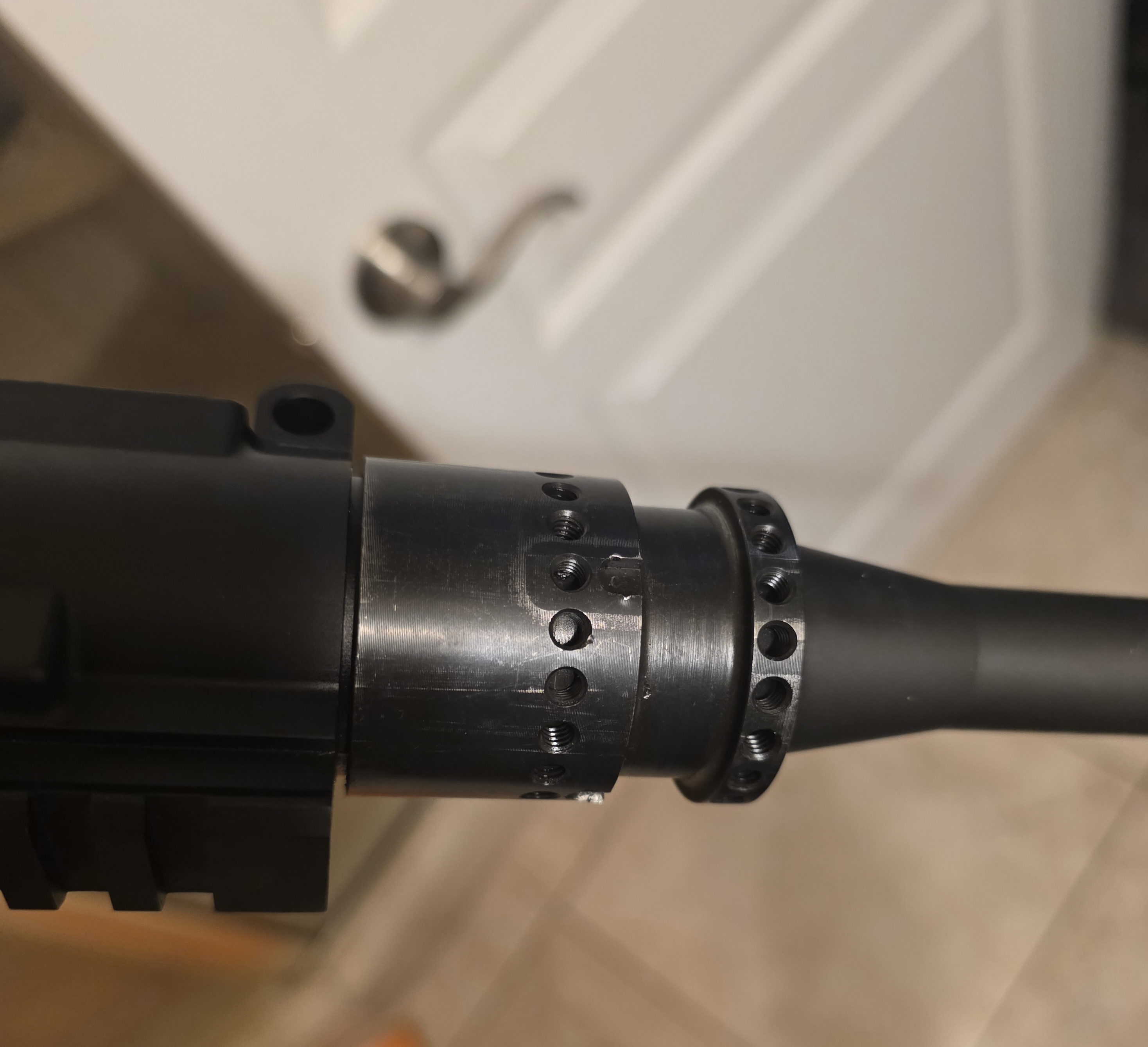

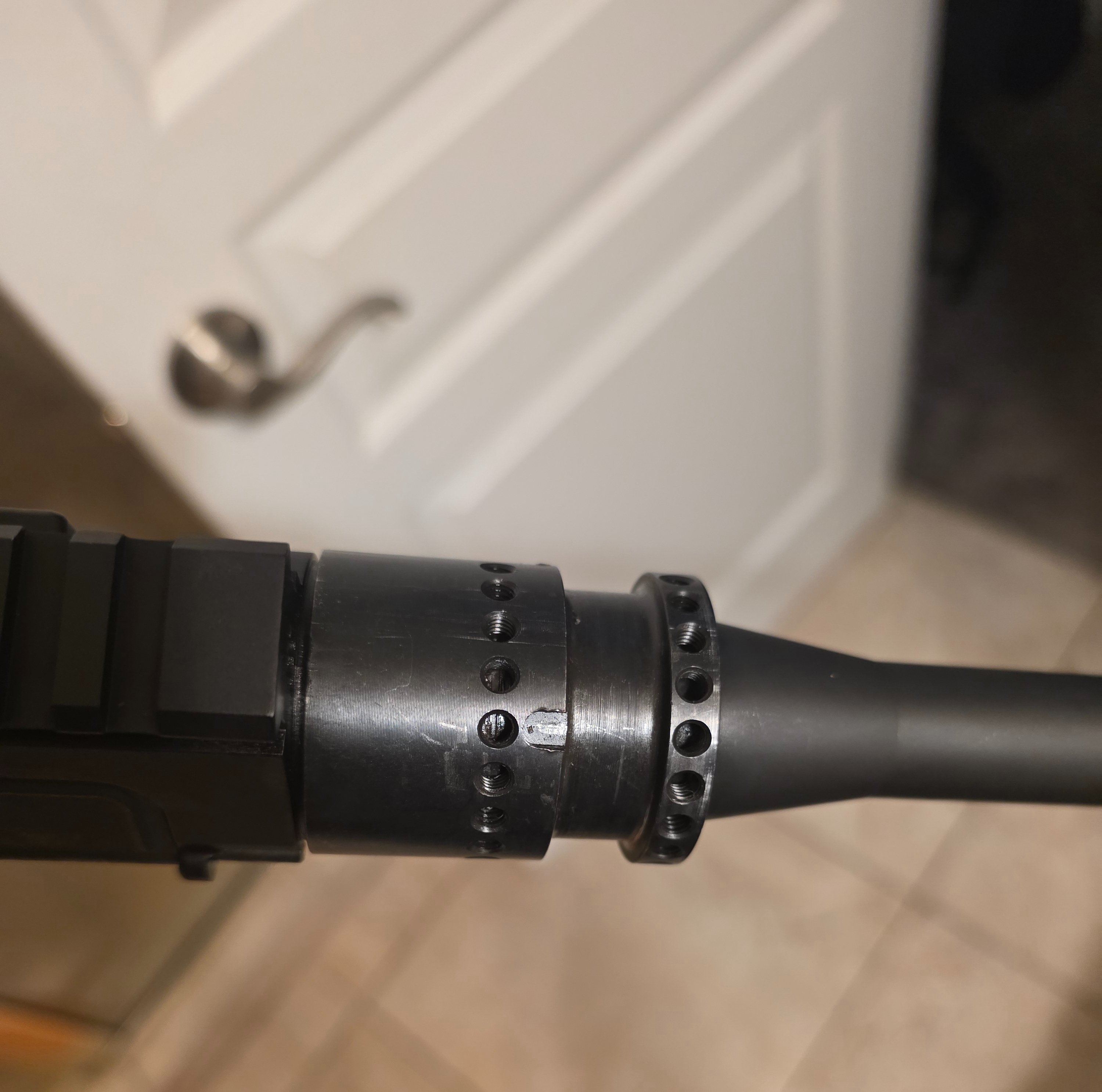

This is the barrel nut on mine

Looks to me like a good pipe wrench would rip thar off, re-tap those threads an rip away with some bolts screwed in, really, it went on there it will come off!

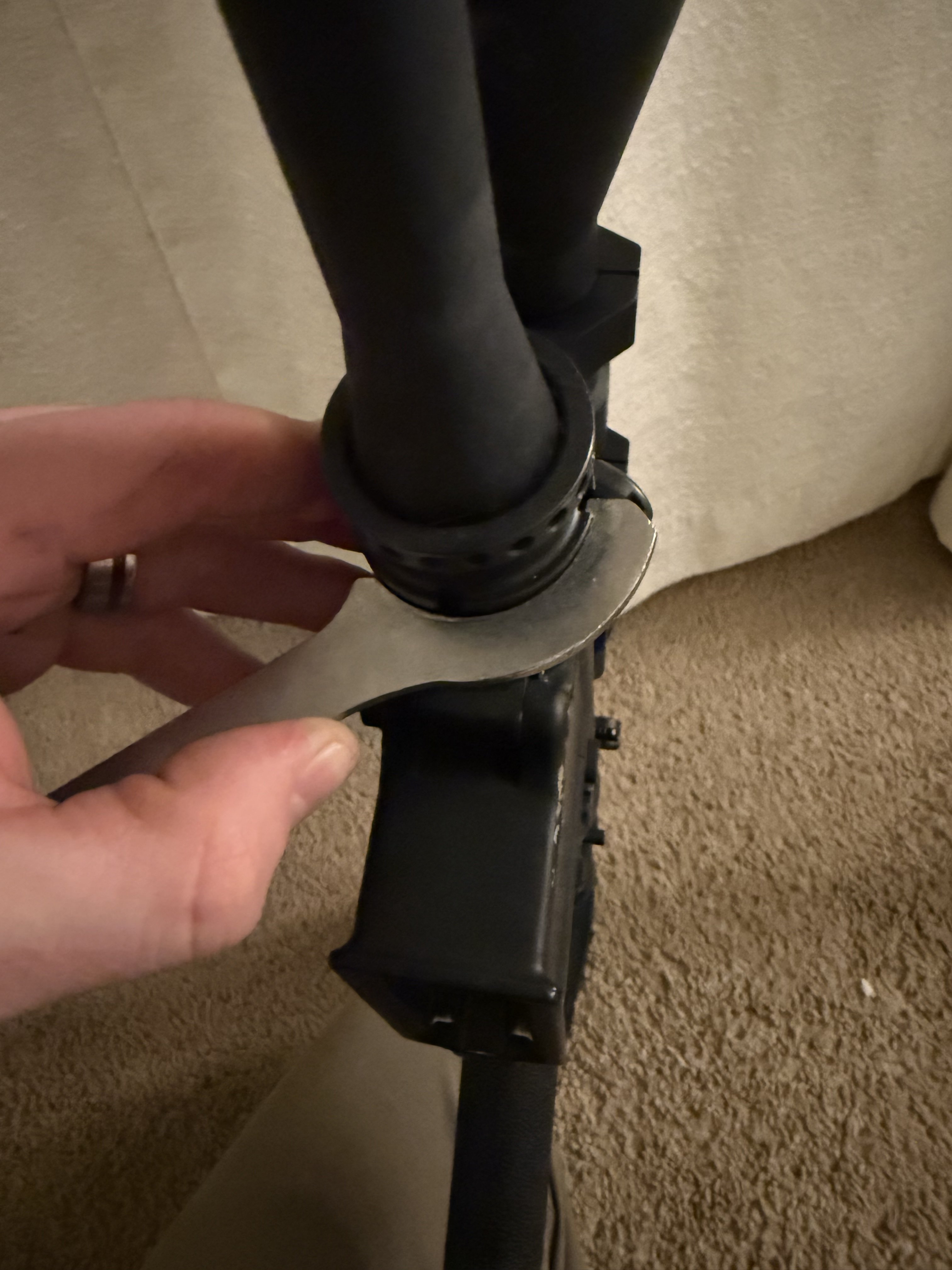

Found this thread and wanted to add this info to possibly save some folks some money:

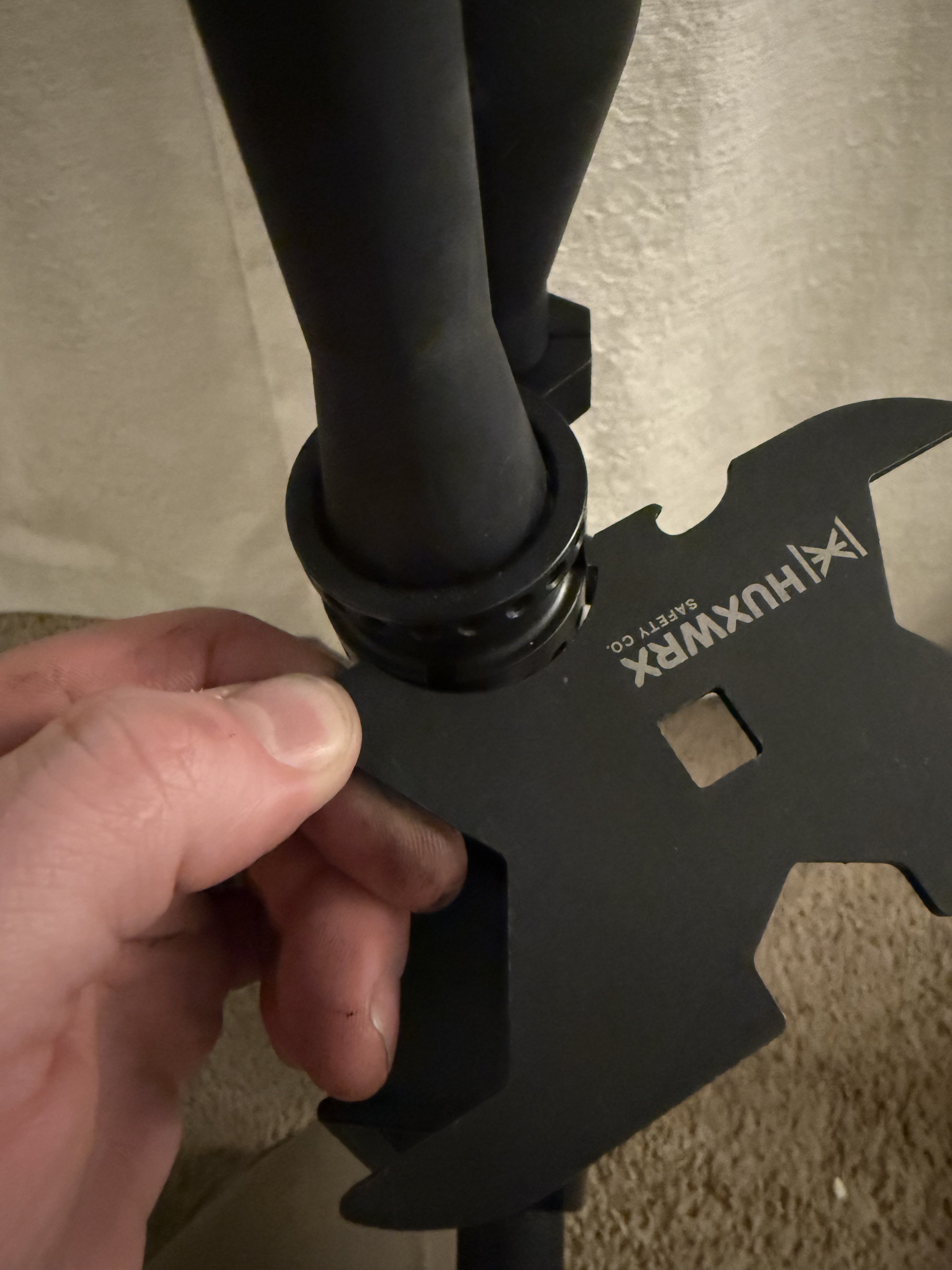

SilencerCo spanner fits perfect. Huxworx almost; I think filing down the nub on it to fit in the slot on the barrel nut would work. That will allow a 3/8” drive ratchet or torque wrench to be used. May be some time before I get the chance to try myself, but I plan to update here when done. Cheers
View attachment 101356View attachment 101357
Yes please keep us posted! Interested in hearing how that works out.
I'm just seeing this, I would love to have one of them if you have extras for sure
I don’t have any spanners to spare but the SilencerCo one is $12 and the Huxwrx is $26 FWIW
I’m waiting for an AR10 upper vise block to come in and then I’ll give it a whirl and let you guys know
Swapped my barrel this evening. The slightly filed down (described above) Huxwrx tool worked perfect! I would not recommend the SilencerCo tools as you cannot get a wrench/torque wrench/breaker bar on those properly.

Anyway the bottom line is a Huxwrx Ventum tool with 5 minutes of filing is absolutely the right tool for the job and it still works on the silencer itself too. If I had to do it over again and had no tools, I would sooner order the Hux tool than spend double on the BCM one. I’m sure the BCM works better, but the Hux worked well enough that it really had that “right tool for the job” feel.
