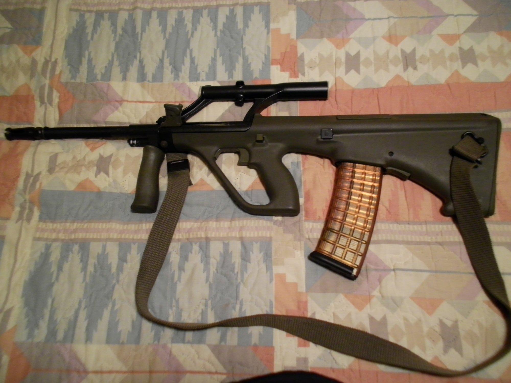

I have the old school Aug bought many years ago. several things on it i hope they improved on. number one is the sight. old ones have a built in scope which i guess works but by modern day optics it sucks. only iron sight is a groove cut in the top of the scope which is a joke.
second is the trigger pull is pretty bad all the internals and trigger mechanism is plastic. The safety button is is hard to push and very noisy.
