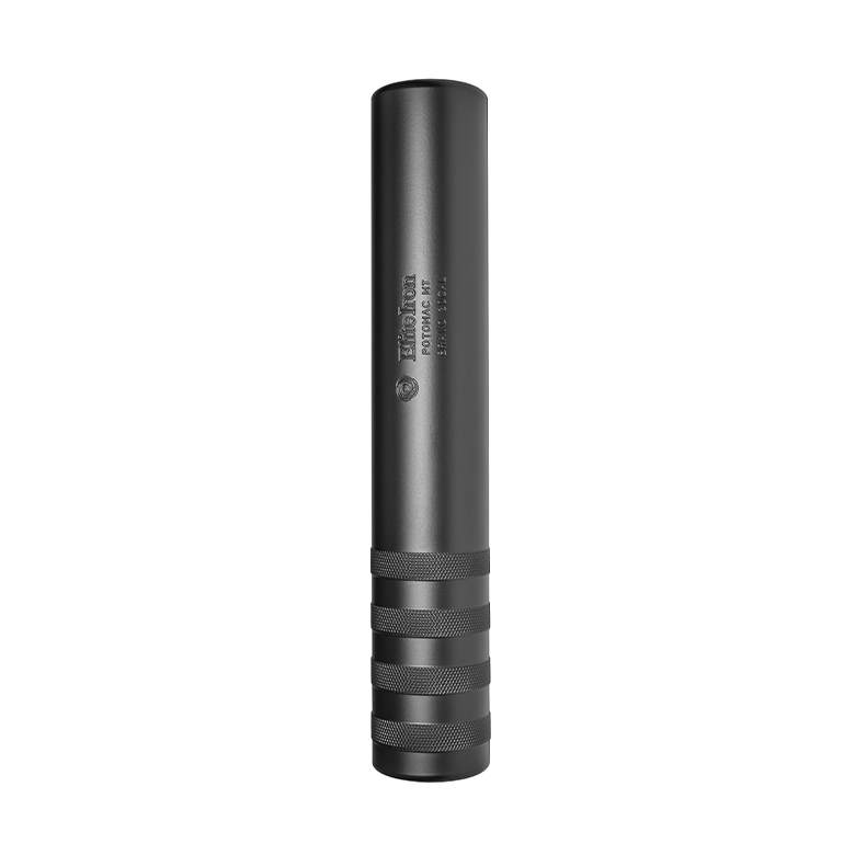

The can itself should be for the caliber, otherwise performance will suffer. Running subs, the M1A is more quiet than a 22lr, this is with an Elite Iron Bravo.

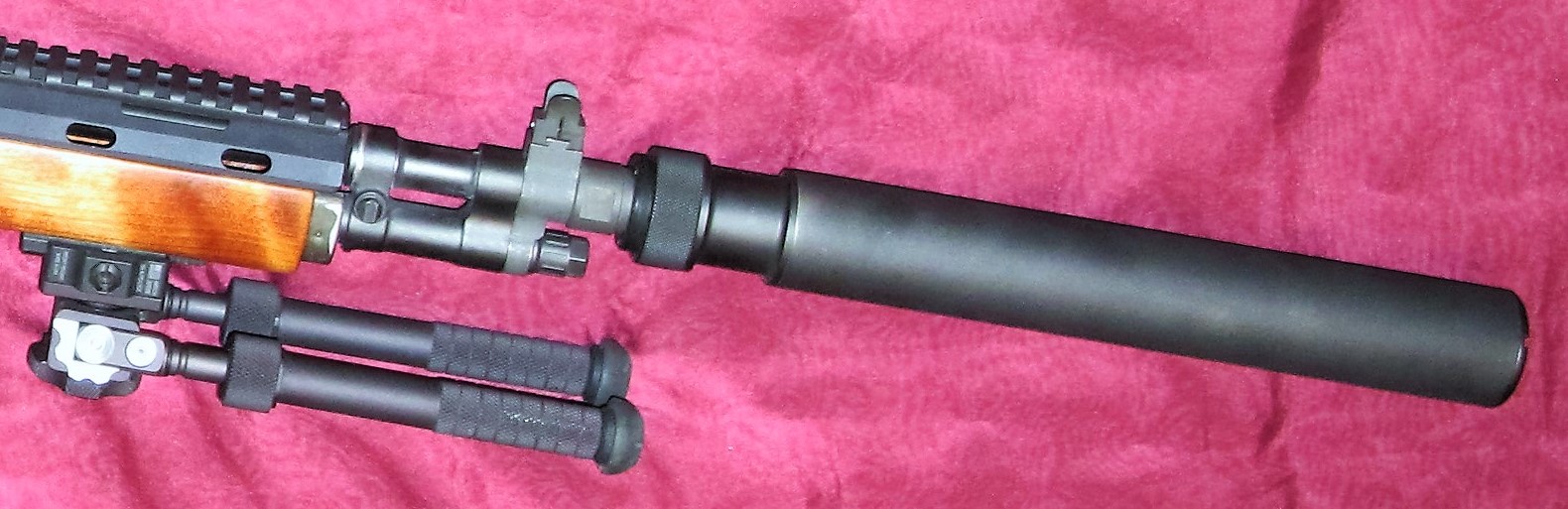

The gas system is self adjusting, but an extra volume gas plug is nice. If you go with Smith Enterprise kit for the 22" & 18" barrels you will need a DC Vortex made to accept their Wind Talker suppressor. You will also need a gas lock front sight base made for the barrel length you are running. I recommend using an M3 Breech shield to deflect blow back.
It's easier to suppress the M14 type than you think.
The gas system is self adjusting, but an extra volume gas plug is nice. If you go with Smith Enterprise kit for the 22" & 18" barrels you will need a DC Vortex made to accept their Wind Talker suppressor. You will also need a gas lock front sight base made for the barrel length you are running. I recommend using an M3 Breech shield to deflect blow back.View attachment 21972
In case anyone is curious the breech shield can be found at:
https://www.keepshooting.com/m14-blank-fire-attachment-kit.html

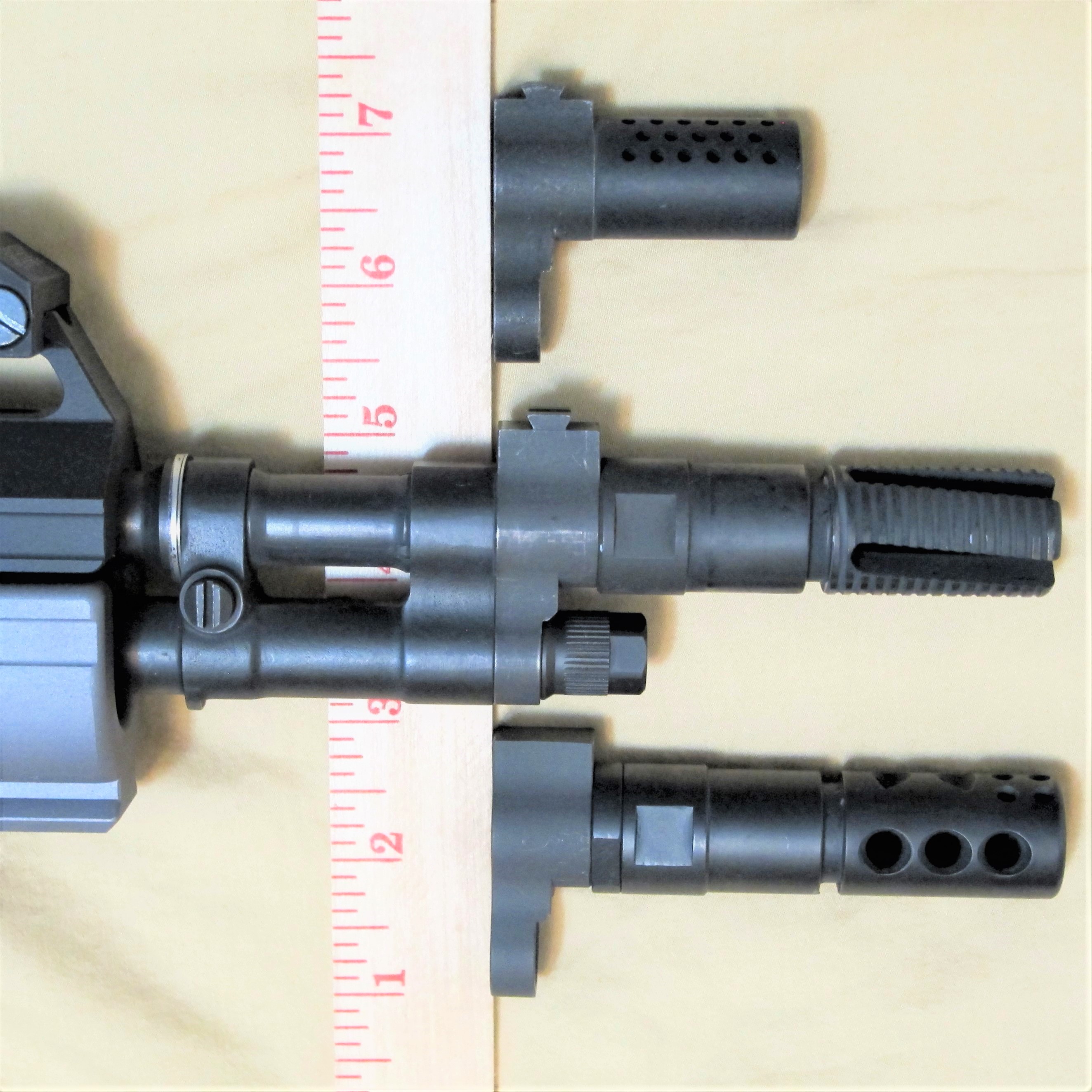

The 16.25" can be suppressed, but you have to replace the factory combination gas lock front sight base muzzle device with a new gas lock front sight base from SEI plus the muzzle device that works with your suppressor. I use a Smith Enterprise suppressor and their muzzle devices, but you can use what you like. You will want to use SEI stubby gas plug to avoid any potential clearance issues.
