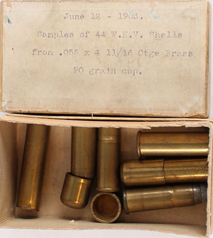

Cartridge Examples

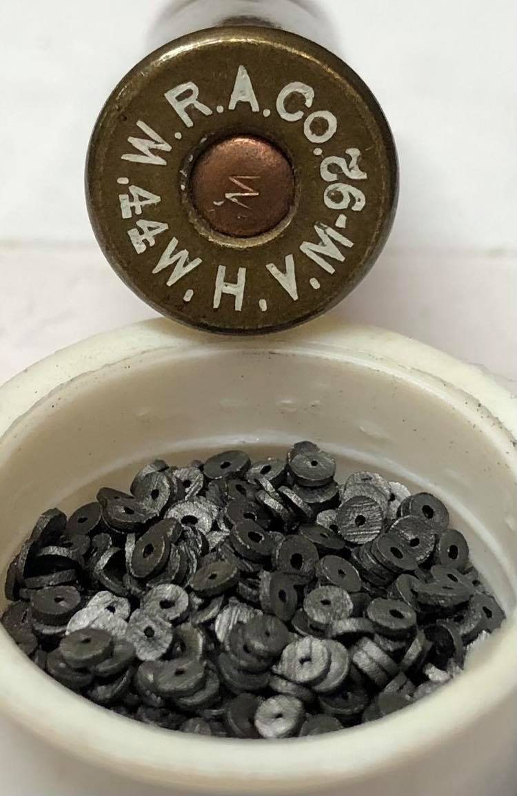

During my years search, I have acquired several H.V. examples. Although the powder charges vary, the same "Sharpshooter" powder was used from 1903 till the end, 1938... 35 YEARS!!!!!! (DO NOT CONFUSE SHARPSHOOTER WITH TRAIL BOSS, TWO COMPLETELY DIFFERENT POWDERS)
The first example would be a "Draw Set" I acquired dated 1903. This cartridge contained 20.8gr of Sharpshooter smokeless powder.

With the few examples I have, the powder charges slowly decreased over the years and by late (1929 to 1941), the powder charge has been documented as low as 13.9gr. (see above link)
