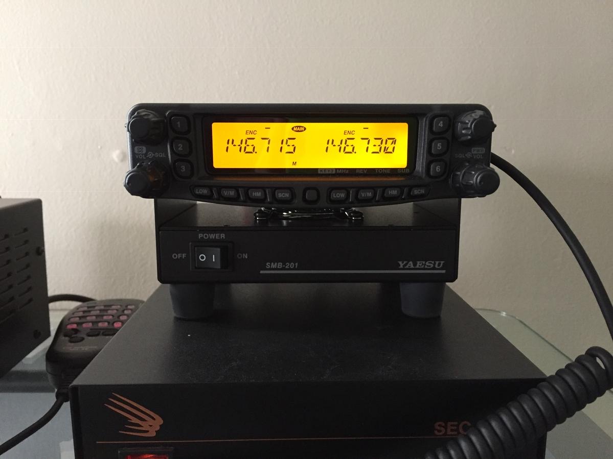

Saw those, I just need an indoor 2-meter antenna, where we live I can’t have any outside or anything hanging out window. With my handheld I am limited to just one repeater and nobody talks on it, dead air 90% of the time

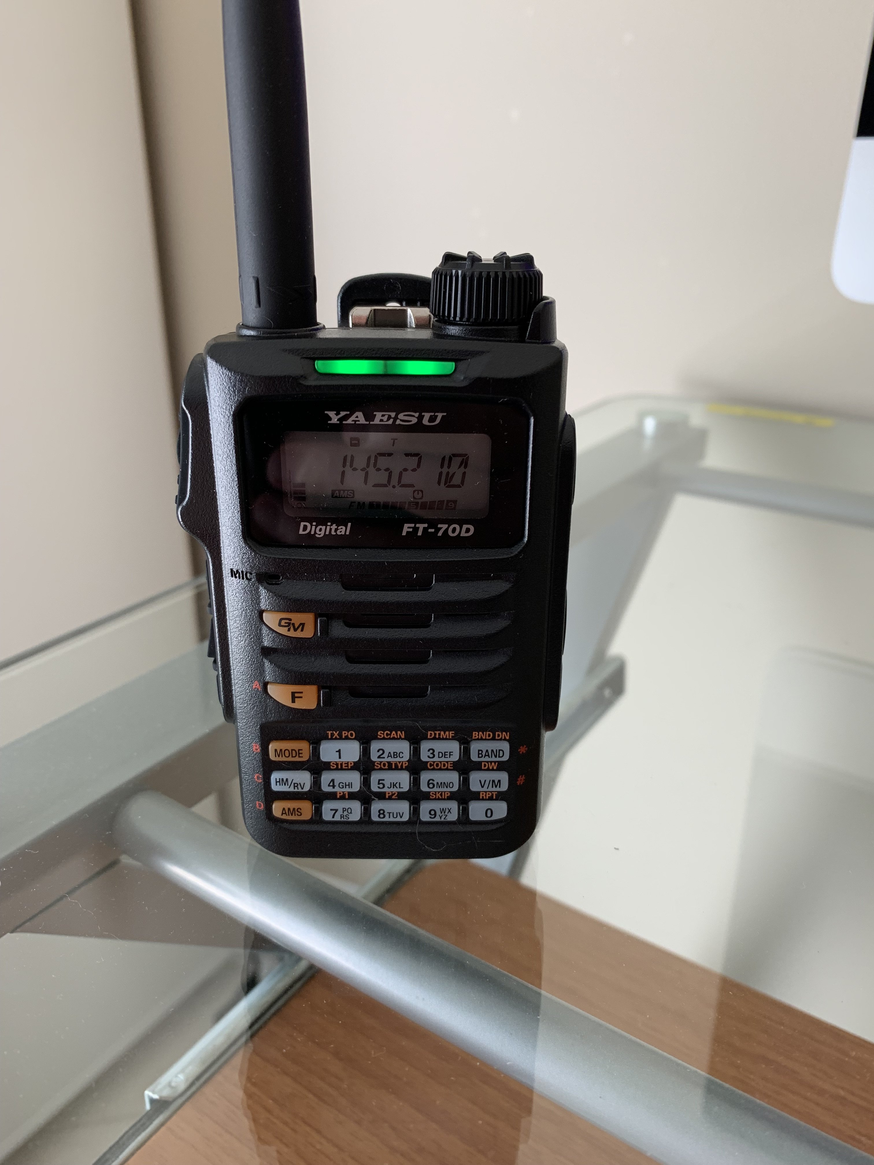

A 15" antenna for your handheld might get you enough gain to possibly hit some other nearby repeaters. I replaced the small factory dummy load rubber ducky on mine and it reaches out to about 7 miles from inside the house. Here's a link to the one I'm using and they make a 8" to 52" telescoping 2 meter RH205 for the hand held (BNC connection) as well: https://www.diamondantenna.net/rh77ca.html

Cool, thanks, I can hit the one repeater, but it’s only 3 miles from me, only one I got that’s local, that’s why I want to set up my mobile with a indoor antenna of some kind.
