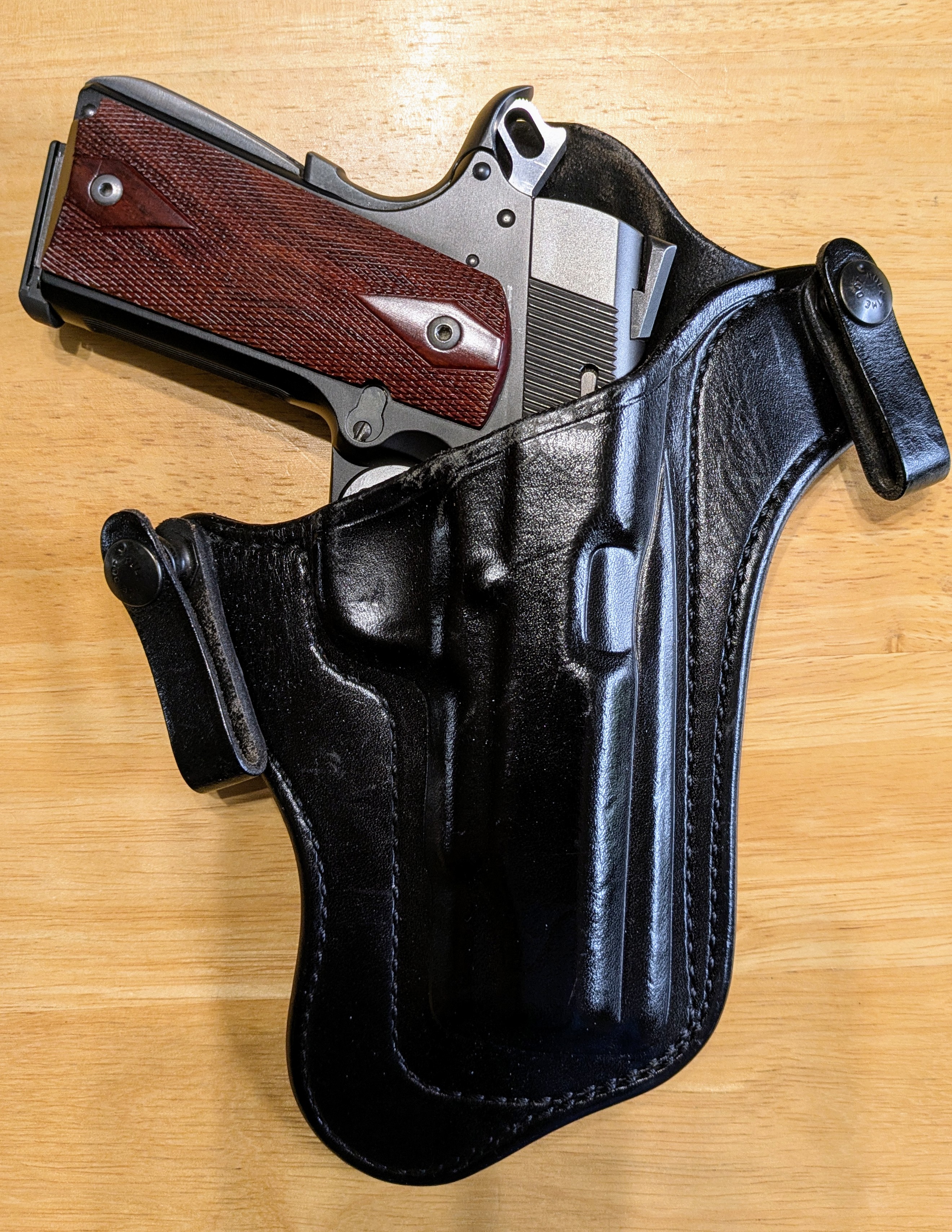

My lightweight Smith and Wesson version has an Ed Brown barrel and bushing fitted by Bill Laughridge. While he was in there he replaced the MIM parts and slicked up the trigger and put on a proper arched mainspring housing. I wish it had a checkered front strap and no cocking serrations, but this is really close to the correct answer for concealed carry. In a Brommeland or Milt Sparks inside the waistband holster of course.

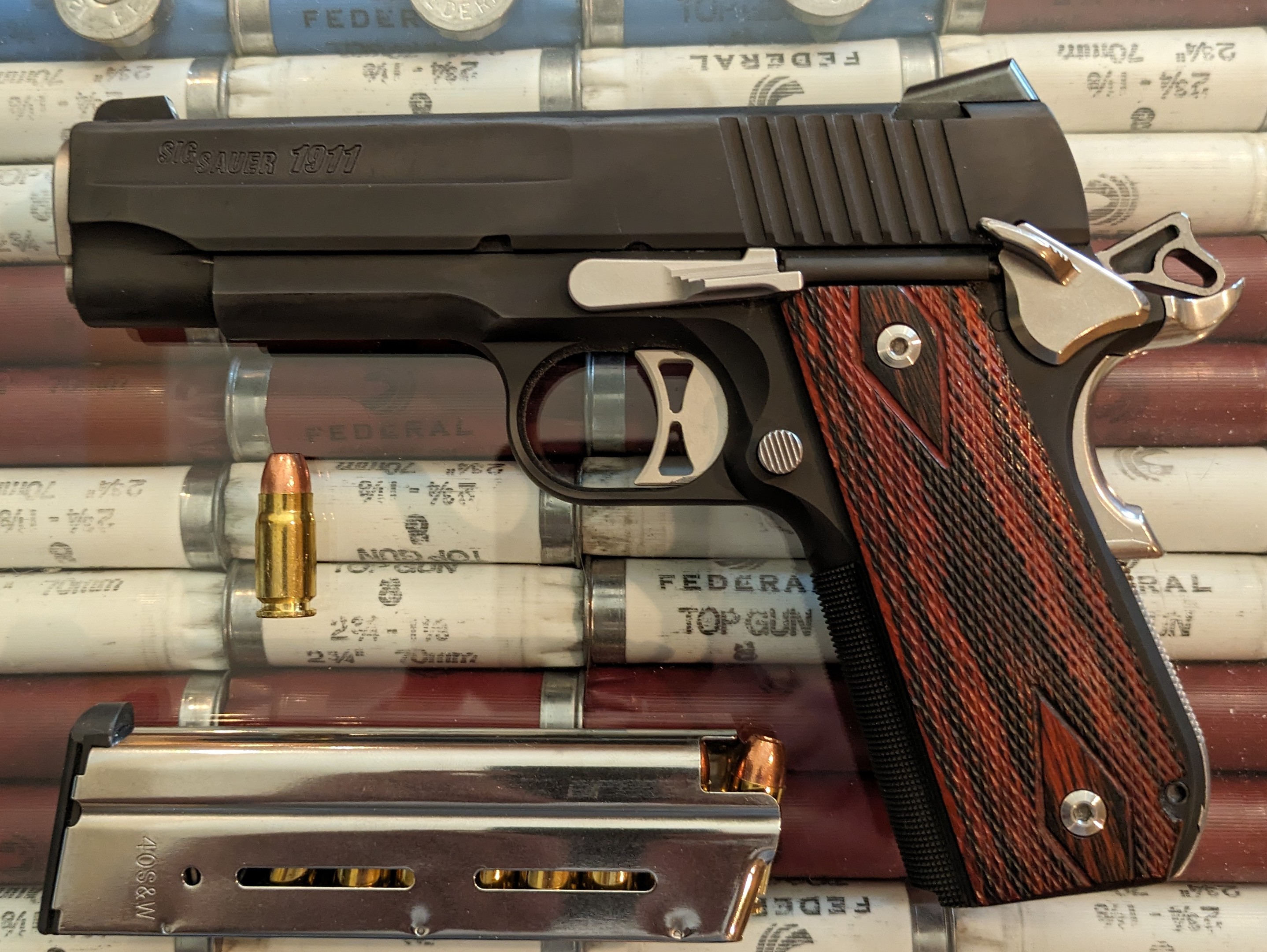

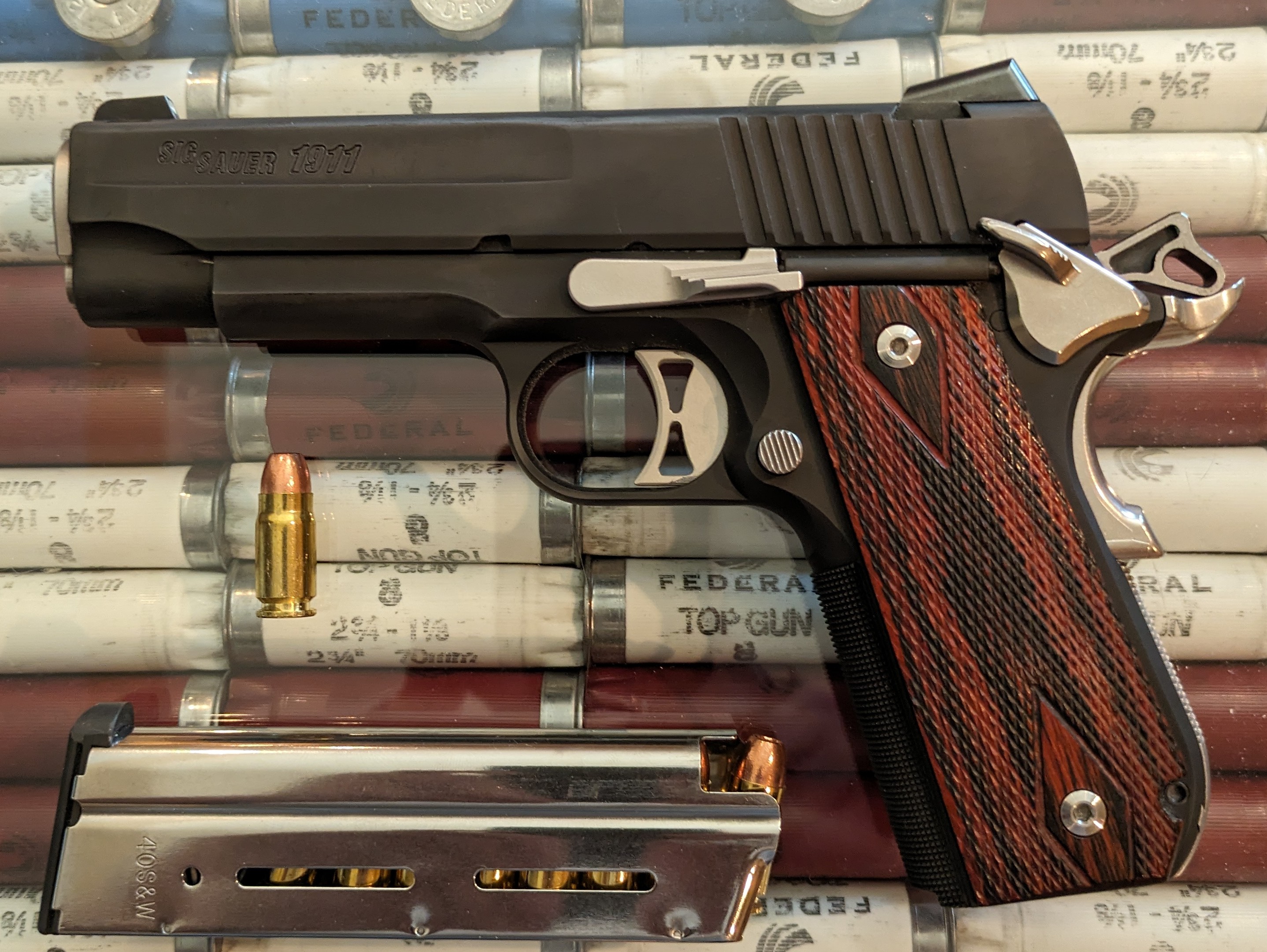

I am also fond of my Sig "Commander" but I wish it had the fine cut cocking serrations (those wide ones look like a cheap imported copy of a 1911 to me). And all one color, or a proper two tone hard chrome lower and blued upper. But I do like the Bobtail and the chambering. This is a .357 Sig model. Flat shooting, designed to duplicate the 125 grain .357 Magnum load that got such a fearsome reputation as a stopper back when the good guys all carried revolvers. And being a bottle neck it is very reliable...almost HAS to feed because of the shape; a .355 projectile going into a 40 caliber sized chamber. I really like this cartridge.

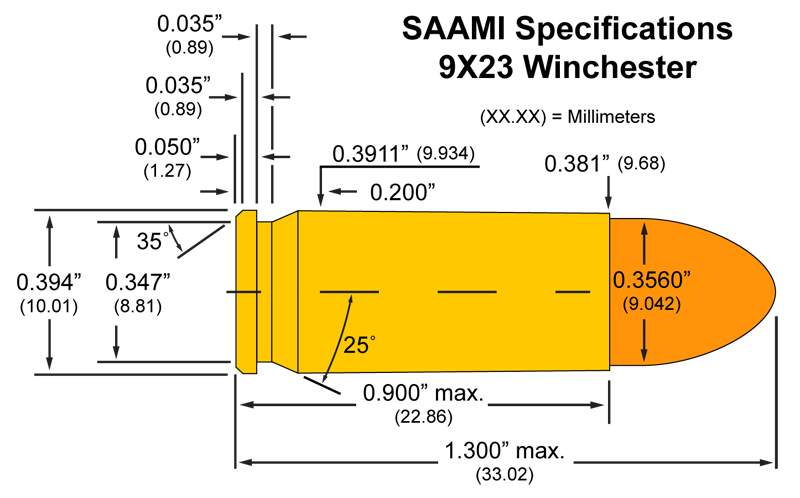

I mentioned above that the 9x23 Winchester will run in a 38 Super. So, 1 9mm barrel + 1 38 Super barrel that will run both .38 Super & 9x23 Win. = 3 calibers with recoil spring & barrel swaps.
I converted a full-sized RIA 9mm to 38 Super with no breech-face & functional issues. The rim diameter difference is minuscule.

The 9x23 Winchester had a short commercial life due to a patent infringement lawsuit between John Ricco & Winchester, which snow-balled on for several years and taking the wind out of the fine cartridge. Winchester does make a run of it every time Hailey's Comet passes, and Buffalo Bore offers three loads.

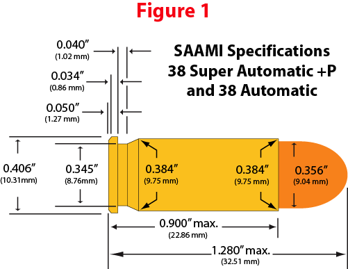

BTW - the 9mm Luger rim diameter is 0.392 inches whereas the .38 Super is 0.406 in. so the difference is 0.014 and a 9mm 1911 breech-face isn't that tight.
and the 9x23 Winchester has a slight taper that fits in just fine in a .38 Super chamber.
More...
Just a safety note. "Winchester-made" 9x23 brass is very strong & "I" only use 9x23 Winchester ammo/brass in an "unsupported" 38 Super barrel since the "Winchester 9x23 brass" can handle it, and I've had no issues.
However, 9x23 (and associated "Comp" type) Starline brass isn't as strong so it would be wise to fit a "supported barrel" if you want to use "non-Winchester" brass in a 1911.
That being said if I did do a conversion it would be best to fit a 9x23 barrel since that would cover any ammo/brass type useage for either cartridge.

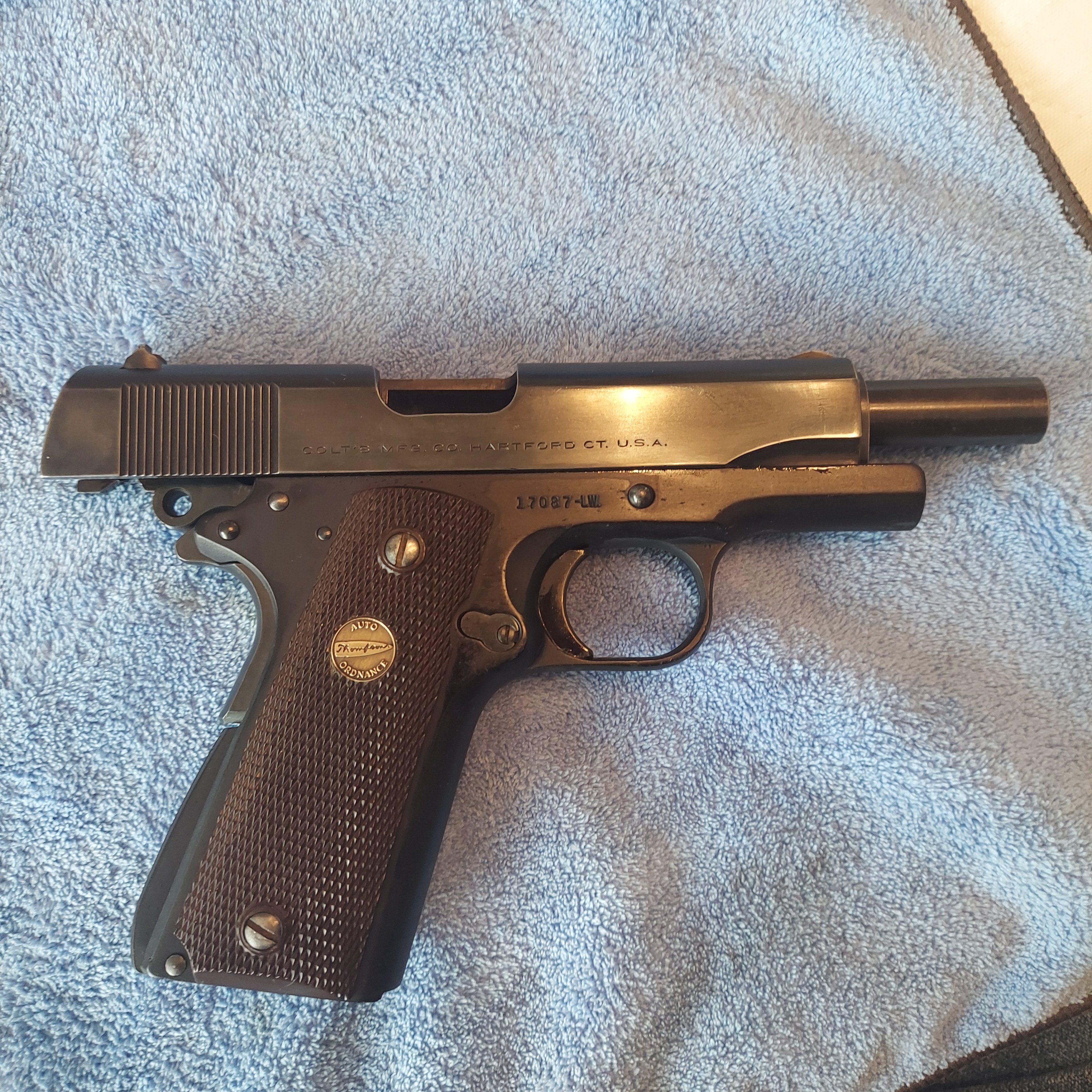

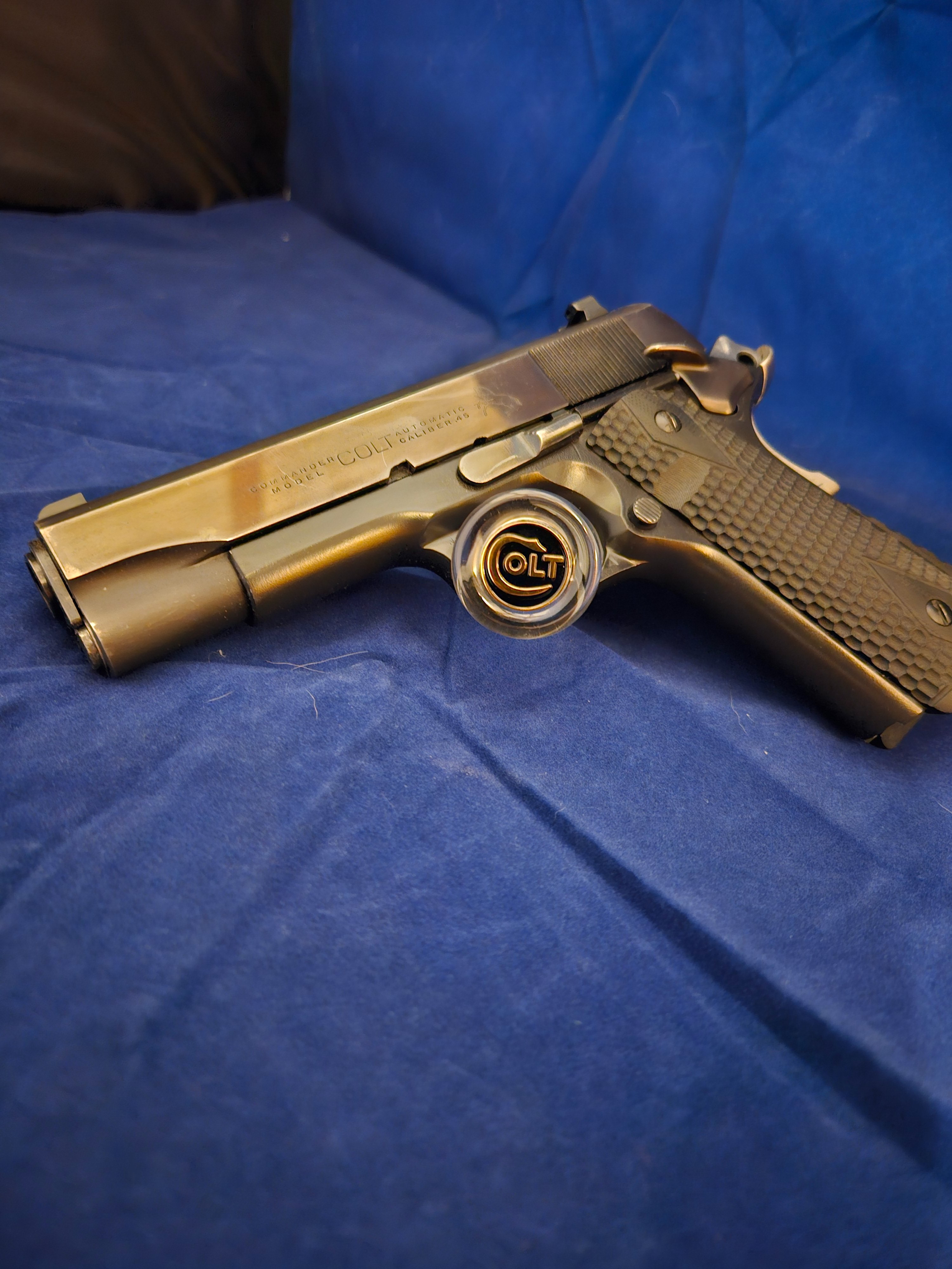

Here is a 1950 make I picked up for $200. No provenance nor paperwork so I refinished it.
