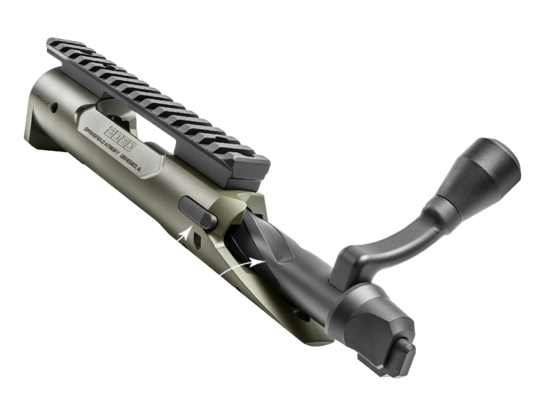

Looking to purschase a 6.5 PRC and was looking to get a Leupold VX-6HD 3X18X50 and not sure what size (low, Med, High) rings I should get. Any suggestiions would be great

Get the scope as low as possible.
Just attach the lower 1/2 ring on the Waypoint rail & set the scope in, w/o the upper 1/2 rings, to see how the scope sits in relation to the barrel.
Start with low rings since the Waypoint rail already adds pretty significant height.
If the low rings don't allow the scope objective to clear the barrel then mediums are the way to go.
Probably medium. With that rail you don't want high. Medium should clear the 50mm objective and you can adjust the comb if you need to raise your face. I needed medium on my X-Bolt with a rail.
