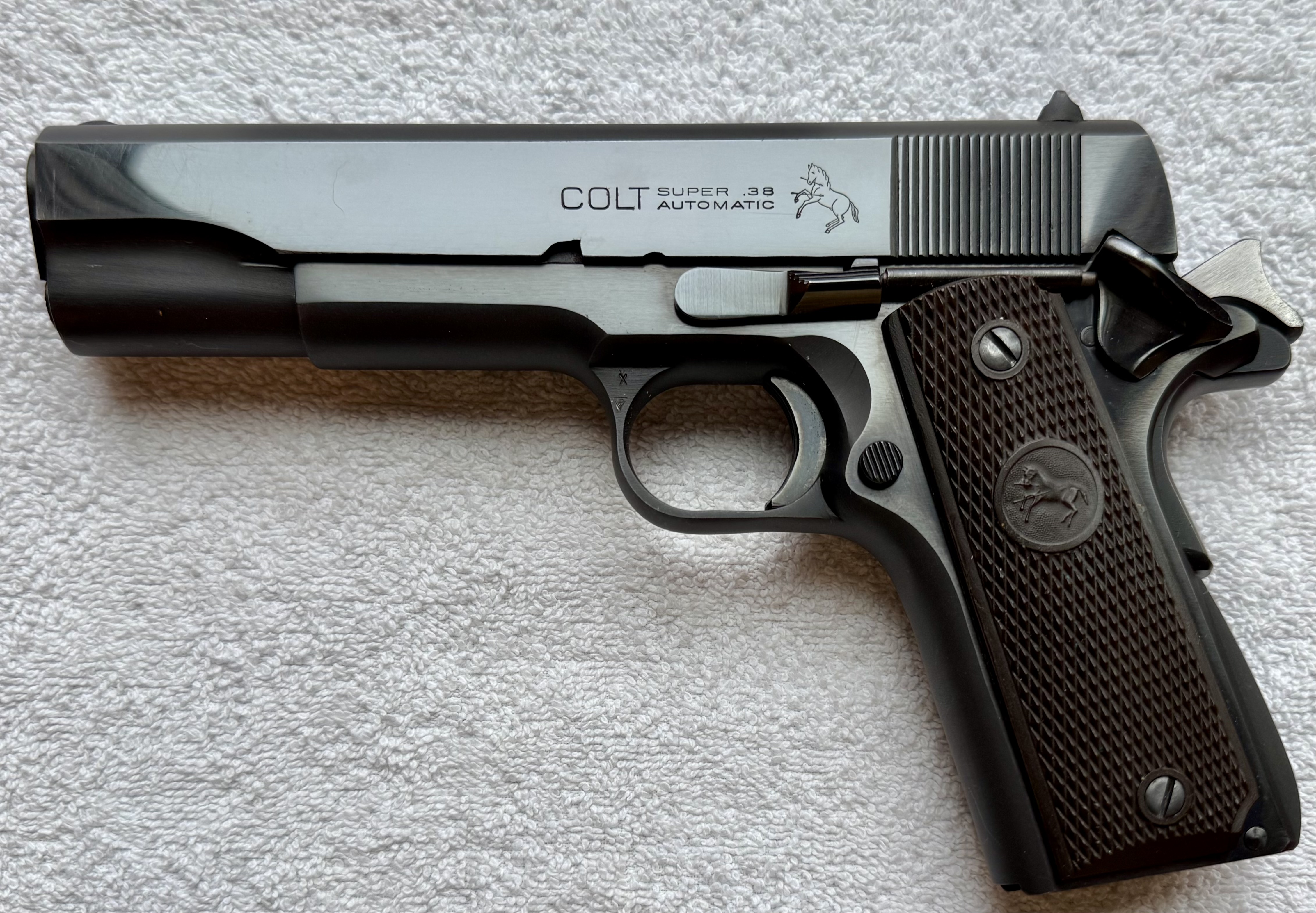

The Super .38
I've had 38 Supers since the late 80's one of which is the limited edition Gold Cup Super Elite that was the first 1911 that Colt head-spaced on the case mouth vs. the semi-rim.
I converted a RIA 9mm to 38 Super, and I have 9mm SA Loaded Target that I converted to use the 38 Super & 9x23 Winchester interchangeability.
Would like to get a Colt Commander in 38 Super.
