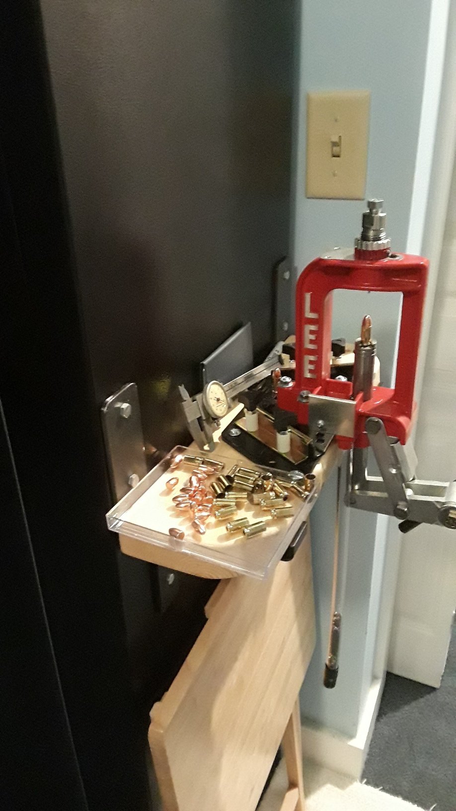

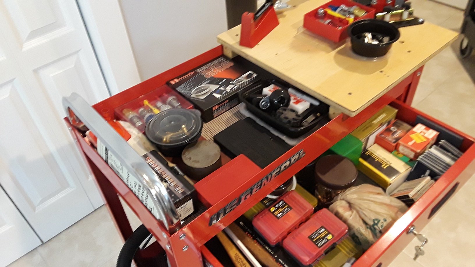

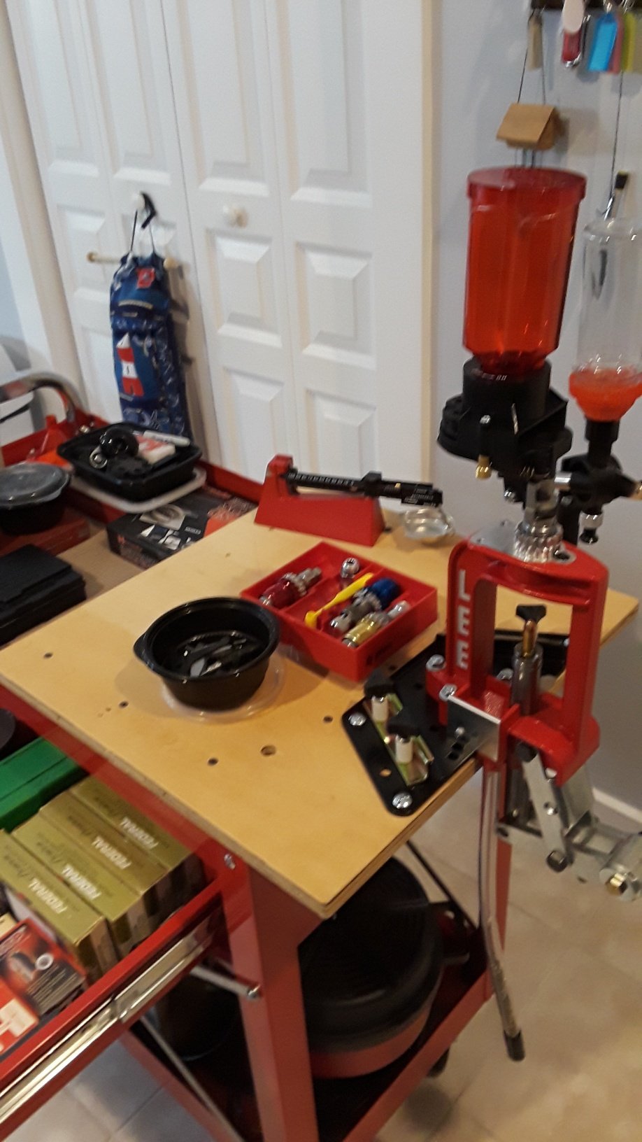

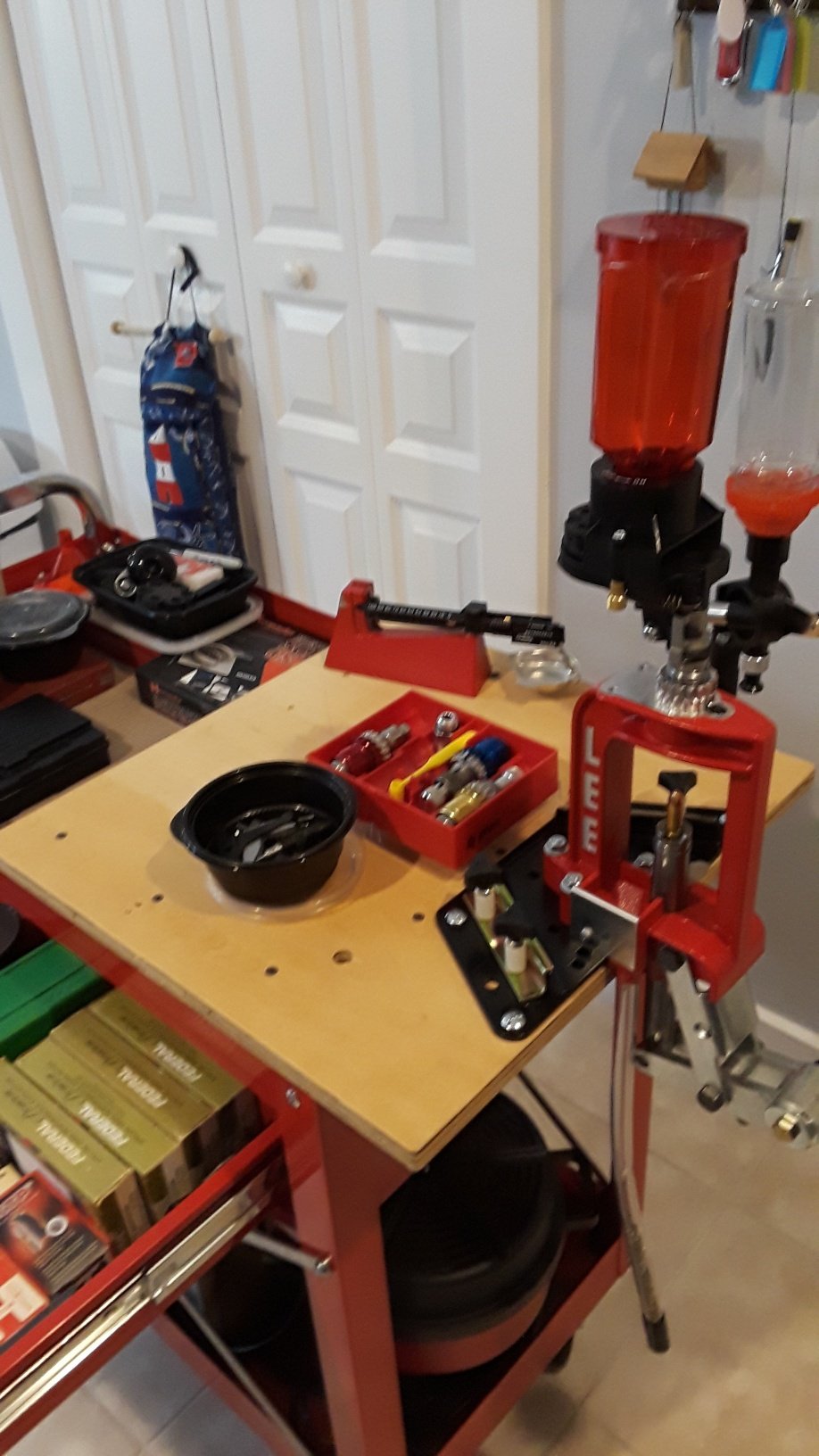

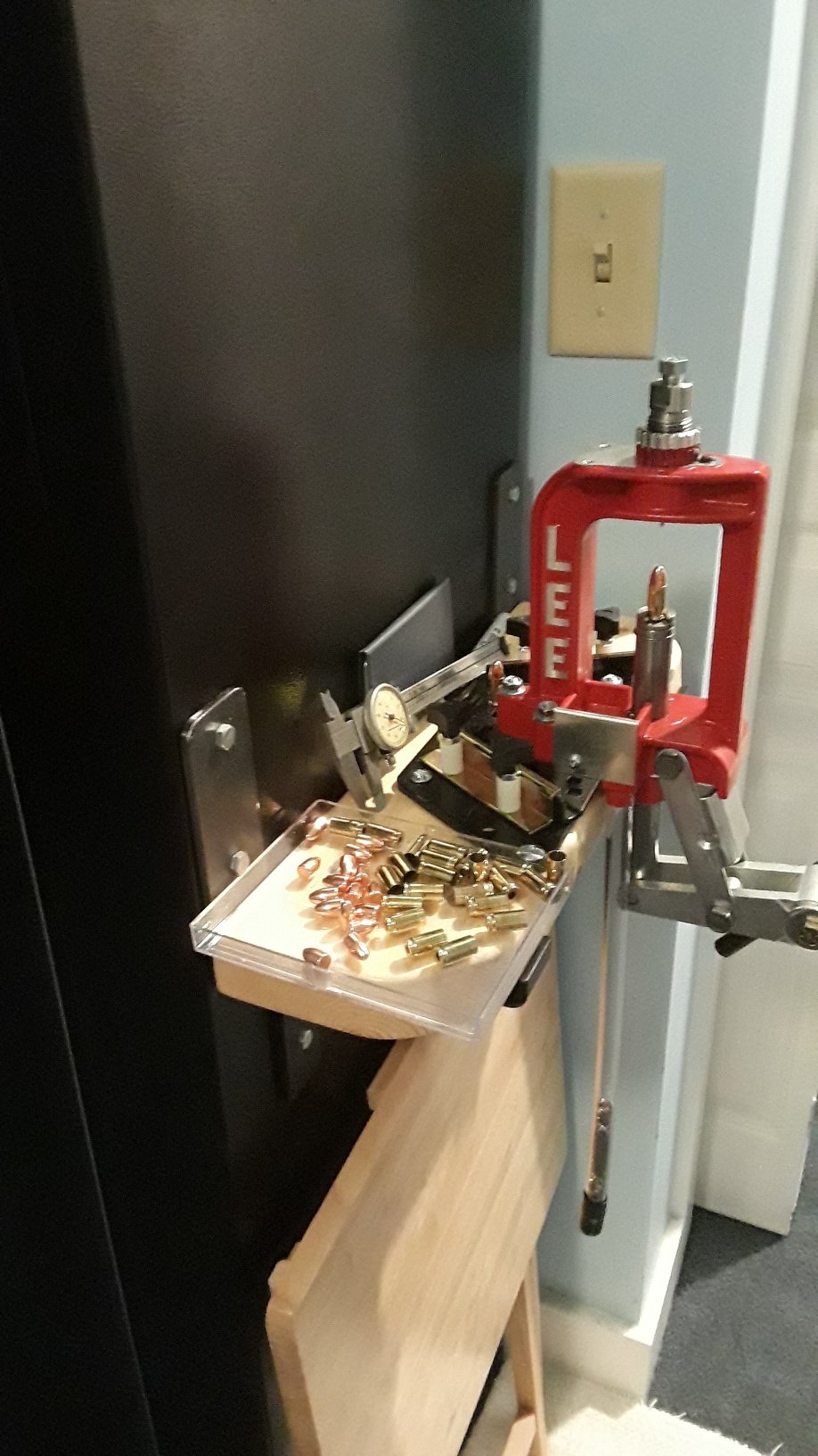

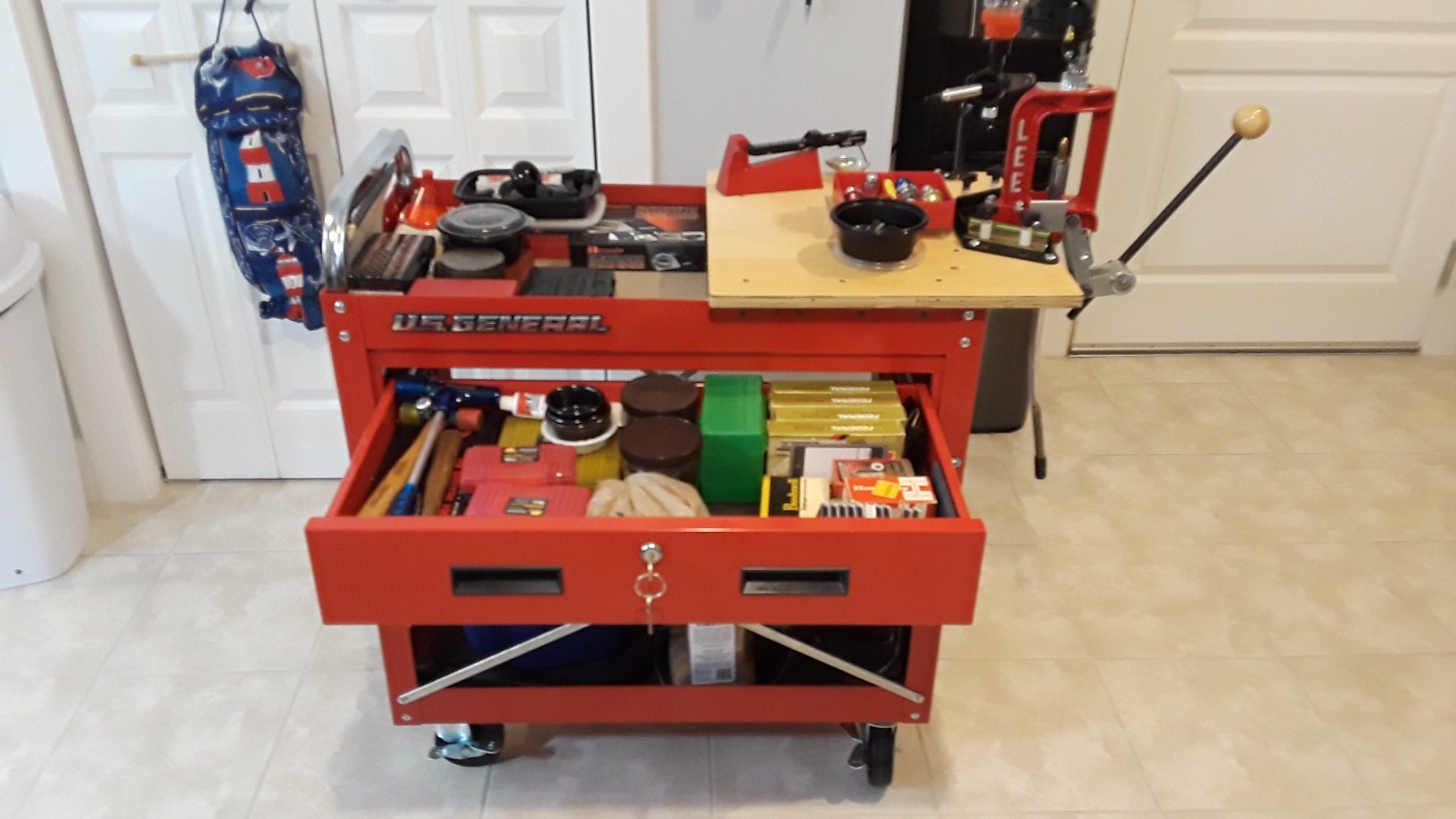

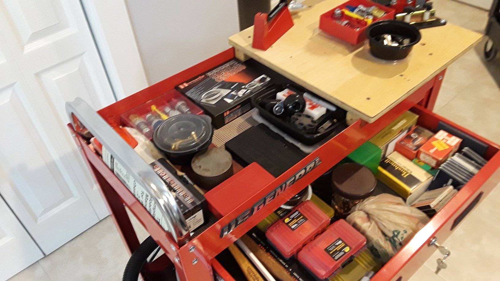

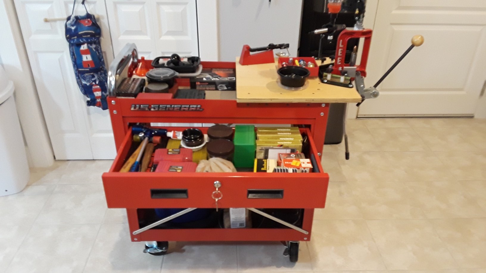

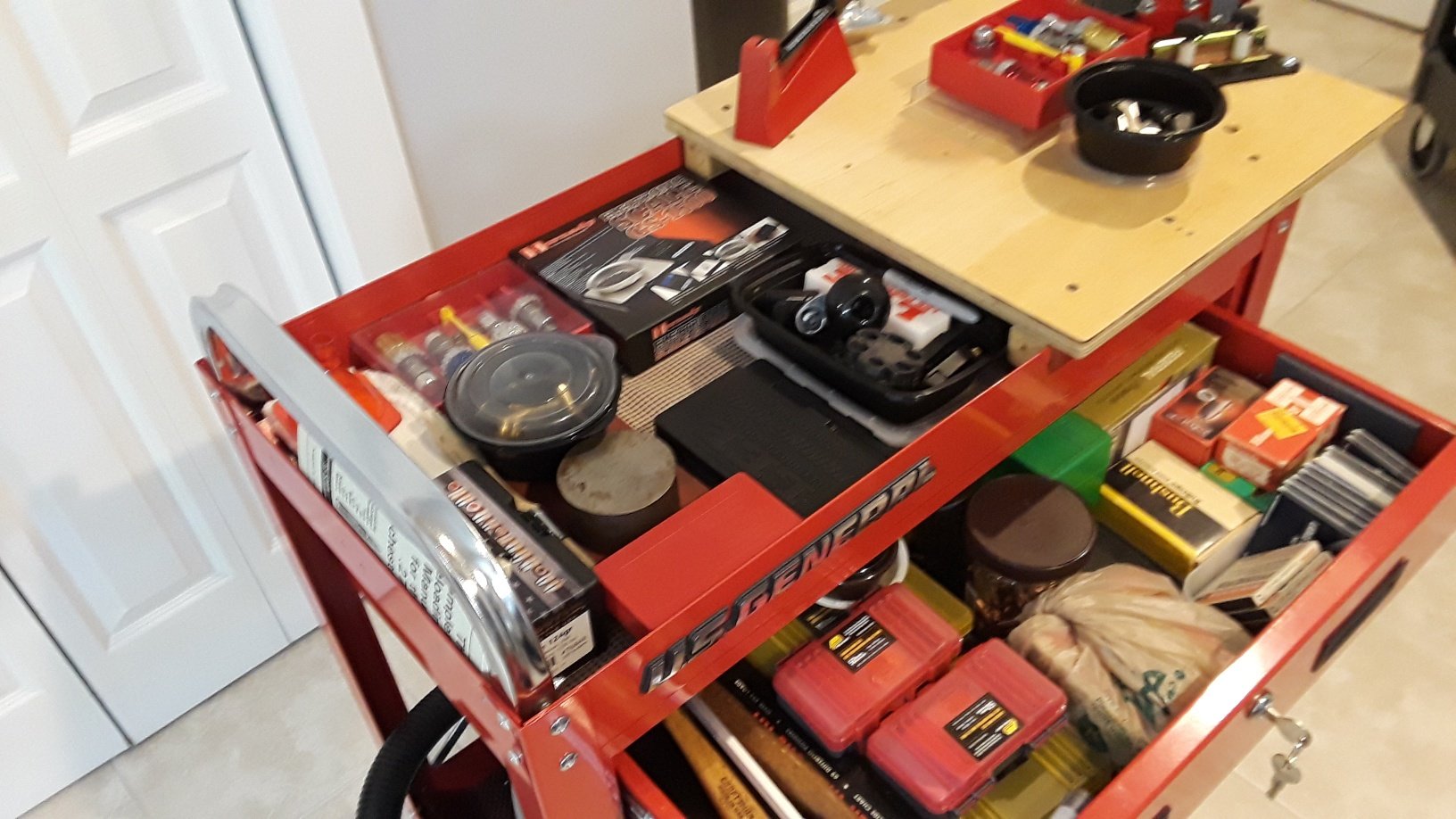

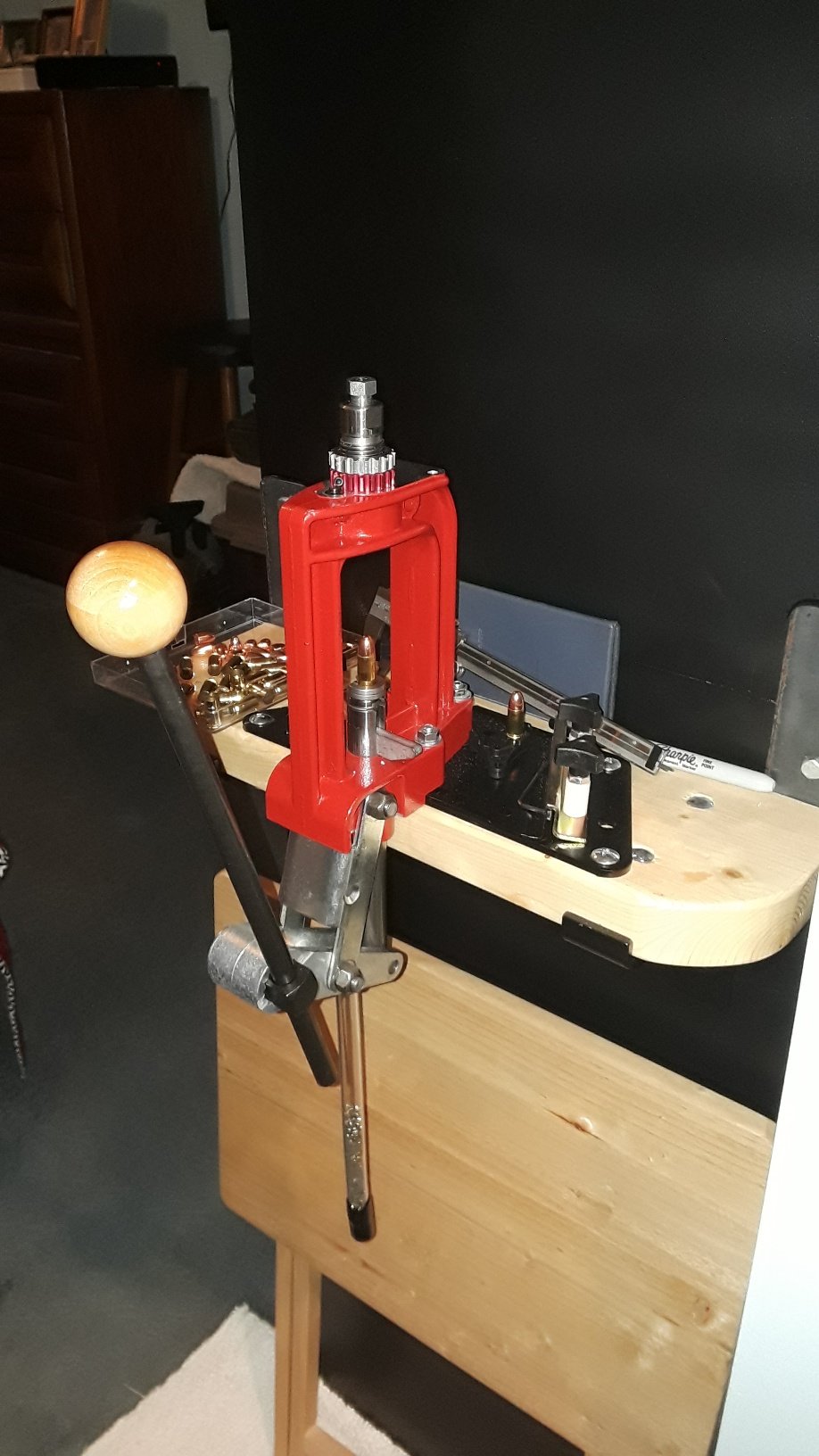

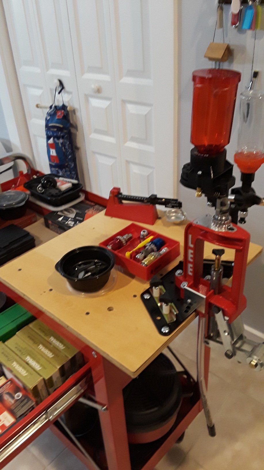

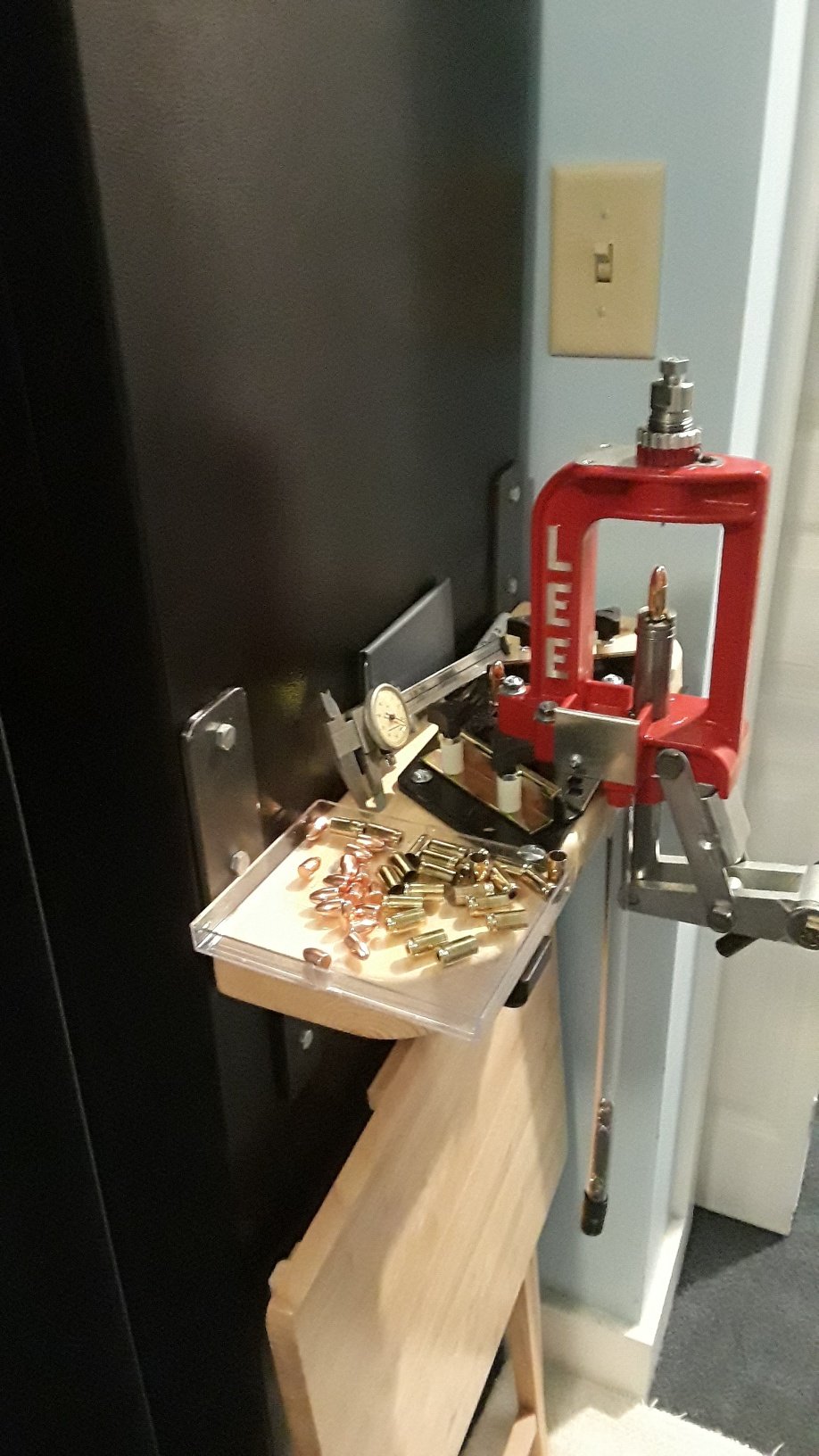

I'm impressed with some of the ways we re-loaders can 'make do' with what we have to do with like your 24"x24" table. Back when I started reloading, I lived in a 3 bedroom house with lots of room for just me and the Mrs. So I had an entire bedroom for my hobbies, office, man cave or whatever you call it. When we moved into the retirement community (I still refer to it as the institution ;):)) about 7 yrs ago, I had to scale down on everything I had, including my hunting gear, fishing gear, tools and welding equipment, airboat, stock car, trailers, etc. So I gave most of my firearms and all my reloading equipment to my yard son who lives in N Dakota. Well, it didn't take too long before I realized that was a bad move, so I started replacing my loading stuff so I could keep shooting. But the problem was we now lived in an 1100sq' apartment with 1 bedroom, a den, a living/dining room combo, kitchen and 1 1/2 baths and not too much closet space. To make do I HAD to keep my loading space confined to a small space. If you don't believe me, just ask the Mrs. ;) So I first bought another single stage breechlock Challenger press, mounted it on a shelf mounted to the side of my gun safe, used a stool to work from and used our bed and a small folding TV table to lay out all my loading tools like powder measure, scale, box of bullets, cases, etc where I could reach them as I worked. That worked pretty well but as my assortment of tools grew, the space grew too small and limiting. So my final solution was a roll around cart about 16"x40" that I mounted a piece of plywood on a piano hinge on one end with a "LEE" mounting plate. That gave me much more room to work and to expand, but the best part is I can roll it anywhere in my apartment where I might want to work. I have storage space in the cart itself, under the piece of plywood, in the drawer, and the shelf under the cart. I keep all my loading equipment there now except a few things I keep in my safe. It's worked very well for me, even though I've added quite a bit more equipment over time, it makes the Mrs happy that I'm not using the bed to put things on, and most of all I'm not interrupting her late at night if she's gone to bed and I decide to do some loading. I'm including a few pictures of where I started using the small shelf on the side of my safe, and of the cart I eventually moved to and use now. Most of my extra equipment, like additional presses, jar of crushed shells for cleaning brass, extra dies, other assorted re-loading stuff is kept on the bottom shelf of the cart. Components, bullets, primers, etc, are kept primarily in the drawer. Powders are kept in the safe. The layout of the cart has changed a little since the beginning, but the basics are there for you to see. I'll be happy to answer any questions or concerns anyone might have. I hope you like it and maybe get some ides for your own use.
20211201_222440_resized.jpg20211201_222532_resized.jpg20211207_192229_resized.jpg20211207_192318_resized(1).jpg20211207_192525_resized.jpg
View attachment 106943View attachment 106944View attachment 106945View attachment 106946View attachment 106947
That is a pretty neat and sweet setup for a limited space. I like it, it is genius!
I have a lot of my stuff stashed in an "environmentally controlled" storage unit. I've managed somehow to keep vital tools, extra dies and all of my extra gimcracks, presses not in use, etc. accessible within that unit. I basically treat it like a large closet, except that it is a couple of miles drive to fetch or stash anything.
But my basic workspace is a 24"x24" heavy wood bench. I keep all of my handgun bullets stashed on a shelf that is attached underneath it just above floor level, so it is solid. There's less wobble and jump when I'm running my press than you see in most "how to" YouTube reloading videos. The bench top(s) are swappable and I have several to accommodate my various presses and gear. I keep the extra tops in my storage unit along with the presses not in use.

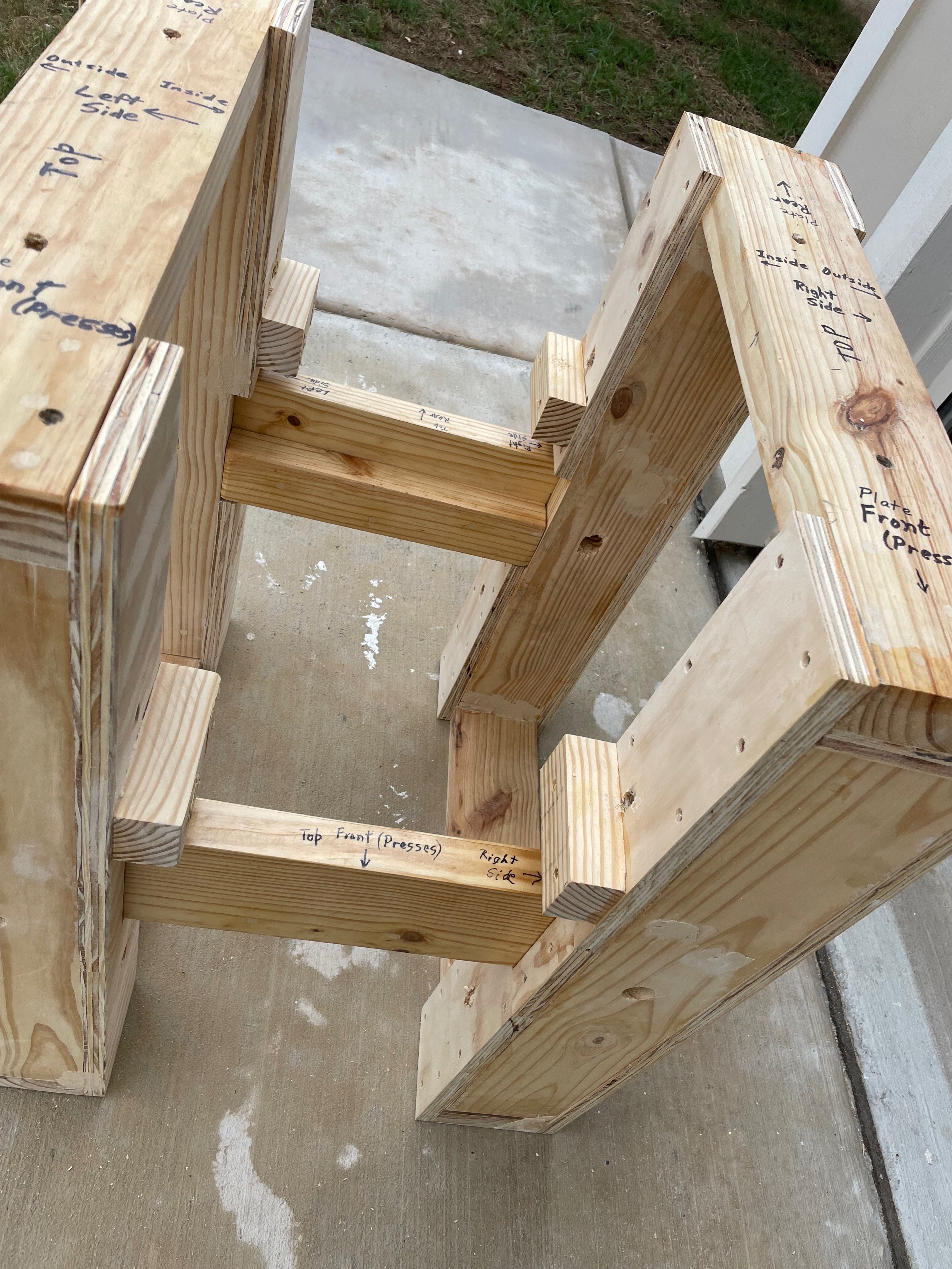

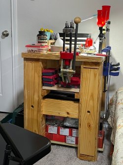

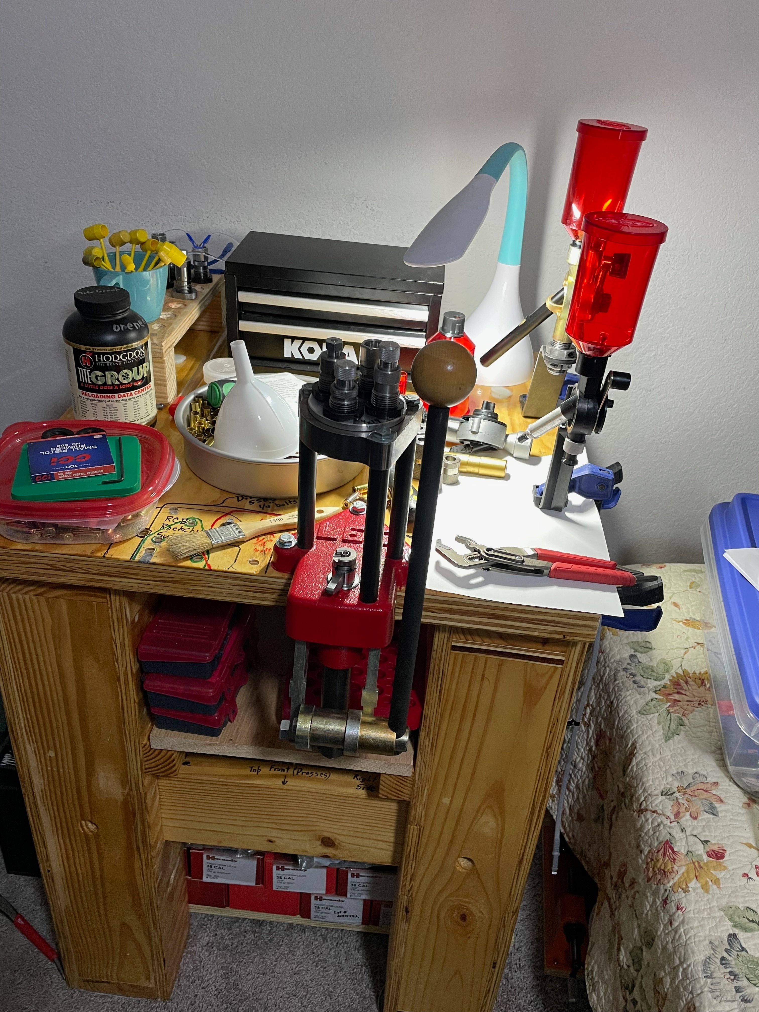

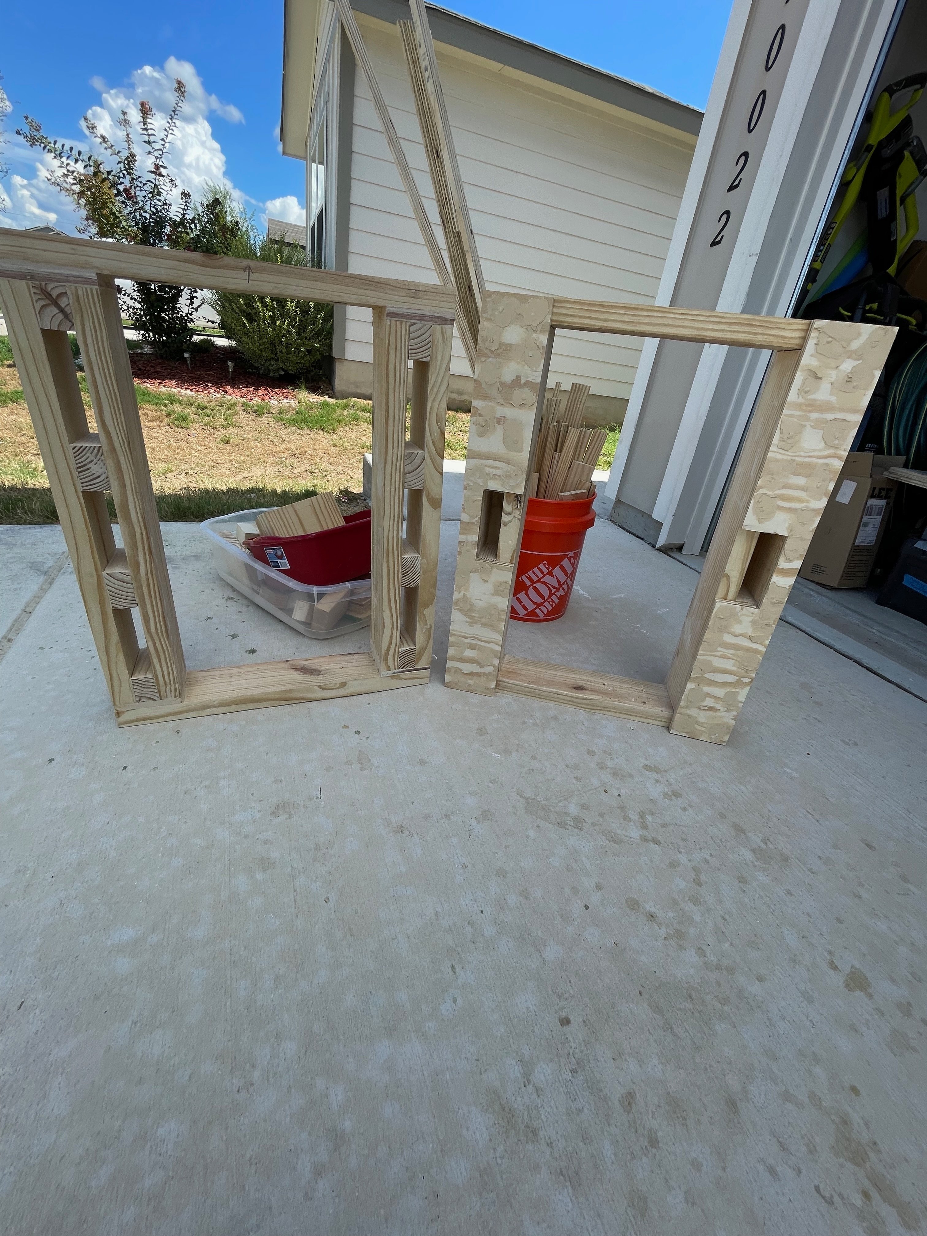

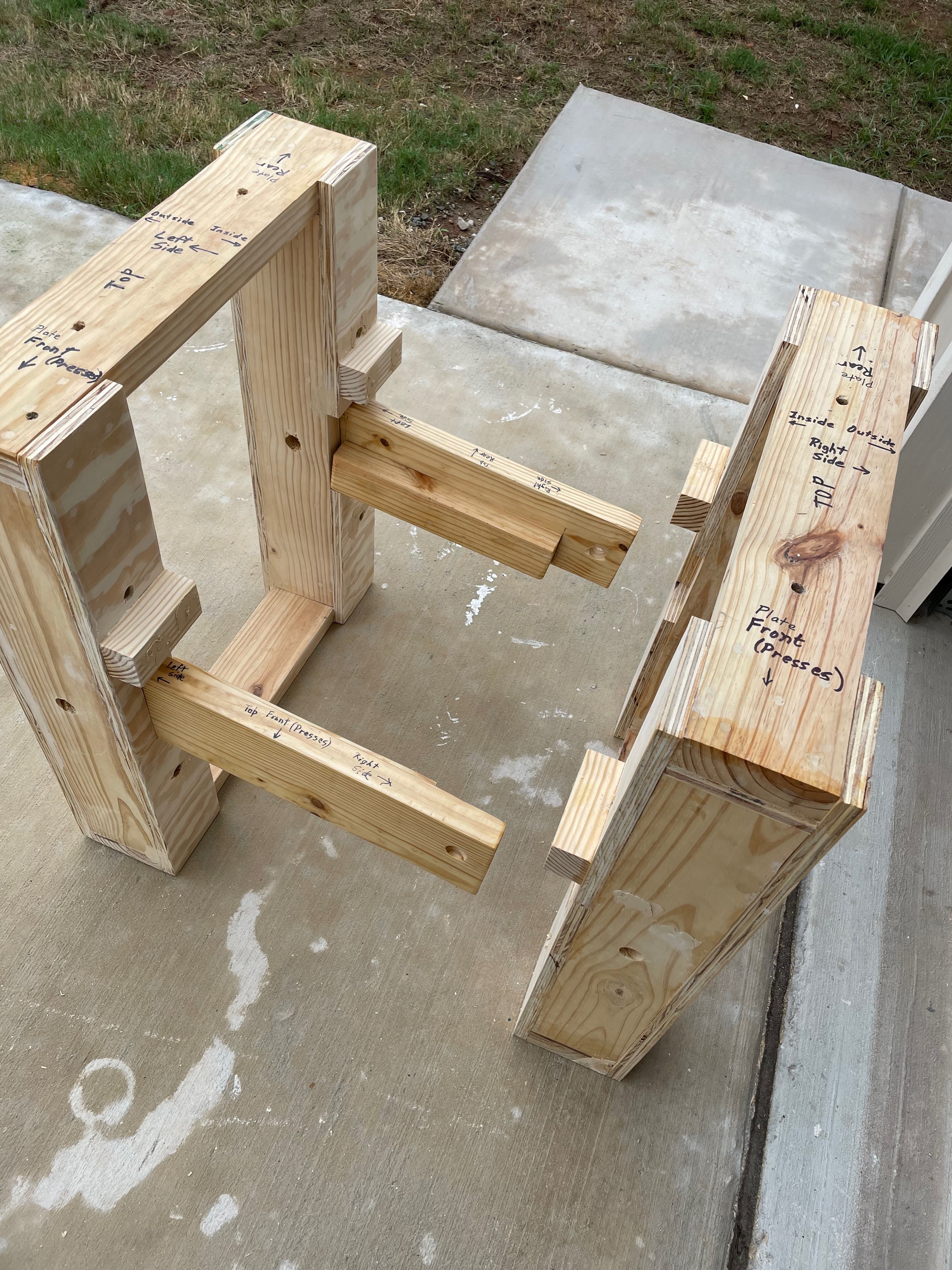

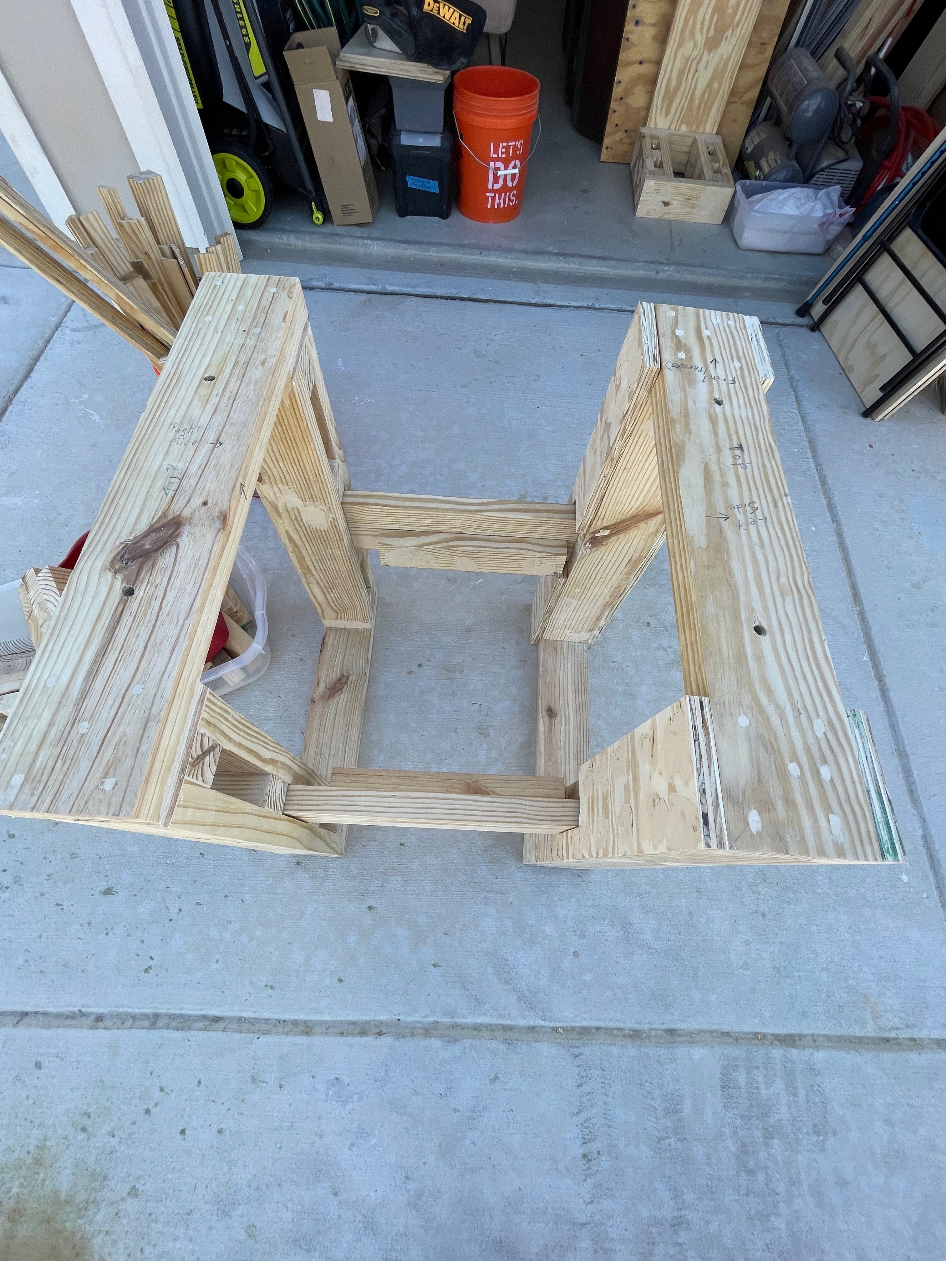

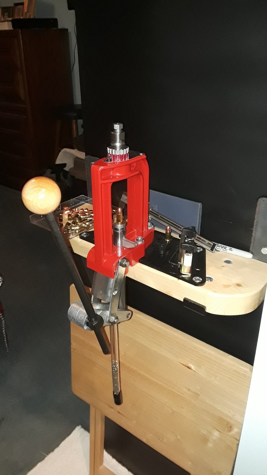

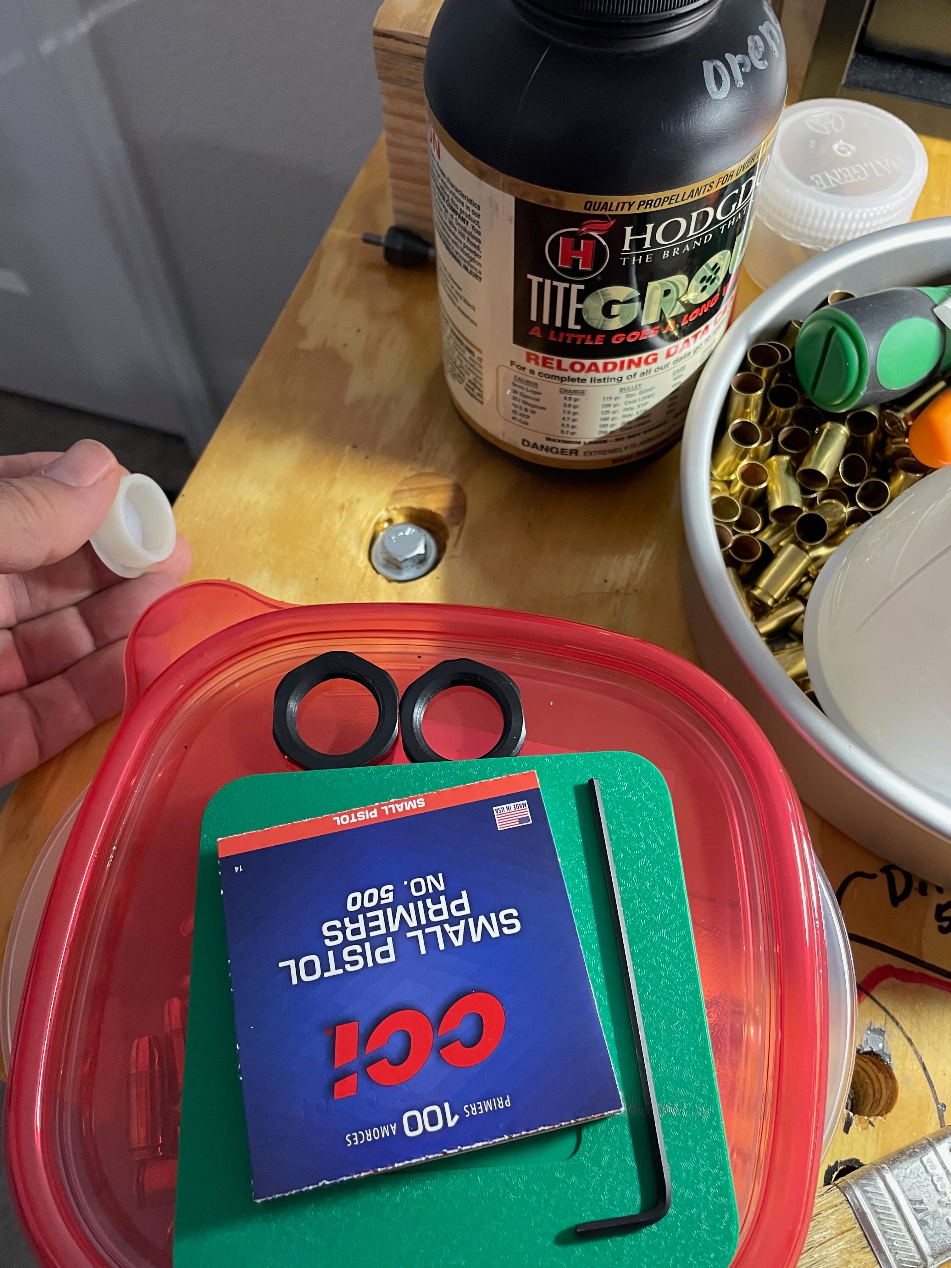

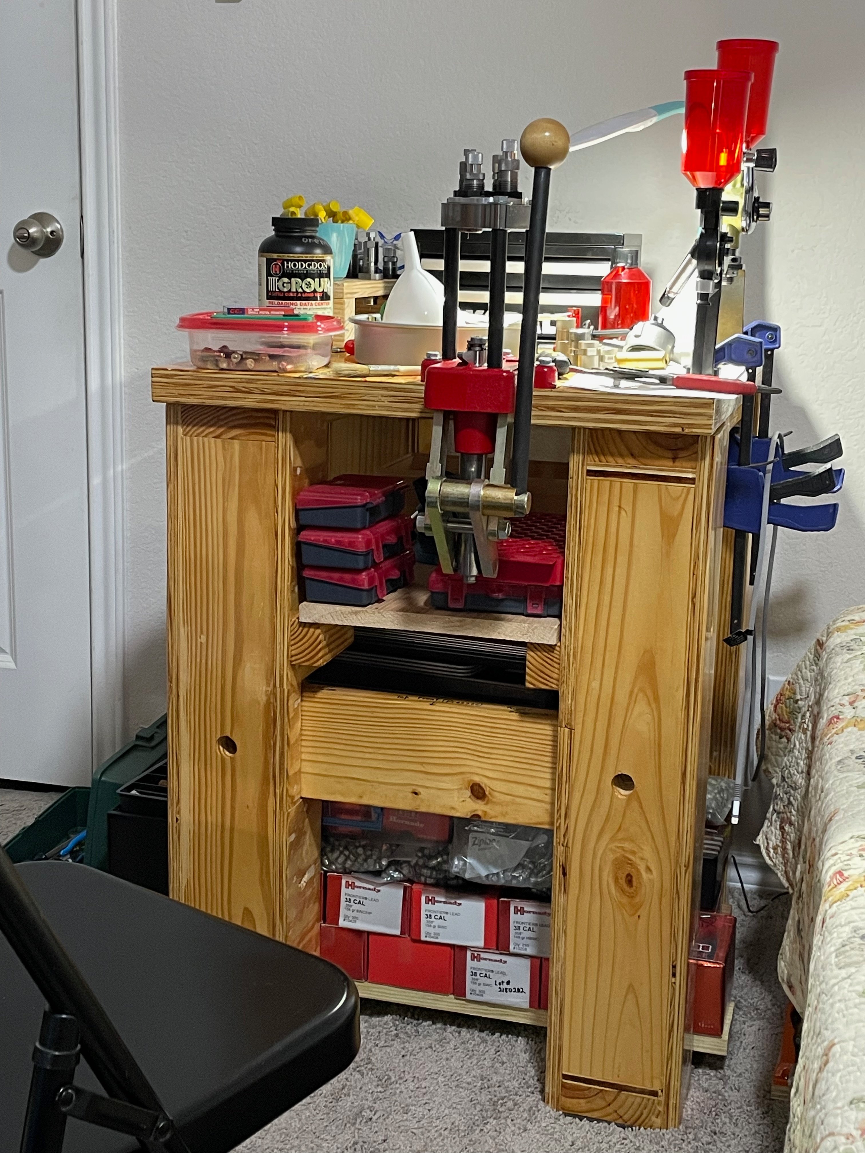

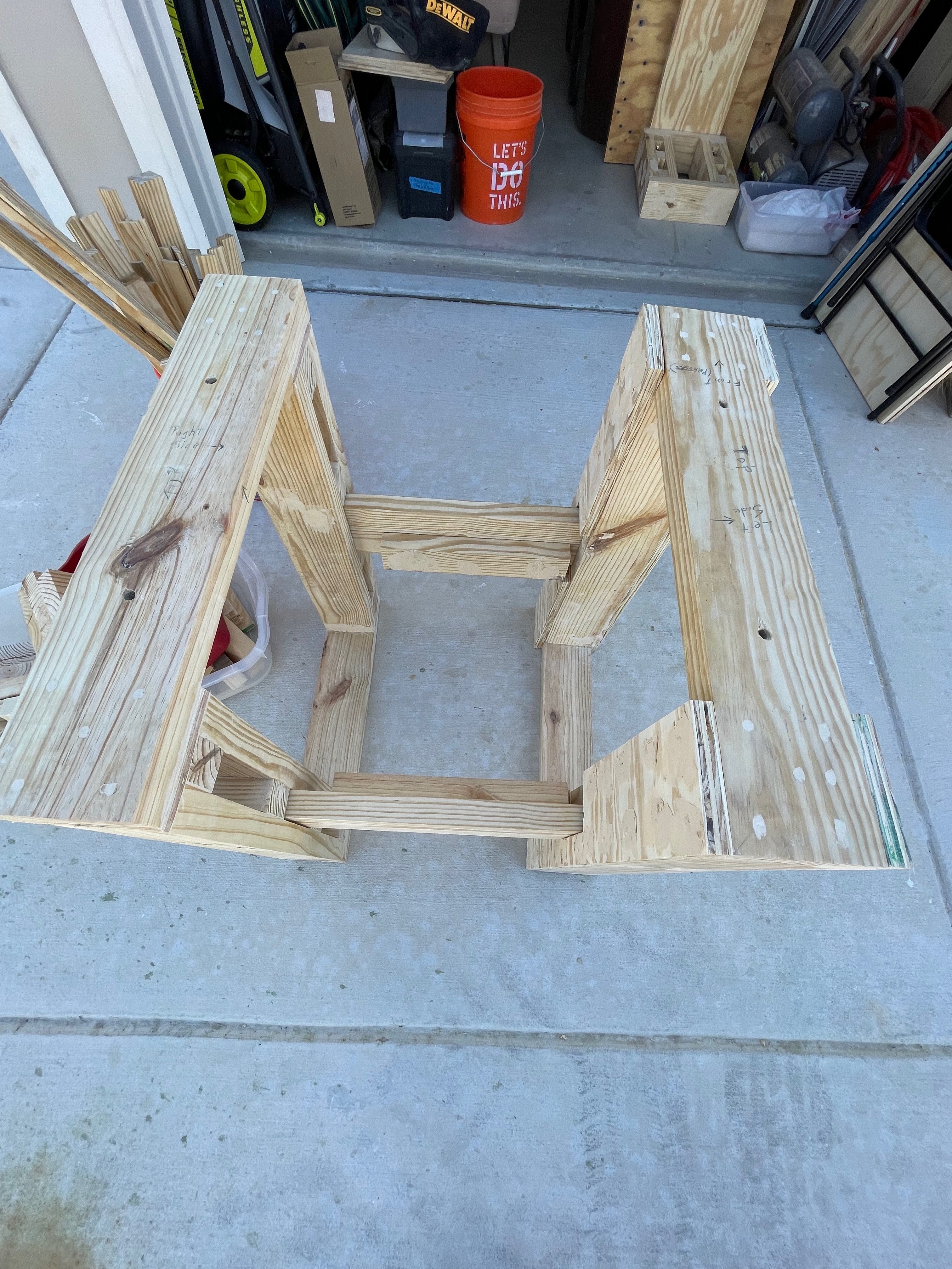

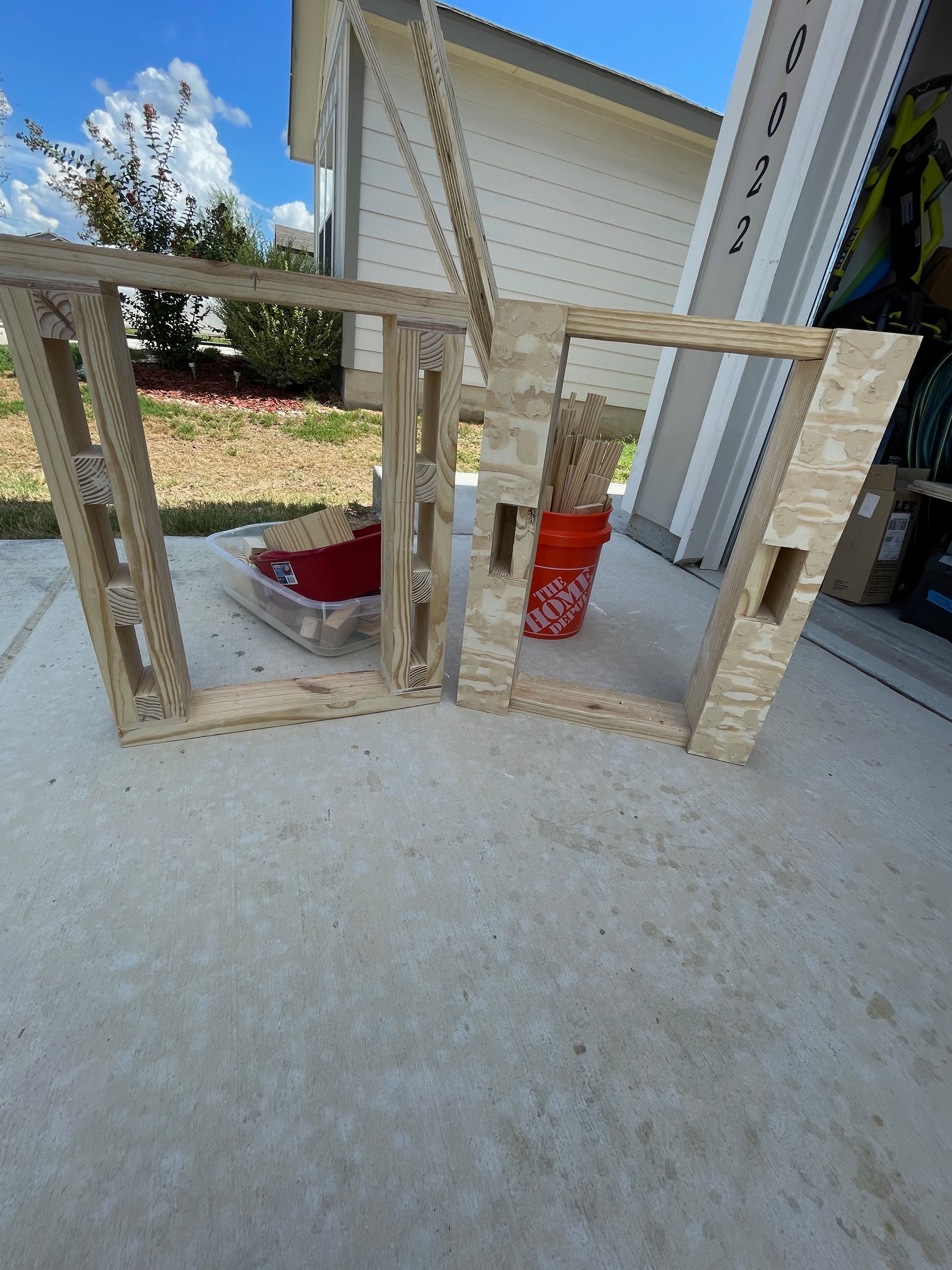

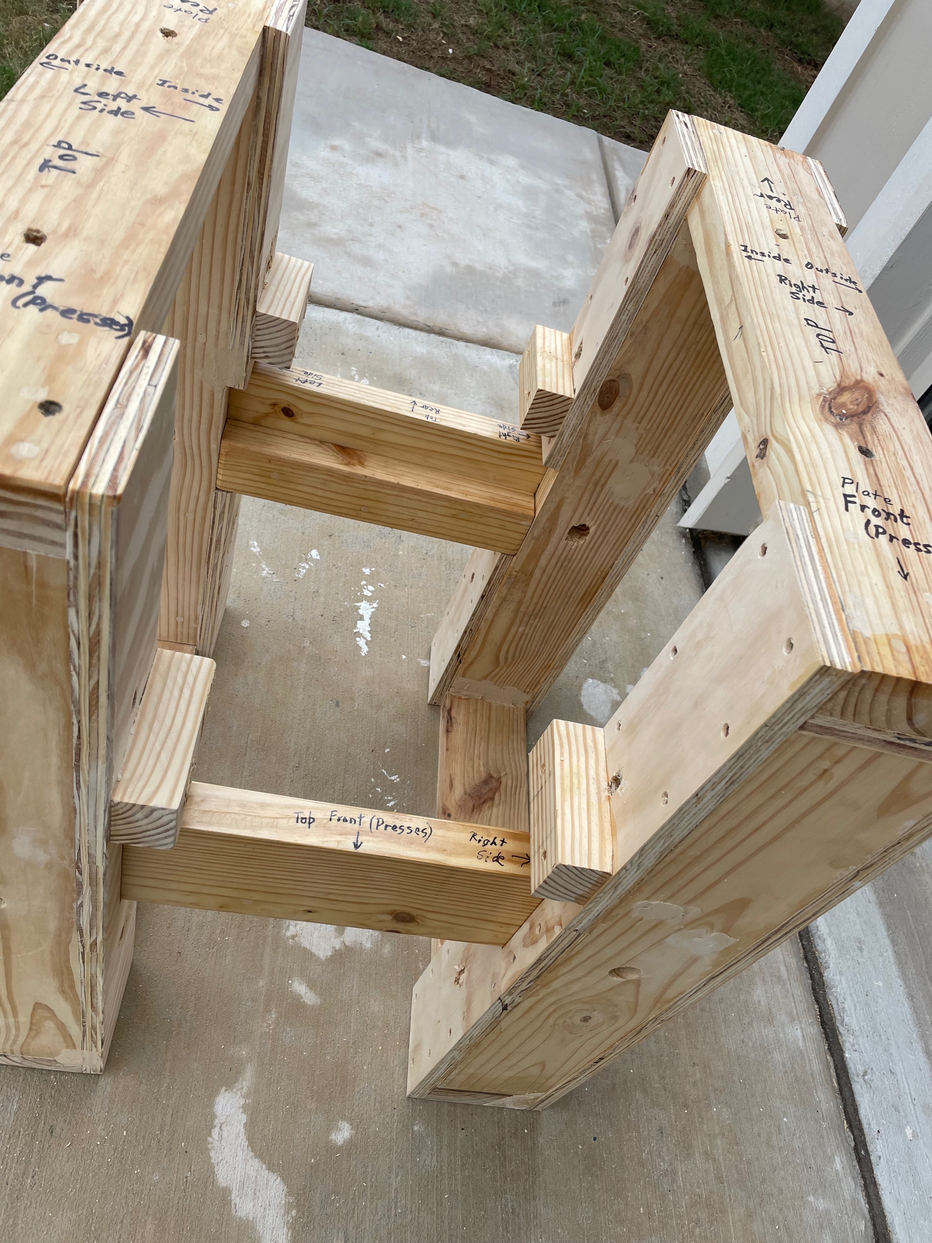

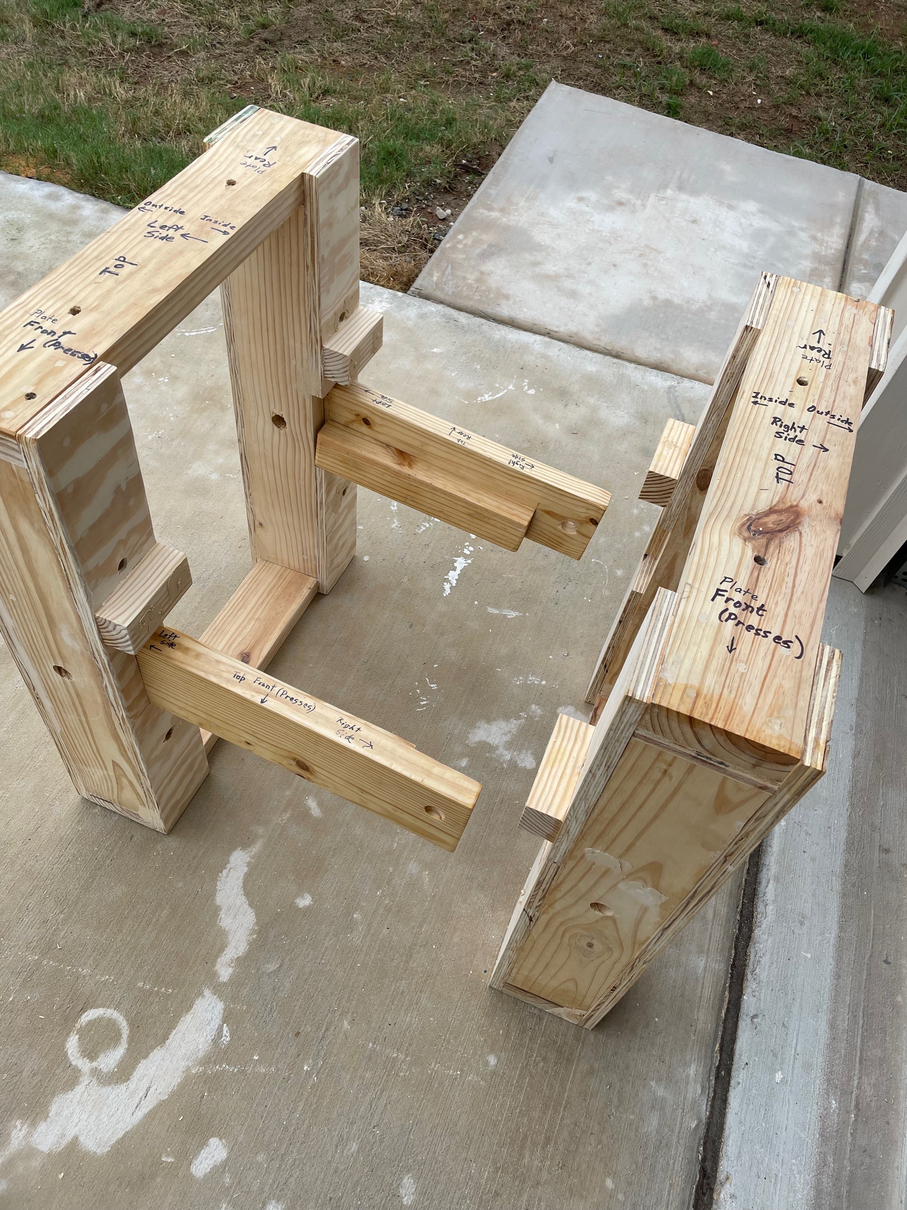

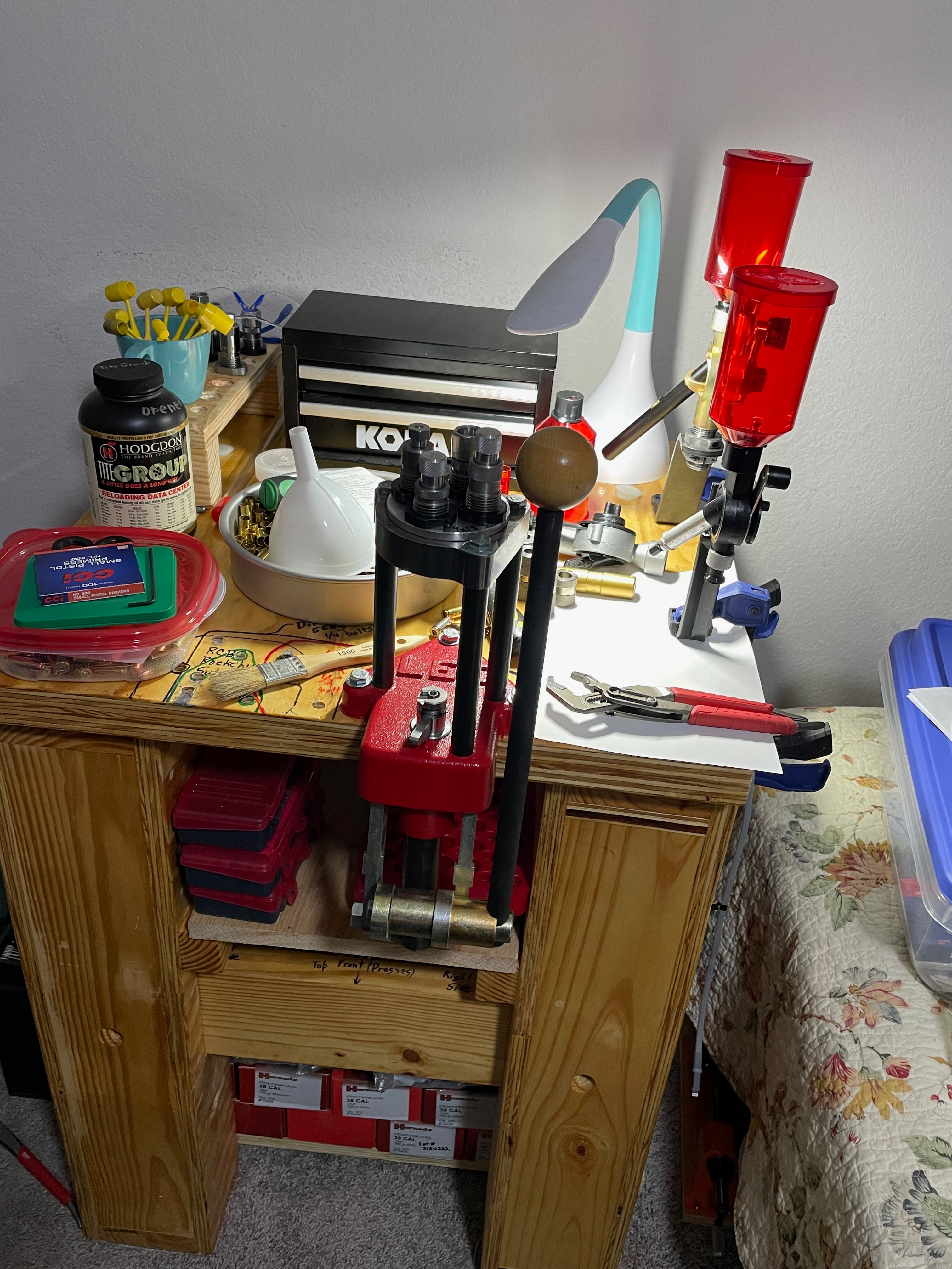

OK. Here are the pics of my "incredible shrinking reloading bench." I built it from some of my son-in-law's leftover lumber from one of his projects. The top is exactly 24" x 24" and is a double-thickness of 3/4" plywood bonded by copious quantities of wood glue and a few deck screws "just in case". The front edge (and the back edge too, if it were accessible) has space for a single "wide" press or for a couple of "skinny" presses. As you can tell, there's only about a max of 2/3 of the width useable for press mounting. If one gets too close to or in front of one of the legs, the press toggle links collide with the leg. If you look closely, you can observe my big stack of handgun bullets stacked below.
The bench is plenty heavy all by itself. With all that lead added, it is immovable and unshakeable. The bench top is attached with four bolts running through the top and connecting to the front-to-rear braces. Everything else just "slides into place." Remove the four bolts attaching the top and the whole thing is can be disassembled. I have several "tops" so that I can attach presses with differing bolt patterns. This particular top looks like it has been attacked by a woodpecker and can accommodate five or six different presses (one at a time, obviously).
This rig doesn't provide much in the way of storage. I keep the dies, tools, components, etc. at hand for whatever I'm working on at any given time. The rest gets stored in containers in the garage or migrated to/from my storage unit. Awkward, but I have more time than anything else right now. It works for me under the circumstances.

Wow, not underwhelming at all. That is very nice work. Well thought out and laid out. Other than not being able to line a few presses up in a row it looks like there isn't anything you couldn't accomplish using it.
Thank you. It's actually the most solid reloading bench that I've ever built / owned, including one I had in my garage that was affixed to the wall. I guess that all of my previous experiences kinda funneled into this attempt. It's been finished and in use for almost two years now, and I'm still pretty happy with it.
I can't agree more!
You should be happy with that bench. A great idea and design ... maybe time to look into a patent??? The knock down feature would be a real boon to some like us who have very limited space. And as far as the pictures show, you must have some wood working experience.

Mr RedGoat, I've got a couple questions I'd like to ask if you don't mind
1st - Your pic# 7652 shows the 2 most common powder measures "Lee" makes and I have one of each also. I love the 'Deluxe' Perfect powder measure, but I didn't like using the smaller 'Perfect' powder measure when using some very fine ball powders. Unless I was very careful in adjusting the drum, it would sometimes leak a few grains of powder (physical grns, not grns weight). Just enough to be a bother. But then someone told me the secret to fixing that. I carefully sanded the outside of the drum and inside of the housing with very fine sandpaper till I obtained a 'perfect' fit of the two pieces. It didn't take a lot of sanding. The "Deluxe" Perfect measure worked like a dream from the very first load of powder after running 1 load of powder through it to ensure no static cling. Both will measure within 1/10gr time after time regardless of powder:). What's your assessment of the two measures? I also have 1 of the "Pro" Auto disc measures and 2 of the "Pro" Auto-drum measures. Actually all mentioned here will consistently measure within 1/10gr of any powder. As will the 'anti-static' dippers if used as directed and a final wipe with a business card. I noticed you had a few at the back of your table.
2nd - Are the clamps with the blue handles shown in pic# 7653 part of the loading bench assembly/construction, or just hanging there for convenience?

Q1 - "What's your assessment of the two measures?"
A1 - I've had and used that inexpensive "Perfect" powder measure for a long time. I just received the "Deluxe Perfect" powder measure and haven't done any more than just play with it. I like the way that its calibration markings are much more visible and adjustments are a bit more positive. Time will tell if it proves as satisfactory as the older non-deluxe one. I've had the same problem as you noted about very fine grained powder sometimes escaping from the older "Perfect" measure (note the white paper underneath to make any powder leakage highly visible. I don't want it getting off the bench and into the carpeting). You also noticed the Lee dippers. When I want the ultimate in simplicity, especially when working up loads, they are my go-to. Use the VMD table value for the given powder times the target charge weight. Select the dipper that is right at that volume or a little under. Dip. Drop onto scale. Trickle up. Simple. And far faster for 10 or less charges (typical of load development) than trying to calibrate one of the powder measures. I also have a Lee AutoDrum powder measure and their AutoDisk powder measures. All are great tools for their intended purpose and work very well. I have a couple of RCBS powder measures too, but I actually prefer Lee's. I can't really explain why, it's a "touchy feely" kind of thing. I didn't show my powder weighing setup. It's on on a desk on the other side of the room. It's not very convenient, but is the best I can do given the space I have to work with. It consists of an old Redding #2 scale, a set of calibration weights, an older RCBS powder trickler, and a newer RCBS electronic scale with a digital readout. I also have my "discarded" cell phone set up on a stand where it shows the scale balance indicator when I'm weighing charges. The phone's zoomed in camera display makes reading the scale and hitting a "perfect" zero very easy without having to bend, crane my neck and squint while the scale settles.
Q2 - "Are the clamps with the blue handles shown in pic# 7653 part of the loading bench assembly/construction ... ?"
A2 - No, they are just a makeshift way to quickly "attach" the powder measures to the bench. I can quickly move the measures around, swap places, etc, and then detach and store them (I use the plastic shoe boxes that one can get at Wally World and many other places to protect the measures when stored). I formerly kept the measures on stands which were affixed to rather bulky (space footprint wise) blocks of wood, but I've now abandoned the wood block attachment method in favor of the small clamps to save on work space.
