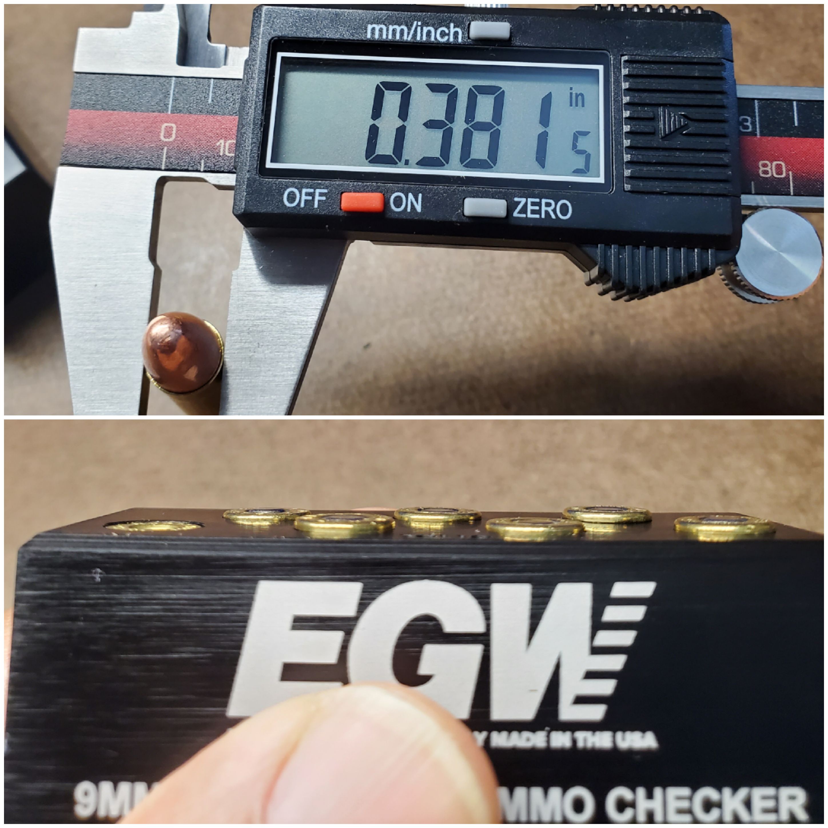

Update...Was definitely the lack of crimp. Excitedly attached the die, and all measurements came out much more acceptable. Also, shot my very first reloads today, and came home with no incident. Considering how this thread started, must say while a little nervous, I was very proud, and excited to continue my new hobby!

Obviously I'm getting to this party just a little late, but wanted to add a few tid-bits to help if I could. When I read your comment .... " Update...Was definitely the lack of crimp." I thought it might help. It might not have been the lack of a crimp being the whole problem, especially if you're using 'X' times fired brass. The crimp may have just covered up another issue.
Here's an observation and recommendation LRZ, but you might ought to double check the length of your cases, and your 'OAL'. That's the Over All Length of the loaded cartridge. From what you're saying and the looks of your loaded 'ammo checker', you might not be trimming your used brass quite enough and/or seating your bullet quite deep enough. The more times a case has been fired, the more important it is they be 'full length resized'. It's a good practice to measure even brand new cases for SAAMI specs. The factory quality anymore is usually right on the money, but occasionally some bad ones will get through.
The downside of this is that the more times the case is resized and/or worked, the fewer re-loadings you'll typically get. That is a result of 'over working' the brass and hardening it. You can oft times save an otherwise over worked brass case by 'annealing' it, but that's getting past the basic operation of reloading/handloading. Let's add this bit of advice here and now .... you'll never save enough money on reloading to make it worth trying to skimp on brass cases. If there's even a smidgen of a concern about a particular case, or box of cases, or a bucket of cases, dispose of them. DO NOT TAKE A CHANCE ON THE RELOADING OF DAMAGED OR SUSPECT BRASS !!!!!!!!!!!!! This advice would also apply to powders and primers !!!!
Often on cartridges that headspace on the case mouth such as the 9mm, and if it is that the brass is a little too long, the extra crimp will allow just enough for it to seat for a few loadings. At some point they will become too long even for the crimp to help. If it's an issue with the bullet not seated deep enough, the firearm's action will sometimes drive the bullet a little deeper into the case when it goes to battery and function alright. Even though some/many competition shooters will oft times load deliberately a long seated bullet in an effort to eliminate any/all 'bullet jump', in most cases this is acceptable, but it's not always wise.
A note here: Typically my general use bolt rifle stuff, and my revolver stuff, I don't always trim my used brass, depending on how many times it's been fired (yes, I can account for the exact number of times any/all of my brass has been fired). Especially if I'm loading it to be used in the same firearm it was originally fired in and/or for some competitions. But if I'm loading for semi-auto loaders of any kind, I'll always trim and resize to SAAMI specs. A habit I developed back when I was at about your current experience level. Typically most auto-loaders simply don't have enough umphhh in their actions to slam home on a non resized or 'too long' load, whereas a typical bolt action will not even notice. Your bullet seating depth is also more critical with the auto-loaders. Both issues are especially important on handloads for semi's.
And as for your question/concern about whether to crimp or not..... my advice for now until you gain some considerable experience is to crimp anything you're loading for a semi-auto, or any firearm that uses a stacked magazine, and especially if the projectile has a cannelure. Because as they typically stack in a magazine, the recoil will oft times pull the bullets in the mag out a little from the recoil with each shot. By the time you get down a few rounds, they will/may be too long to chamber correctly. As you gain experience you'll have a much better feel and understanding of this and in many cases will be able to control that using just the resizer die.

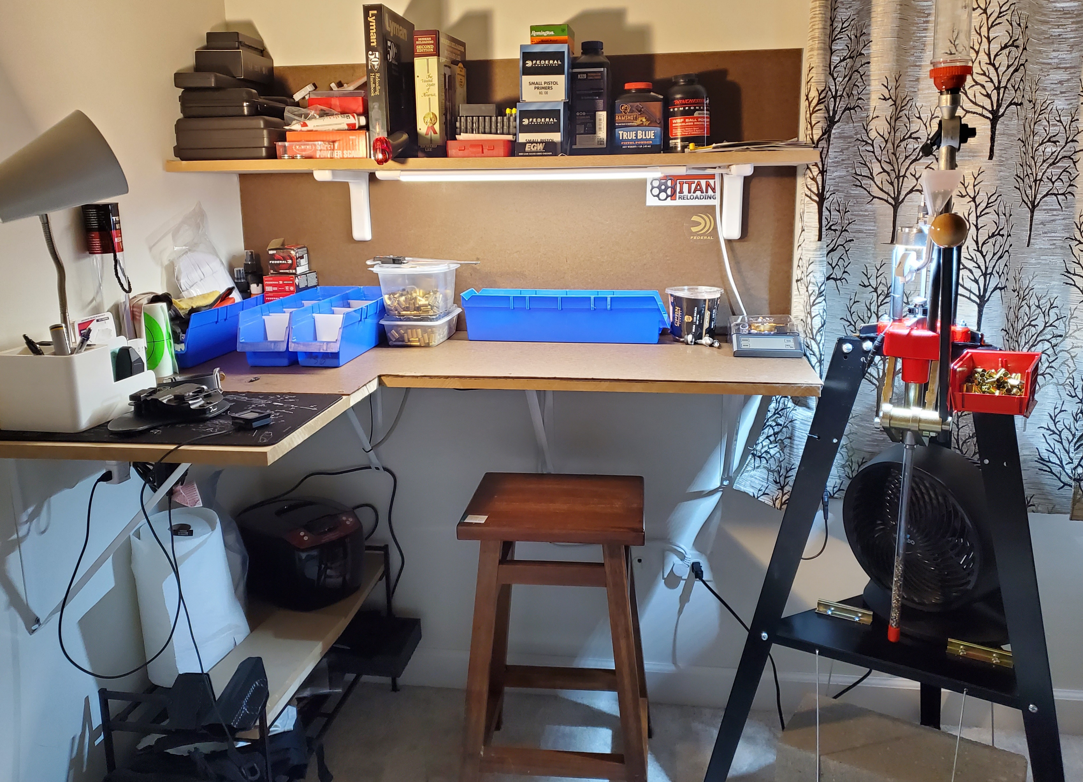

Good luck and welcome to the world of re-loading! And your station looks really efficient. (y) Enjoy!
