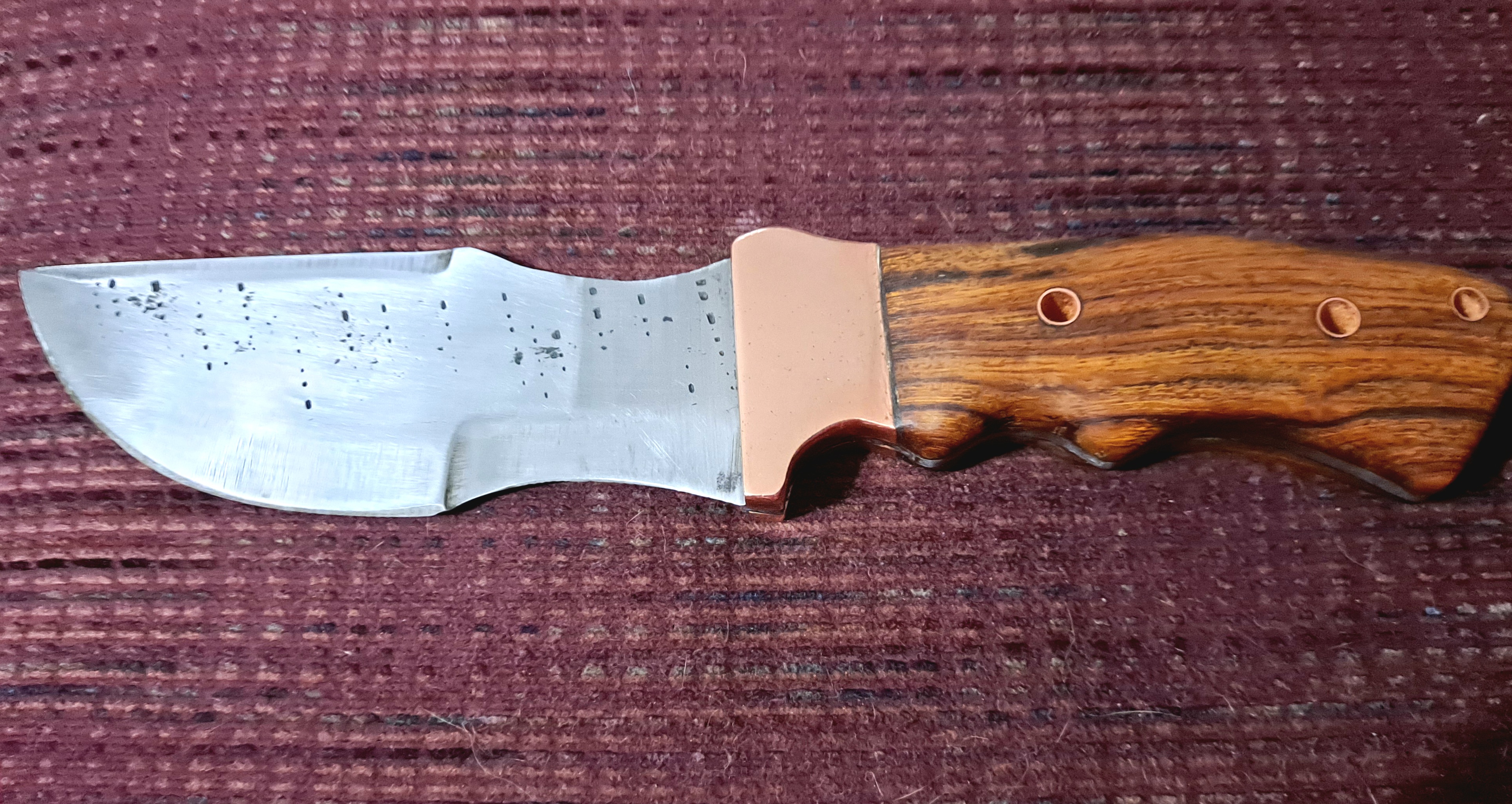

After a lot of study and reading of the design and specs here is my version. It's close, minus the serrated or saw back section on the spine. I dislike saw backs, they can weaken a blade, and serrations on a knife which may be used for food prep simply add places for bacteria to grow. Also I added my special hollow pins to allow for the blade to be lashed to a pole, something I have done occasionally for many years, side note I happen to see it on knives like some Tops blades the past few years too.
The blade is forged and yes I left some hammer marks in it like he wanted. I am going to spend a couple days seeing how mine fulfilled the design specs. Here is a link for anyone interested, it's a pdf.

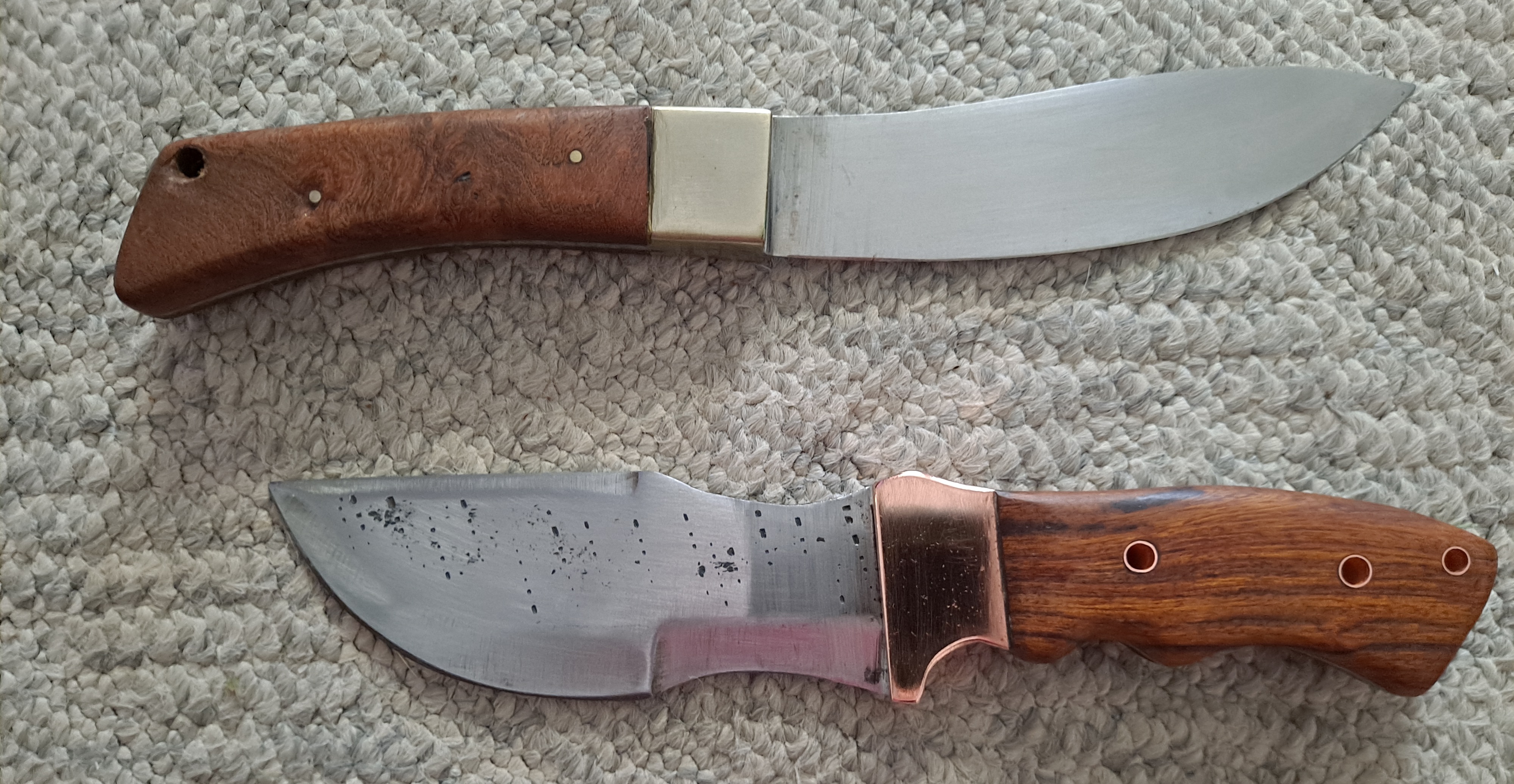

Here is the finished blade, the last knife I am doing all by hand. From now on its bench grinders and belt sanders in stead of files and sanding blocks. The top is the first hand forged one I actually made and kept instead of scrapping or giving away.

Tested the most obviously different feature in what I will call the tillering notch. The separate section near the copper bolster of the knife. I am not positive about how other versions are ground in this section but on mine I put a wider bevel more akin to an ax than a razor. I will explain this selection more in depth later. The tillering notch worked very well when I quickly tillered the basic shape of a handmade bow. The notches sides kept the ad hoc draw knife in a straight line. Now I will say this here, EXTREME CAUTION MUST BE USED TO USE THIS AREA AS A DRAWKNIFE. You are pulling a sharp knife towards you with your hands on a sharp blade.

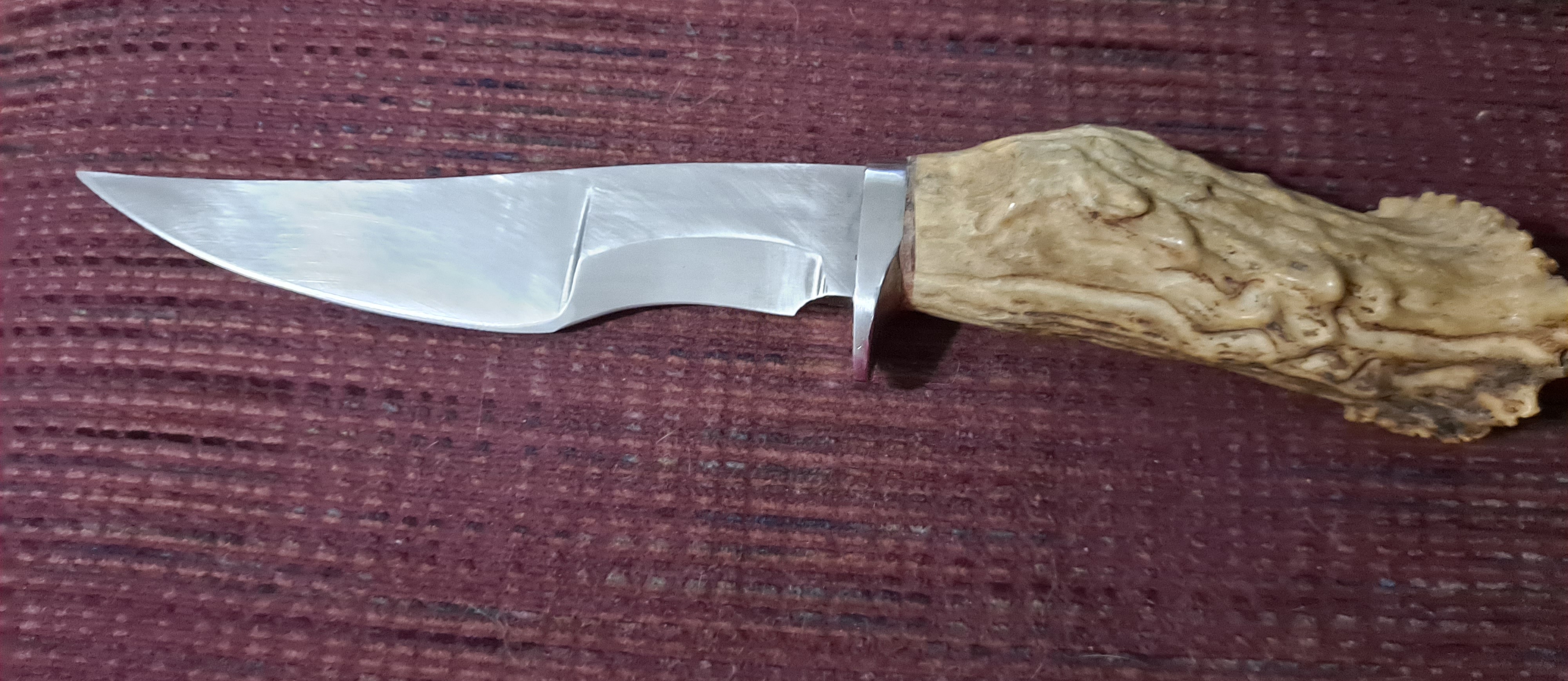

Now this tillering notch may seem to be innovative however its at least 40 years old to my knowledge. In this knife I made about 40 years ago you will see the same section of blade. I "borrowed" the design of this blade many years ago from the late great Bob Egnath. He ground his tillering section with an ax grind which I have followed to this day. BTW the handle of this may look uncomfortable however it is really very comfortable for a left hander the crown curves perfectly for left handed use. I call it king of Texas because it came from a massive Texas whitetail antler.
I tried lashing it to a pole using the hollow pins to make a pole arm. Worked just as expected. It also worked to cut a branch way up yonder. I would never use it as a throwing spear, never seen the sense in throwing what might be your most important tool. If you lost or broke it you could be in a world of hurt.
Overall it's a good knife. Don't see it as being a better or worse design than 100 others I have used of similar size. It works exactly as advertised, given you have the knowledge to use it making traps etc
One thing I will say, the handle is comfortable. It works the way it's designed, you can choke down comfortably to get a bit more chopping leverage. But... it limits the hold on the knife to basically a saber type grip, which could more or less problematic according how you need to use the blade.
