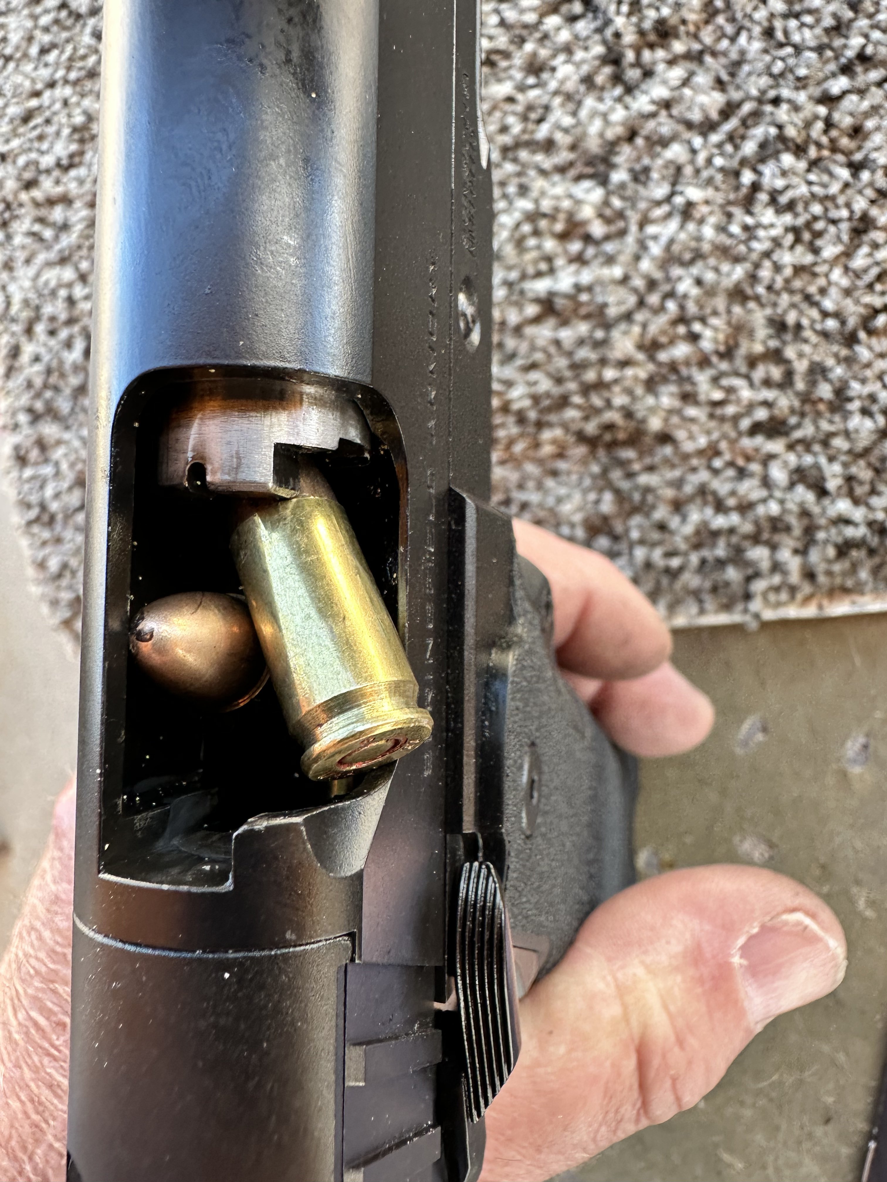

I just sent mine back it was an early ser #1400. I figured there is no reason for me to become an instant gunsmith. SA customer service is awesome. Can’t wait to get it back. Mine was one of those jamming machines. So I suggest unless you know the exact fault and can perform the duties required I would send it to the manufacturer.
I’m not knocking anyone it’s just we paid a lot of money for a product that has a problem. I’d buy a 4.5” to carry if the ftf and ftr are fixed.
Just trying to help. I’ll post after mine comes back and a few hundred rounds!!
