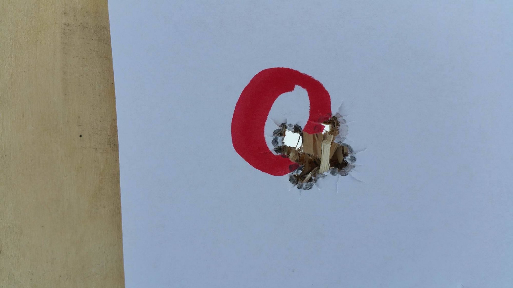

Ballistics is a science unto it's self. I have had a dickens of a time with poly in auto ammo. All the time shave even with an over sized belling of the case mouth. Went to jacketed fixed the problem. Sometimes the bullet can really fly crazy when shaved. Keyhole.

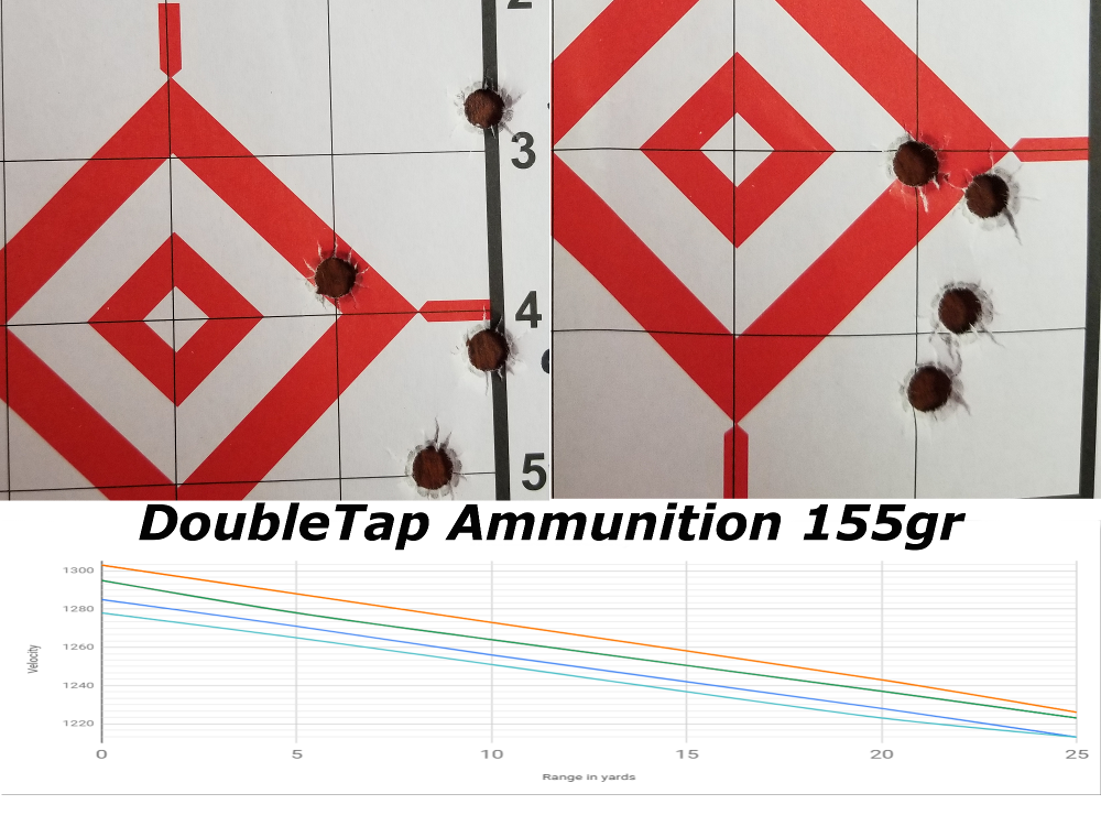

The twist rate has a huge influence on external ballistics. Getting too much muzzle velocity on a fast spinning barrel will destroy the accuracy. Most twist rates are a happy medium and work OK with the happy medium the ammo manufacturers send out. But OK isn't what everyone wants. This was some 10mm ammo I tested with a Springfield TRP 1911 at 25 yards from a vise.
