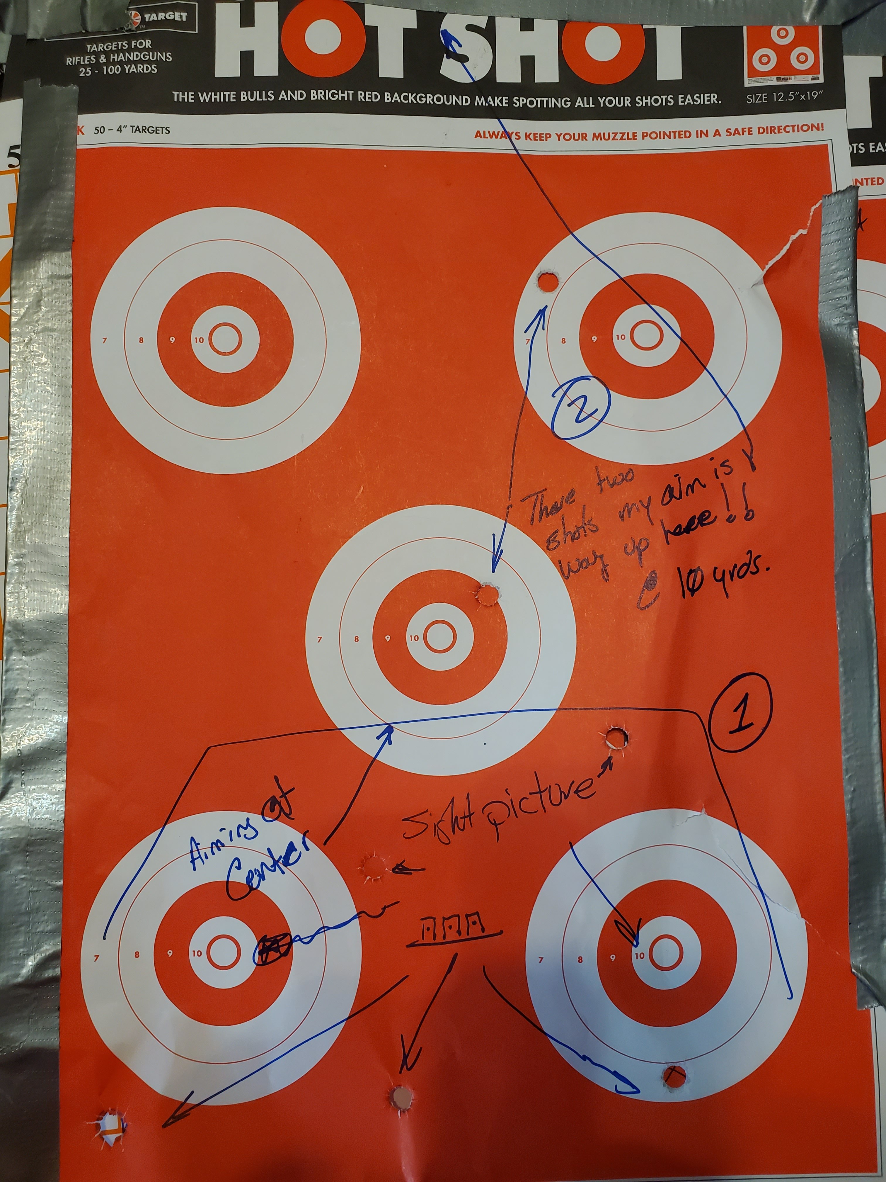

Hello. I'm new here and would like some guidance on an issue I'm having.
Went to the range today with my XDM .45 ACP.
I a little confused with my sight picture. The forward sight had to be way above the rear sight dots. (See photos).
I've never had this issue before, and have been dead accurate since I've purchased it.
What could have changed?

If I align my sights correctly, the shots are VERY low.

It was a high low issue only. If my windage is off it is because it was intentional.

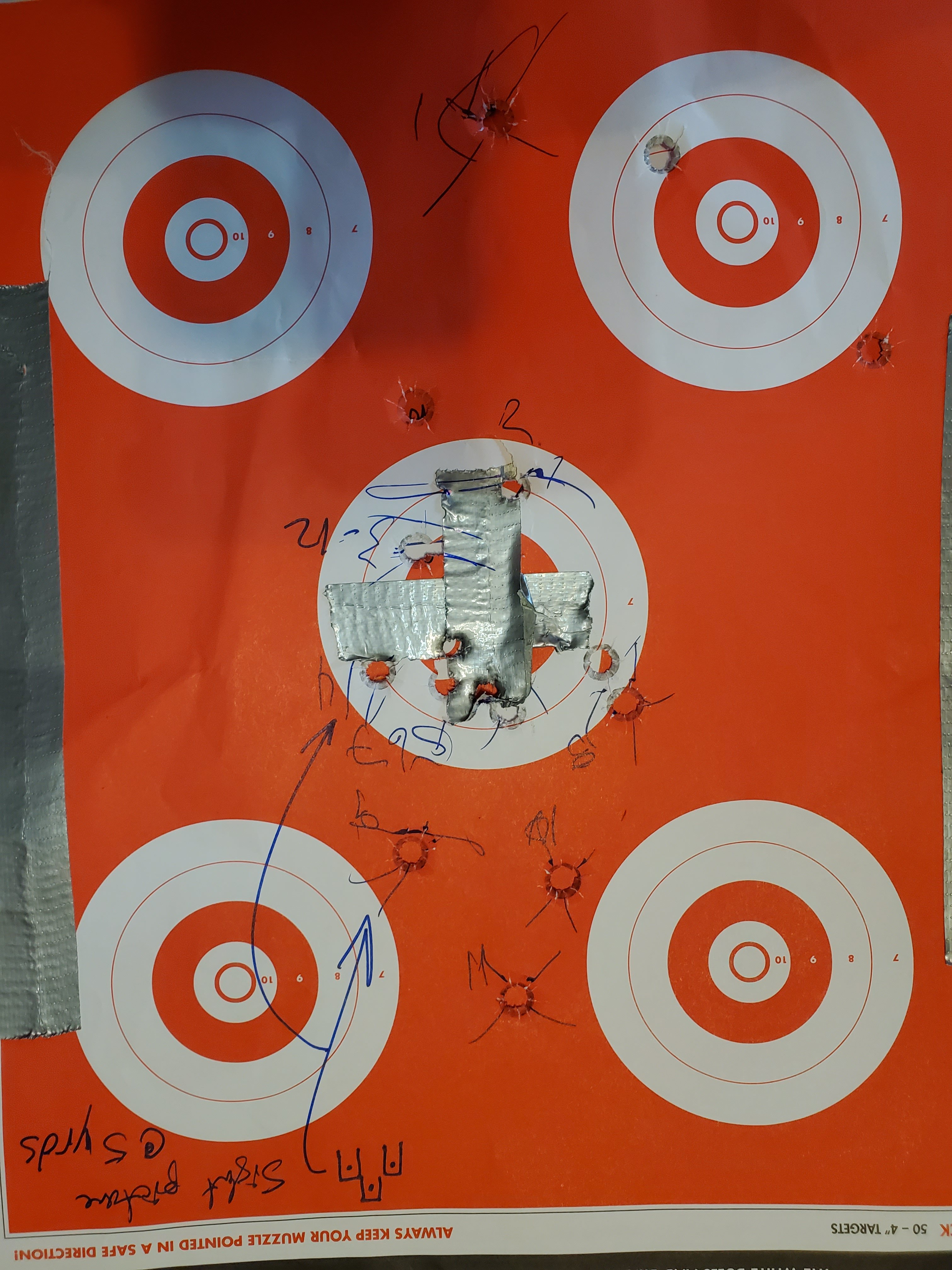

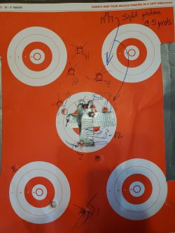

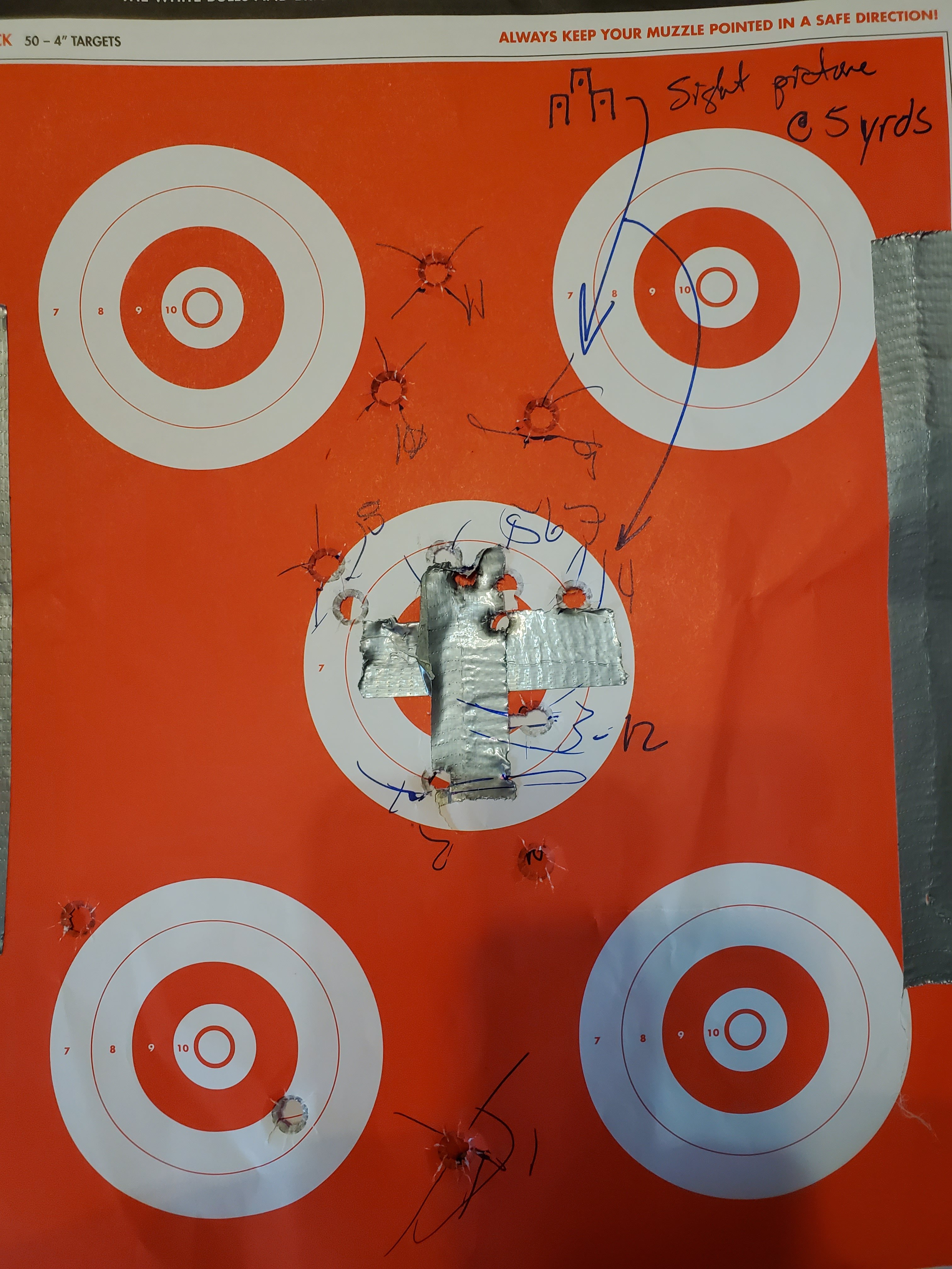

I concur with Keystone...call SA. They are as good as it gets taking care of their customers...looking at your targets and the POI's, something is definitely off. Changing ammo might move you an inch at 5 yards...not 6" inches like your picture(s) illustrate. A pistol wearing over time will change the POI slowly. Since yours changed so quickly, I'm a tad stumped.
Are the groups you get now the same size as the groups it shot prior to the problem? Just that they are in the wrong place? It looks like they might be all over the place...
If you look at the corrected picture I am able to get good grouping, but I am forced to use that modified sight picture. I'm way stumped myself.
