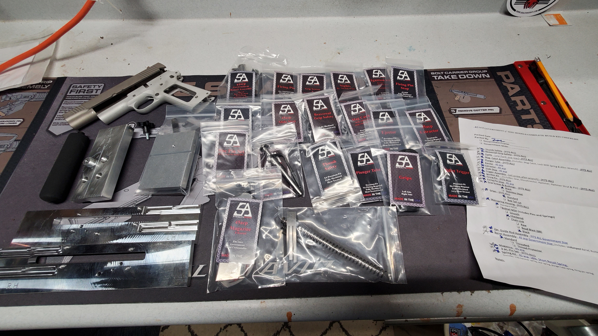

I got started on my final project for the advanced armoring course at SDI.EDU. Over the next three weeks I'll be going through the steps. I made sure every part was here. Stealth Arms makes a very good kit. Pricey, but the quality is really up there.

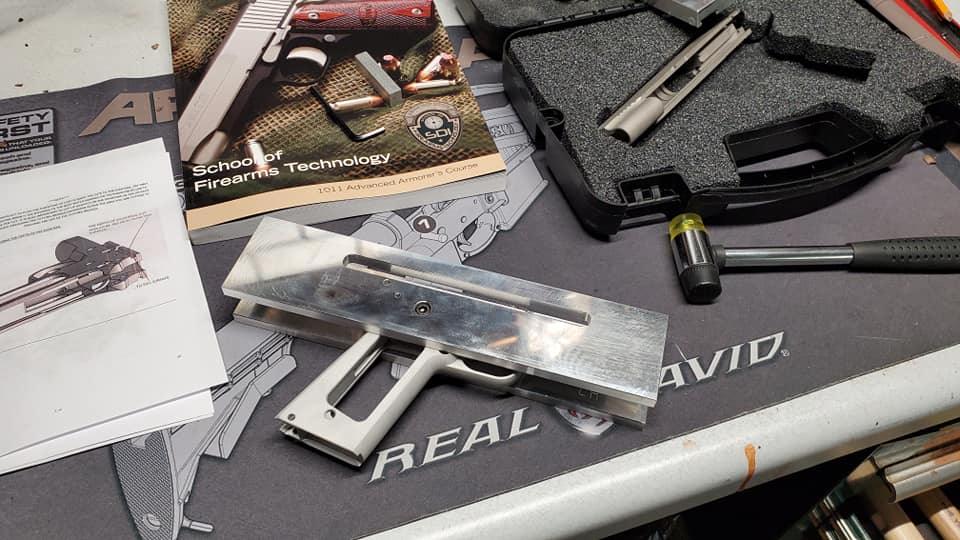

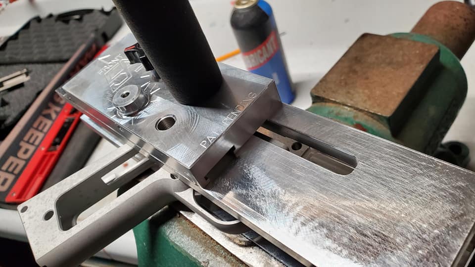

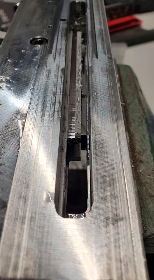

First step after doing inventory was mounting the frame in the jig. The pins were very snug, no play that I could feel between the frame and side plates

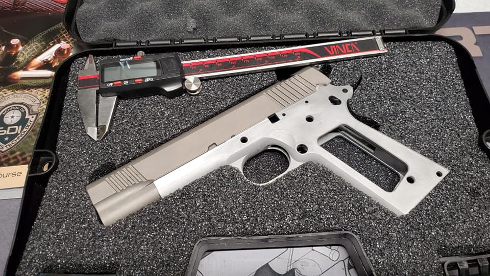

Cutting the guides on both sides was slow. Adjusting the knob with very small movements worked out very well. I also made sure everything was well lubed.

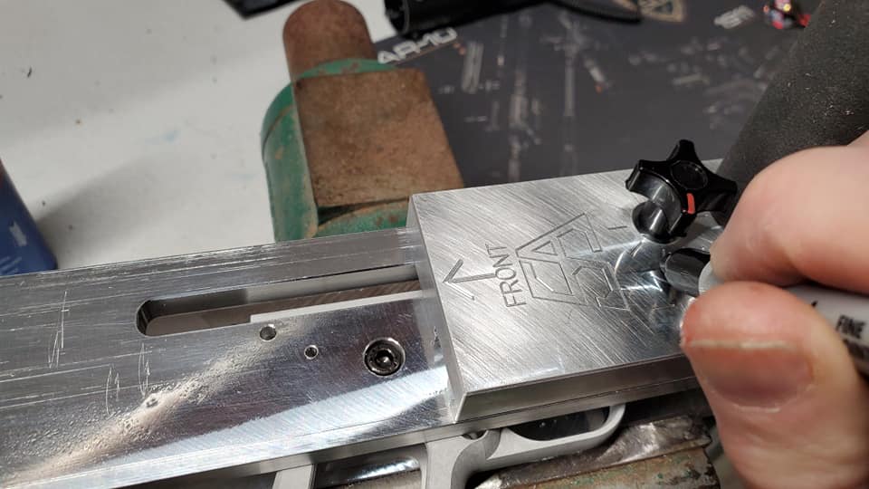

I marked the starting point and cut 1.9 turns giving me a perfect .061" depth.

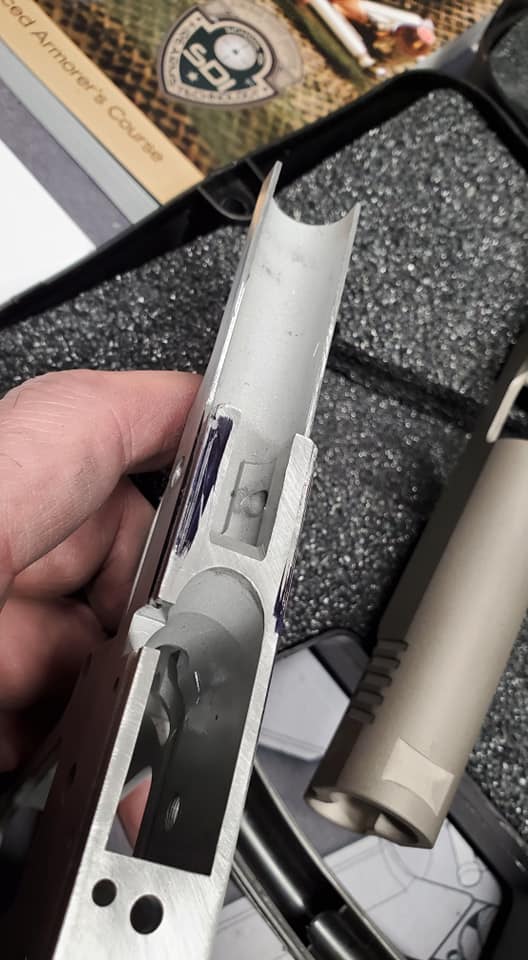

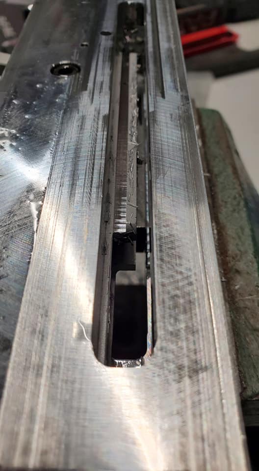

Rails are cut, had a little bit of chatter, but another pass cleaned that up.
Getting a good fit took about an hour. I used a black marker to find my high spots that needed to be taken down. Once I had it to the point I could get the frame and slide together, I used a little 220 lapping compound. The end result was a very smooth fit and no side to side movement between the frame and slide. I've noticed this fit is the difference between an expensive 1911, and a lower budget 1911. The SA TRP 1911 I have is very tight in this area, whereas the other 1911 which comes in at about half the price has play. I noticed this when I was testing these firearms that when the slide came back, the barrel and sights didn't always align the same. I didn't have this issue with the TRP.

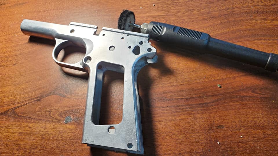

Today I started polishing the frame. A lot of work goes into it. Not sure if I'm going to polish to a total mirror finish, it's going to get a few scratches anyways. So far, everything is really very easy. The millwork is far less involved than on an AR receiver. But all the little stuff is starting to add up in time. I spent about three hours of polishing. Started with 400 grit wet, then 800 grit wet, finally, 2500 grit wet. Switched over to the dermal and hit it with 220 grit lapping compound, then rubbing compound. Safety first, right? Need to protect the eyes and the beard. If you've never got your hair caught in something spinning, consider yourself lucky.

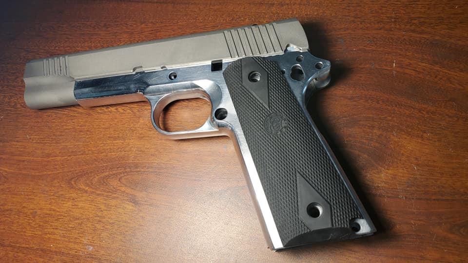

I haven't decided if I'm going to polish the slide or leave it two-tone like this. I'm kind of leaning towards two-tone

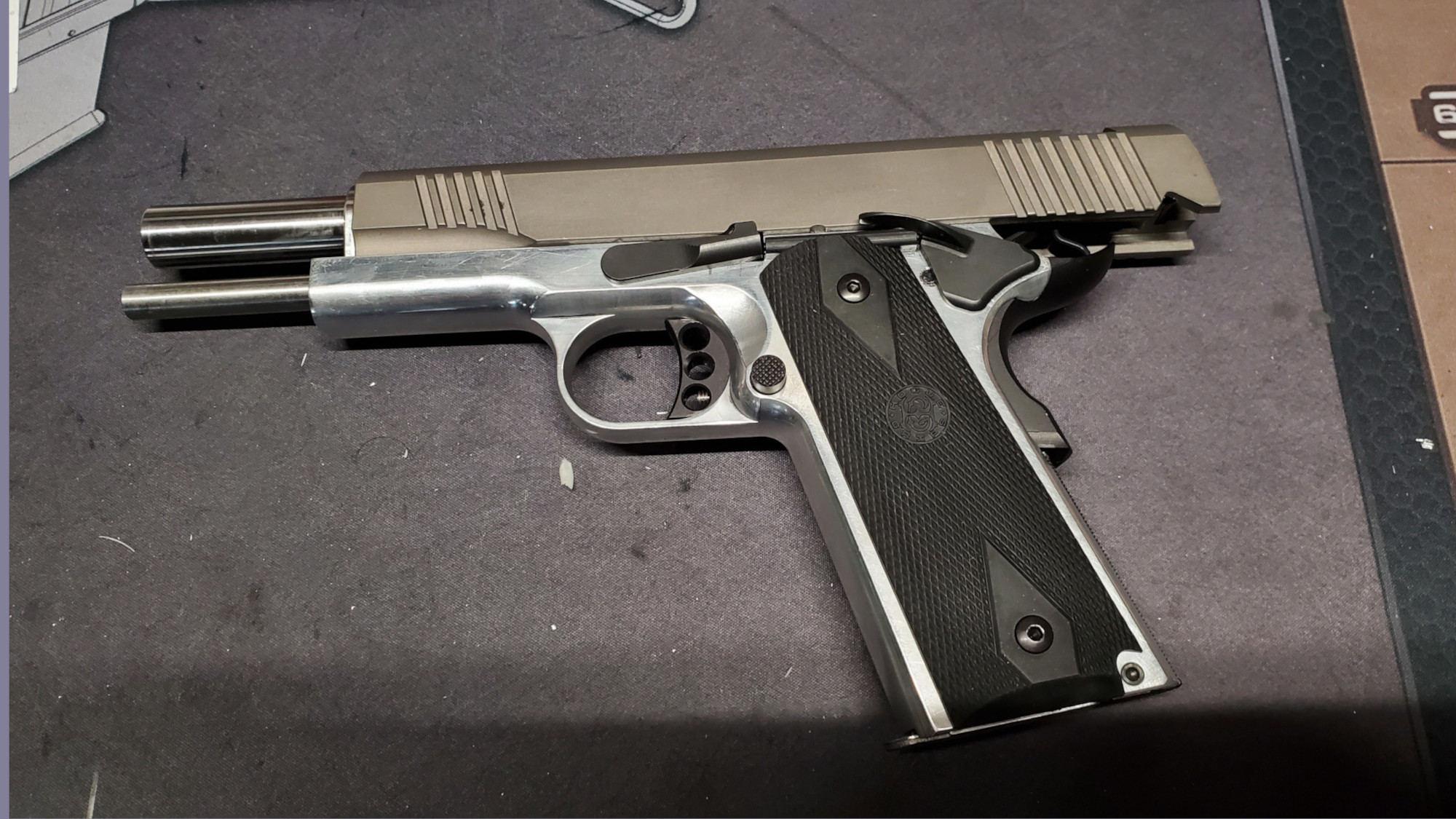

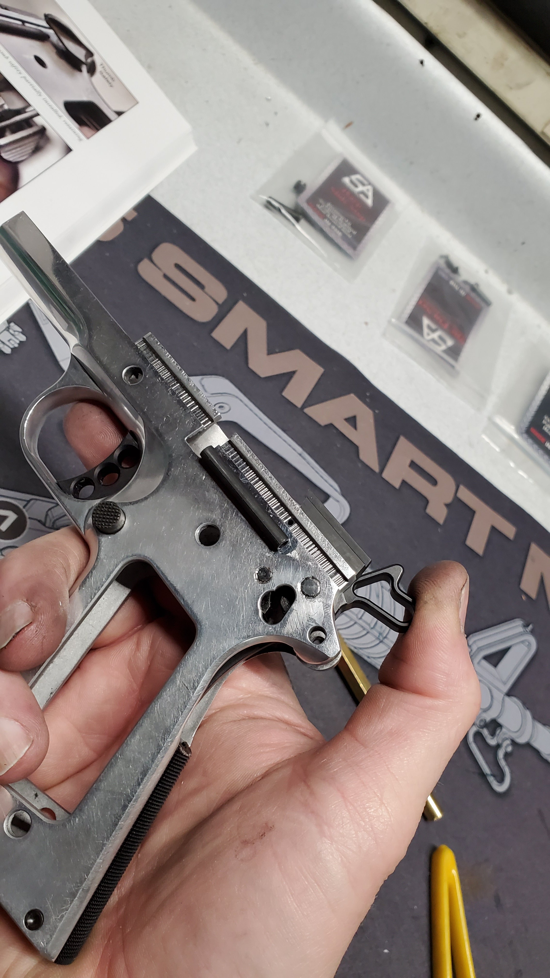

Got a lot done yesterday on this build. Here I installed the plunger tube, extractor rail, trigger, mag catch, and the hammer
Now, the safeties, this was a major pain and took me about two hours. The thumb safety needed a little filing, this was expected and was mentioned in the instructions. So that was a few strokes of the file and put it back in until it worked correctly. The grip safety however, that drove me crazy. If I put the grip safety in by itself with a drift punch, it worked, as soon as I put the thumb safety in, nothing worked. I must have read the instructions a dozen times. Finally I broke down and went to YT and found a video. The guy mentioned the same problem I was having. I had to file a very small amount off of the grip safety and that was it. All works now.
Function checked and everything works. Still need to test fire. But first I'll be taking it all apart again to clean everything up and get a better polish on the frame.
