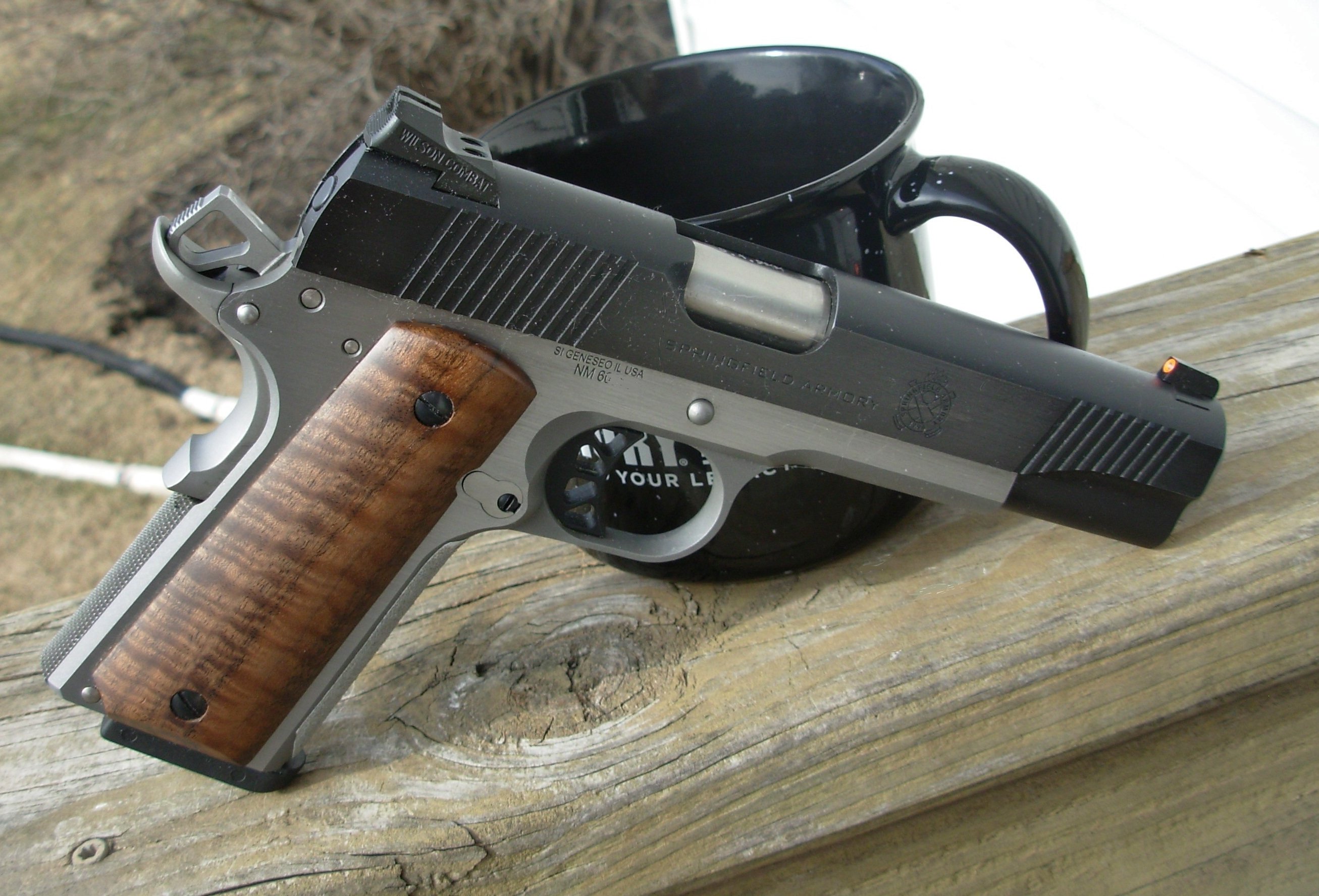

Contact Springfield and ask them. They changed the sights on my Ronin and the cost was reasonable.

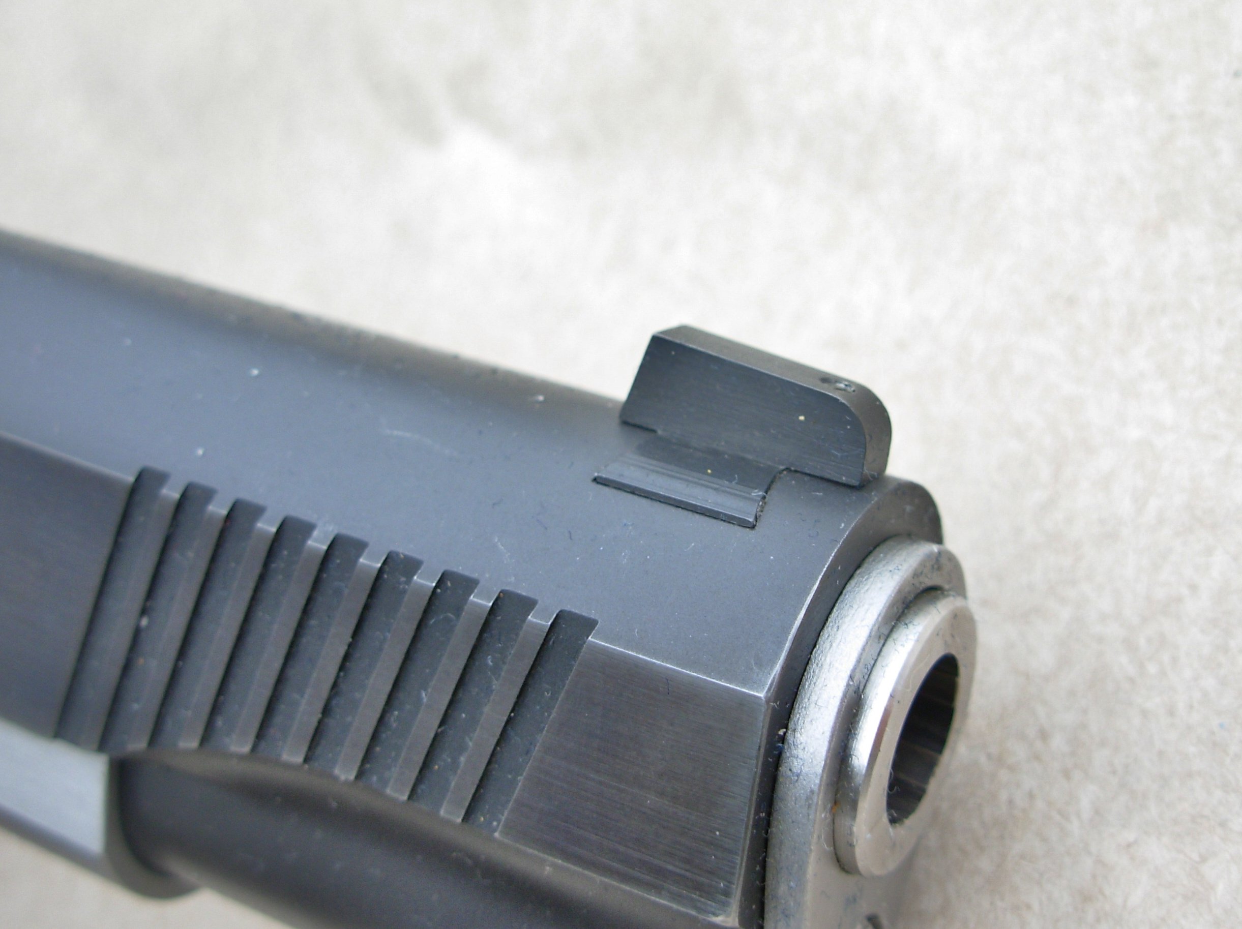

Springfield Armory 1911 pistols use a Novak-style cut for the rear sight and a proprietary 60-degree cut for the front sight.
Rear Sight Cut
  • Type: Novak low-mount style.
  • Details: Most modern fixed-sight Springfield 1911s (like the Garrison or Loaded series) use a Novak-pattern rear dovetail cut. However, some adjustments or light filing may be needed because exact dimensions can vary slightly from authentic Novak specs.
  • Adjustable Sights: Models with factory adjustable sights (such as the Range Officer or Loaded Target) typically use an LPA style cut rather than a standard Novak.
Front Sight Cut
  • Type: Proprietary Springfield 60-degree dovetail.
  • Details: Unlike standard 1911 front sights (which often use a 65-degree angle or a GI-style stake-on), Springfield uses a unique 60-degree dovetail angle that is deeper and wider. To avoid extensive filing or modification, you should buy front sights specifically labeled for Springfield cuts.

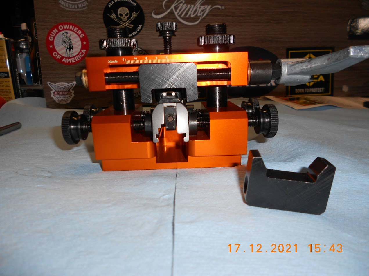

Or buy a quality sight pusher.
I've lost count on how many I've installed with hammer and punch. Quality sight pushers are getting much cheaper AND much better in execution.
yes, that too
i got the Lyman sight pusher, from Lyman themselves, it was cheaper than Amazon, and believe me, any of the gun parts websites like MidSouth shooters, Midway, Natchez, etc.etc.
just keep those turn screw threads WELL lubed at all times...!!!
Hi,
Rear Sight Cut
Front Sight Cut
Does this information apply to the Ronin too? Thanks!
Yes; it also applies to the Ronin.
My turnaround was approximately three weeks and if you ask they will supply a fed-ex label at their cost which is easier and cheaper than shipping it yourself.

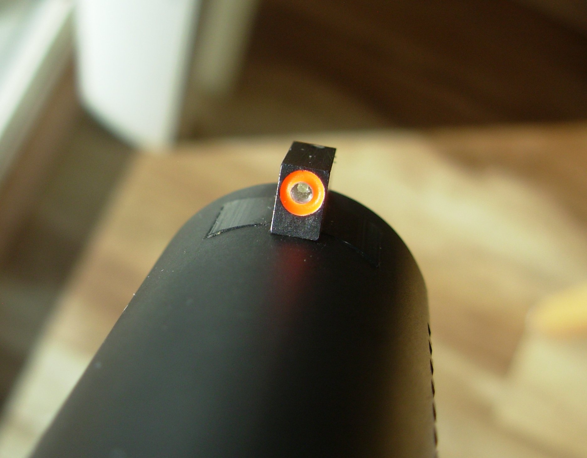

an alternative to purchasing a new sight is to get a bottle of Testors flourescent Orange paint and a toothpick. Apply and let it dry overnight. You can black out the rear sight for a great contrast combination. You don't even have to have the sight removed.

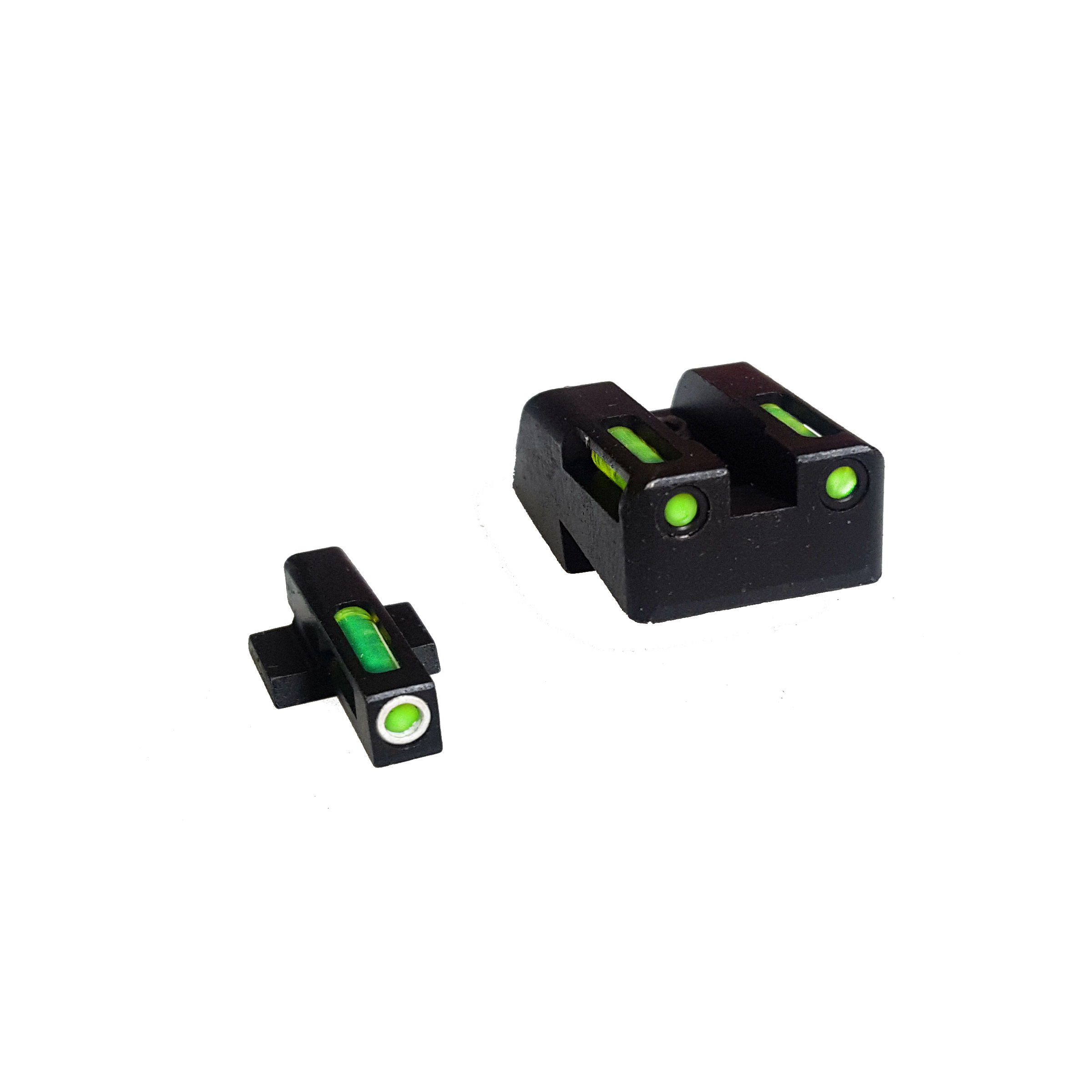

Harrison Design, Dawson, Trijicon, Ameriglo are aftermarket sources for dot sights and/or night sights. You have to decide on a contour base or flat end base front sight style , both shown above.
