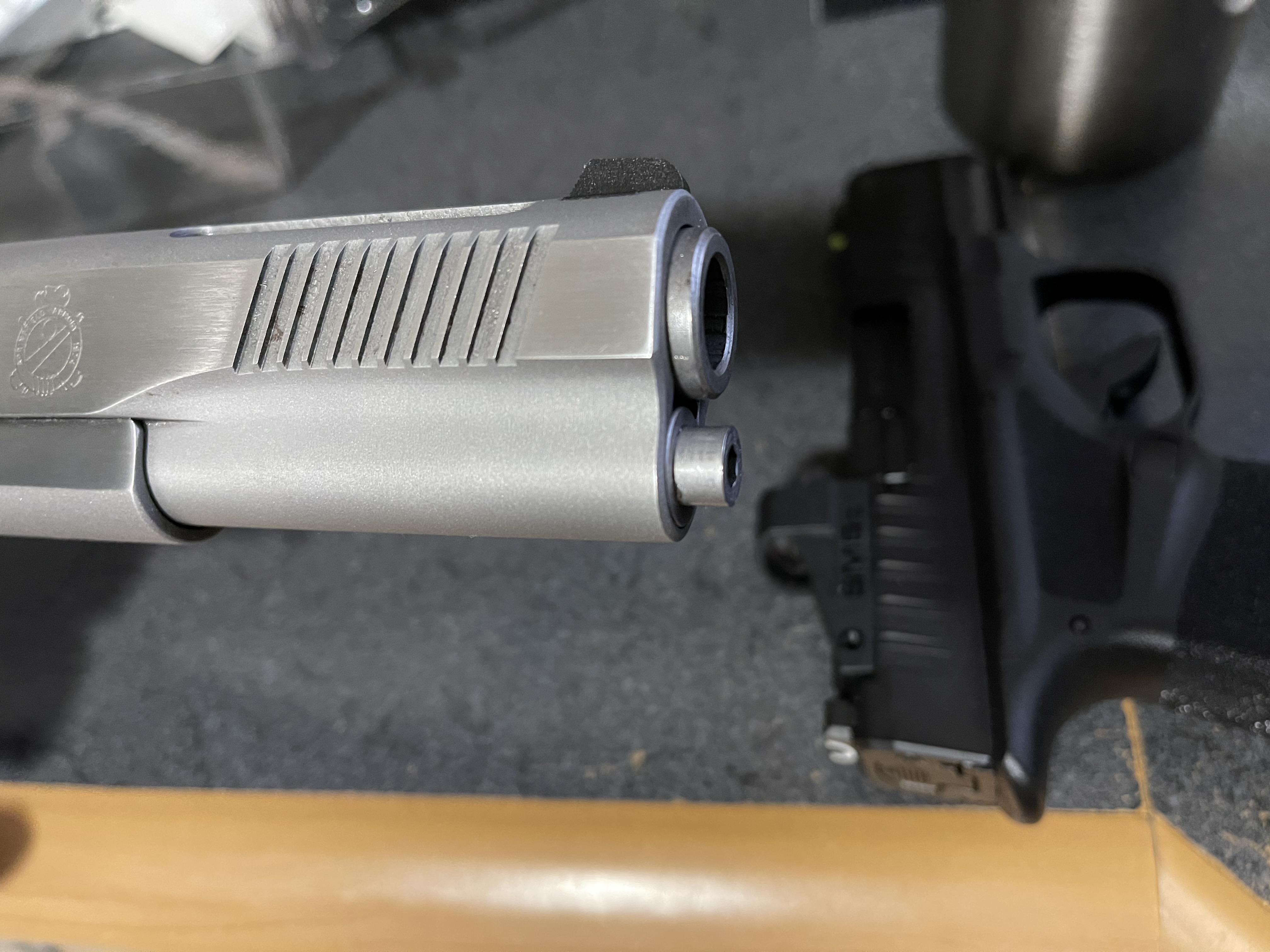

Never fired, stored gun of that age? Personally, after getting slide free from what seen, there appears to be crack inside sidewall above top of magwell looks to be very suspicious and out of whack. Also appears to be other things out of alignment as well around cracked frame. Many things can happen over 10 years or so? Dropped hard? I'd consult a good local gunsmith to better check out gun visually about your situation before attempting to actually use it. From there, right now? You have some good pics, that may help?

Don’t see where you see a crack, I see the machine mark where the feed ramp meets the side of the frame by the slide stop, but can’t see any crack.....🤔🤔🤔🤔

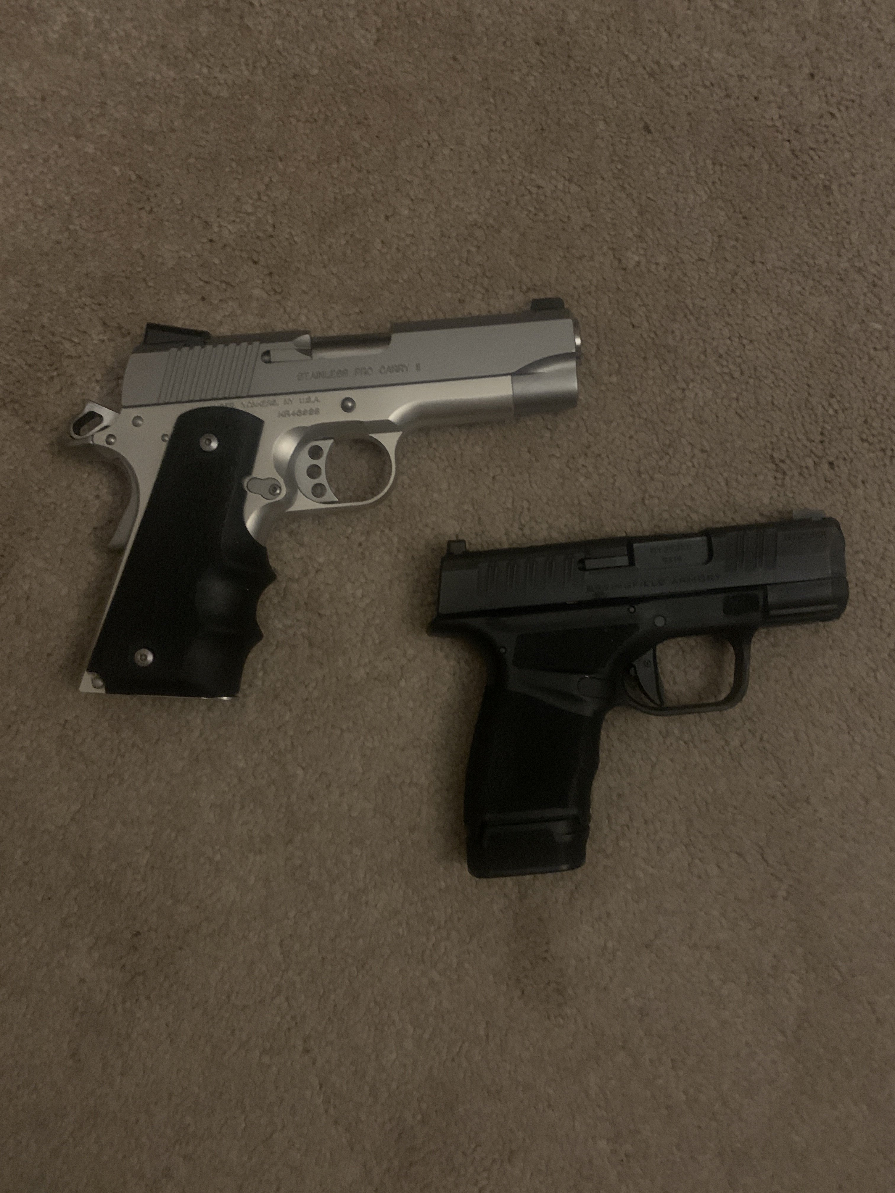

Yes sir! Decided to start carrying with all the craziness going on. That’s the gun that got me to try shooting the 1911.

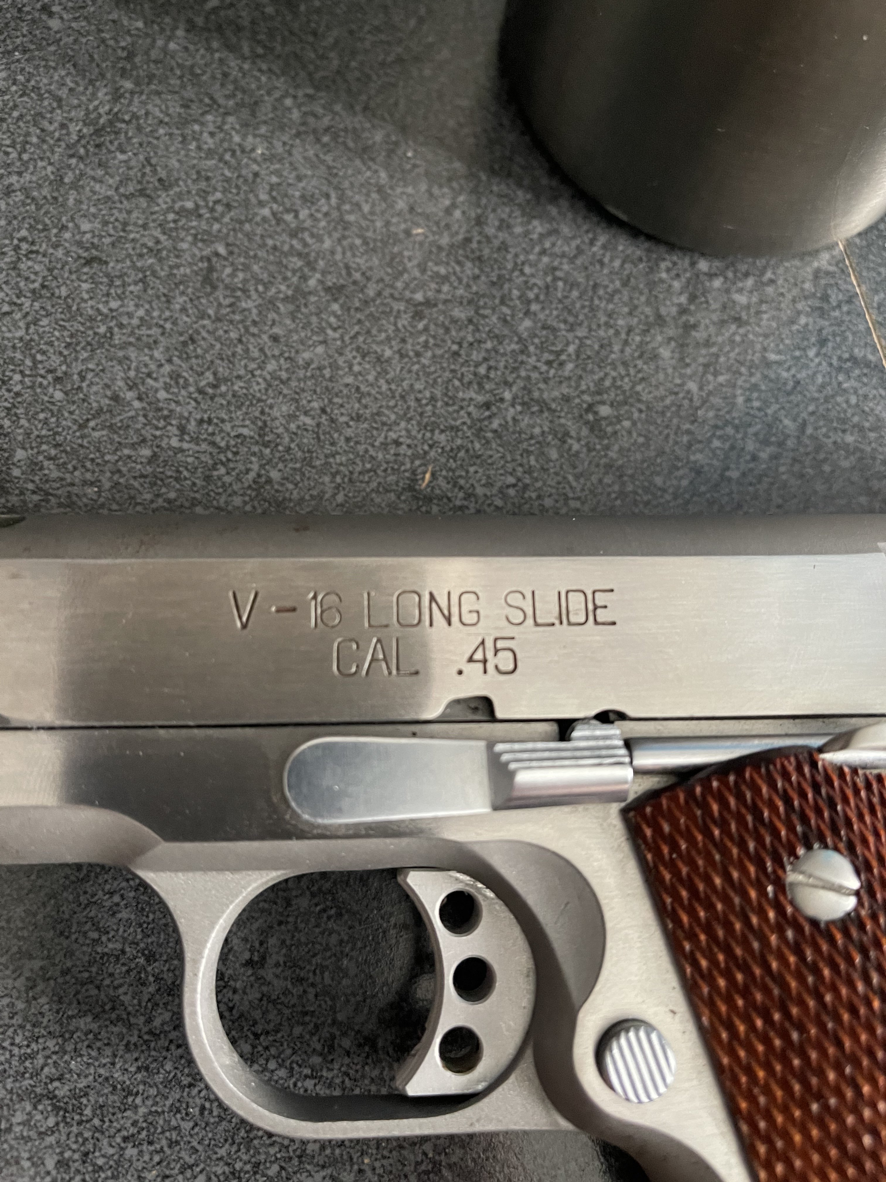

Hello, I have a V-16 that has never been fired but I was about to take it to the range. Racked the slide and it stuck. It's unloaded with no clip. Not sure how to get it unstuck!
Is the slide stop all the way in like it’s supposed to be, can you move the slide at all?
Took the gun to the Gunsmith and got a 20 dollar education. The slide stop was not all the way in like annihilator had questioned. The gunsmith tapped it back to the disassembly notch and and pressed the slide stop back in which released the tension. In the second picture you can see the button is pressed in but it should be much further out. Good news is no crack and the pistol is in good overall shape. Has some rust! I'm going to break it down this weekend and clean it thoroughly! Any ideas to remove rust???
Was going to send you this yesterday, but kind of figured you'd have checked to make sure the slide stop was pushed all the way in. Apparently, this issue is common with a lot of 1911 models. After trying to make it happen several times with my Kimber Pro Carry 2 1911 several times, I made it happen. Hope we can all learn from this. It doesn't take much. If you put just a little bit of pressure on the right side of the slide stop pin, it will jam up. Put too much on it when racking the slide, it comes all the way out. Who would have thought??
