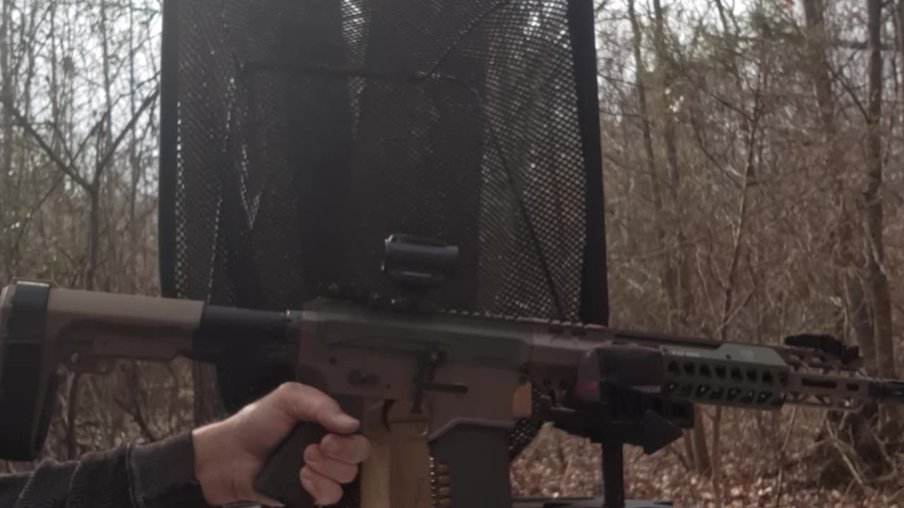

Ive put together a lot of .300blk pistols and rifles.
Awesome! I've done a lot of 5.56/223s in all sizes and shapes. Sounds like you have quite a bit of hands-on 300 BLK experience.
If you don't mind, could you share your "worst experience ever" in putting together a 300 BLK and having issues getting it to run? I realize that you might not have had such, but everyone I've talked with who has put together more than a few of them has at least one horror story of the frankengunfromhell that would not yield to their ministrations.
Yep

I haven't encountered any problems with .300blk builds before. I typically use mid to higher grade parts in my builds also to avoid tolerance issues.
Ill have to check the 16" i have, but I'm fairly sure it's carbine length
I was just reading some stuff online and carbine length gas system barrels can be found and typically work fine for .300blk but can have issues under 16in. The 16in barrels I've used are all pistol length gas systems. These 16in barrels are Wilson, BA, and Faxon and maybe one or two more different brands.
