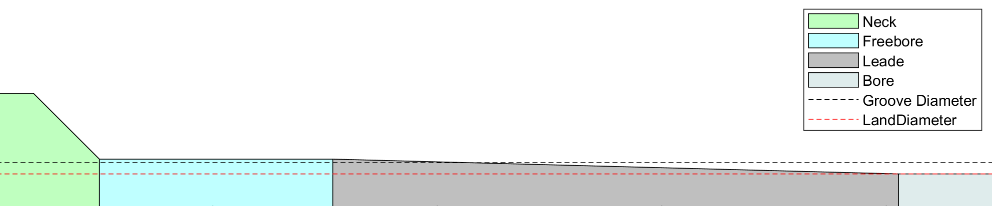

"Chamber dimensions and rifling twist vary among the myriad AR-15s and bolt rifles barreled to .223, but the 5.56 commonly gets a longer throat. “Roughly .125 more freebore,” say the white-coats bearing micrometers."

My Ruger Mark II with a .223 barrel doesn't like 5.56 ammo. To close the bolt takes a lot of force to close, telling me that bullet as hit the the rifling. Not good for the barrel. All ammo used was factory ammo.

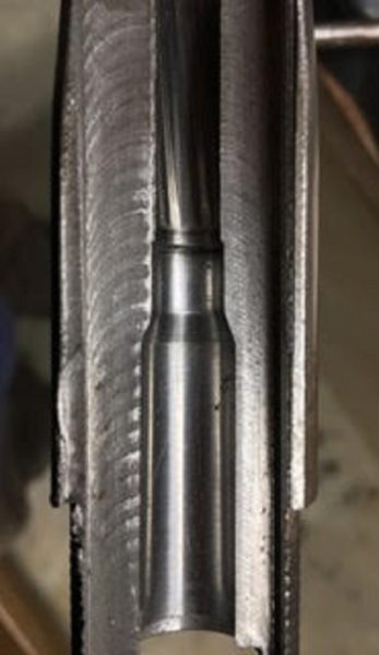

Not all manufacturers of bolt guns cut identical chamber throats in their hunting rifles.
Rugers are notorious for having tight throats (aka freebore) , and Weatherby is known for having generous throats (free bore). On custom guns you can specify the depth of the throat.
Chamber Throats 101
A gunsmith can cut a deeper throat with a throating reamer.
Sectioned barrel chamber area

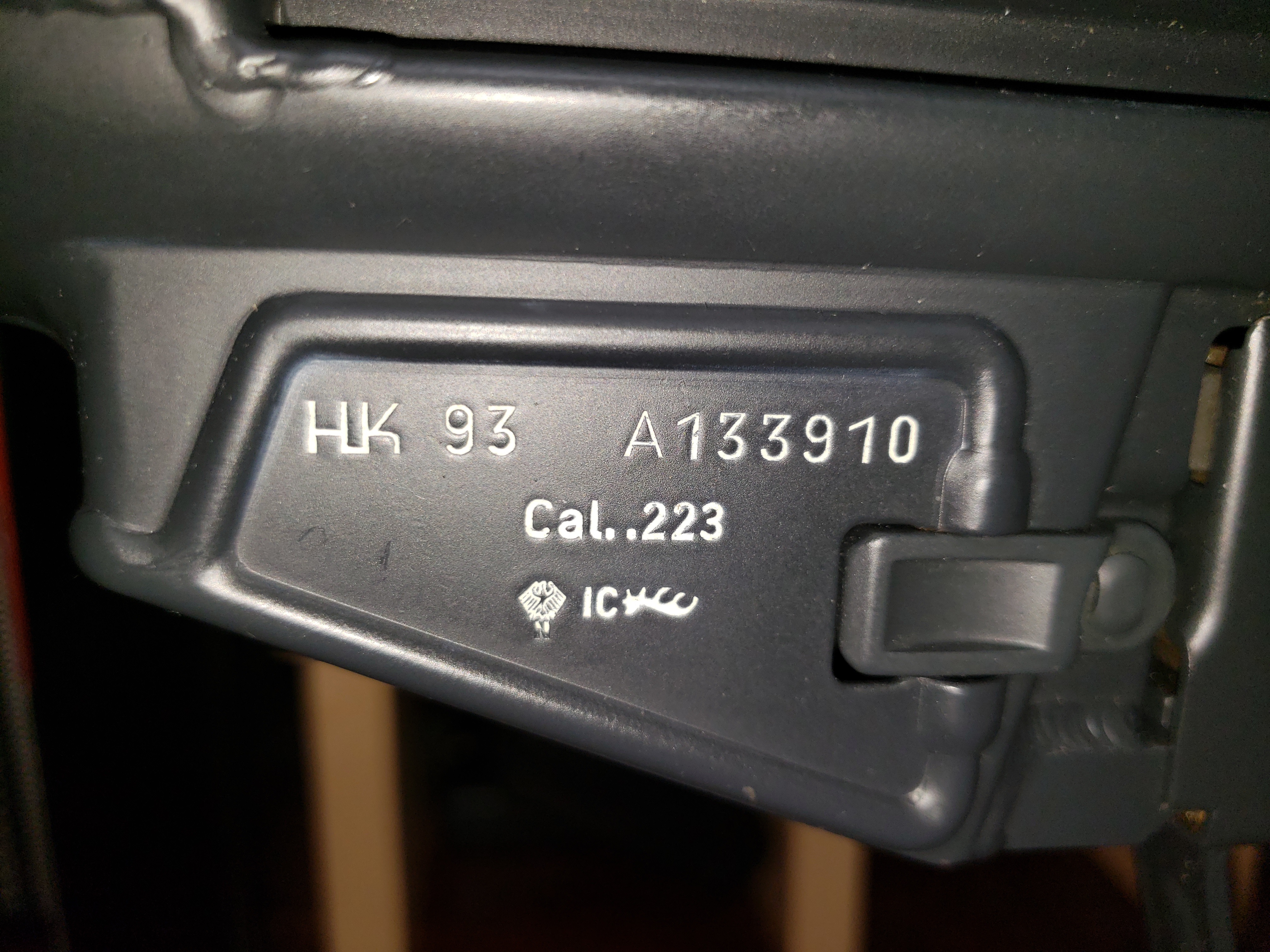

Here a picture of my H&K 93 the lower is marked 223 because in importing rifle was getting harder by the day. No more evil 5.56 guns imported into the USA and this Rifle in from 1982 one of the last years for this rifle. Loves M855A1 diet
Chamber Throats 101

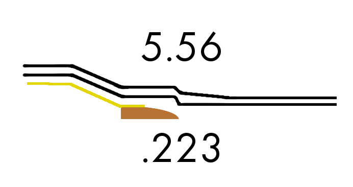

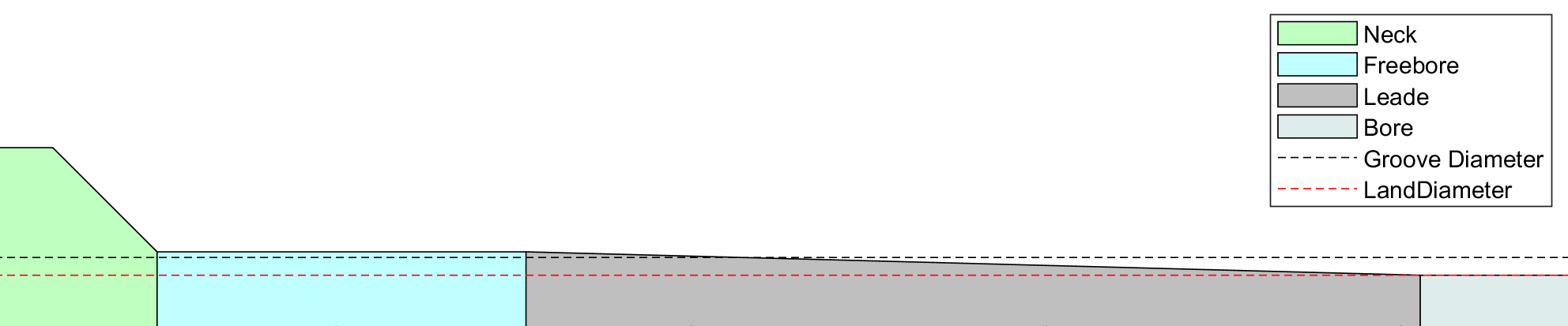

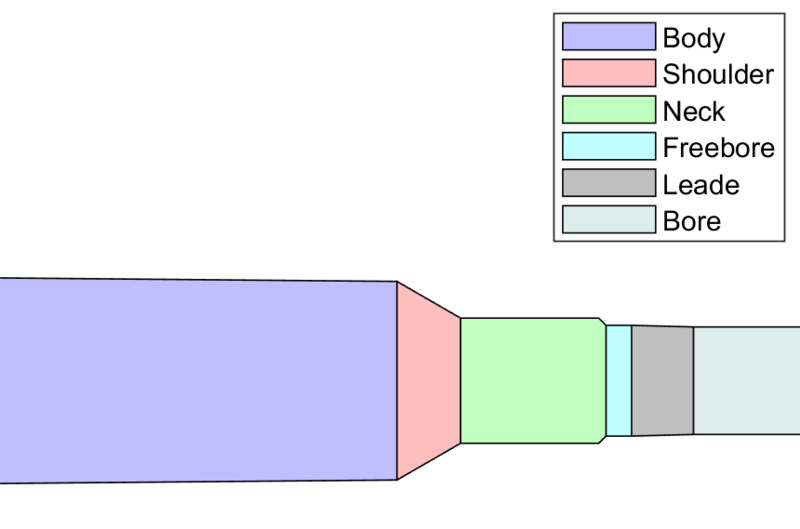

In a Wylde chamber the throat is cut deep enough to accomodate both 5.56 and commercial .223 specs. As you can see the differences are minuscule.
