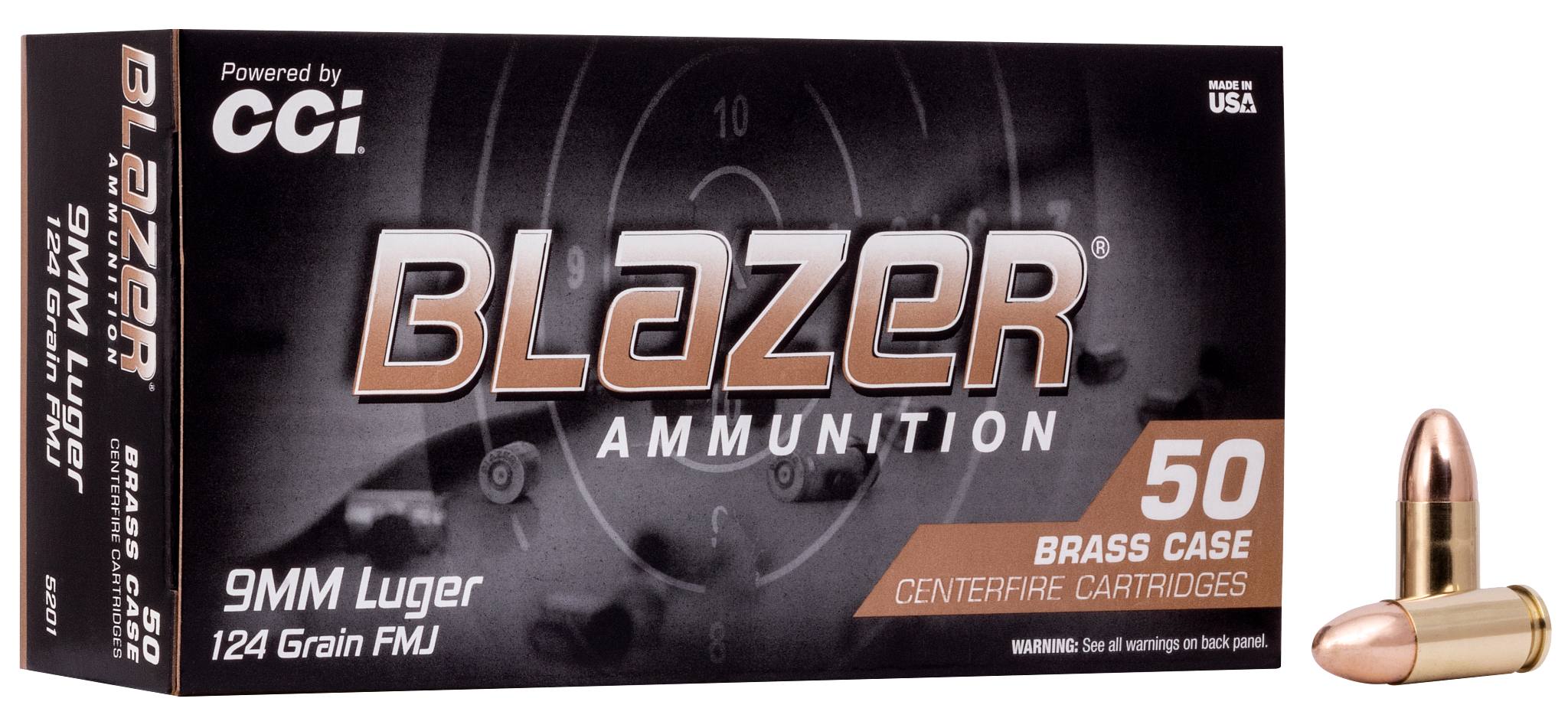

I have run most major brands and some lessor brands of fmj ammo and landed at Blazer Brass.
90% of above count has been Blazer Brass in both 115fmj and 124fmj. Both accurate enough for range PRACTICE.
I have found that if I coat the inside of the comp with Slip 2000 EWL30 before range session, all it takes to clean comp is a few minutes (5 minutes) at most with a brass scraper i crafted from a 1/4" brass rod from hardware store.

Hi,
According to CCI's website, their Blazer Brass 9mm is not recommended for comped or ported barrels...
I use a lot of S&B, some Winchester NATO, and recently Remington and PPU, whatever I can get for the best price. I use BB in my non-comped pistols.

The port / comp is well in front of the rifled portion of the barrel and the opening at muzzles end is plenty large. Non-issue for a range / compitition gun. Thank you for your response @BassCliff.
I'm not a high volume shooter, maybe 500 rounds/month of 9mm and about the same of .45acp.
Thanks Cliff… didnt know this on Blazer 124 and comp barrels 😵‍💫😬
Hi,
I was unaware until someone here pointed it out. Seems the bullet can lose bits of its plating when leaving the barrel and cause damage to any soft tissue in the vicinity. I'd have to search for the thread. That warning is for 115, 147, and other weights too.
