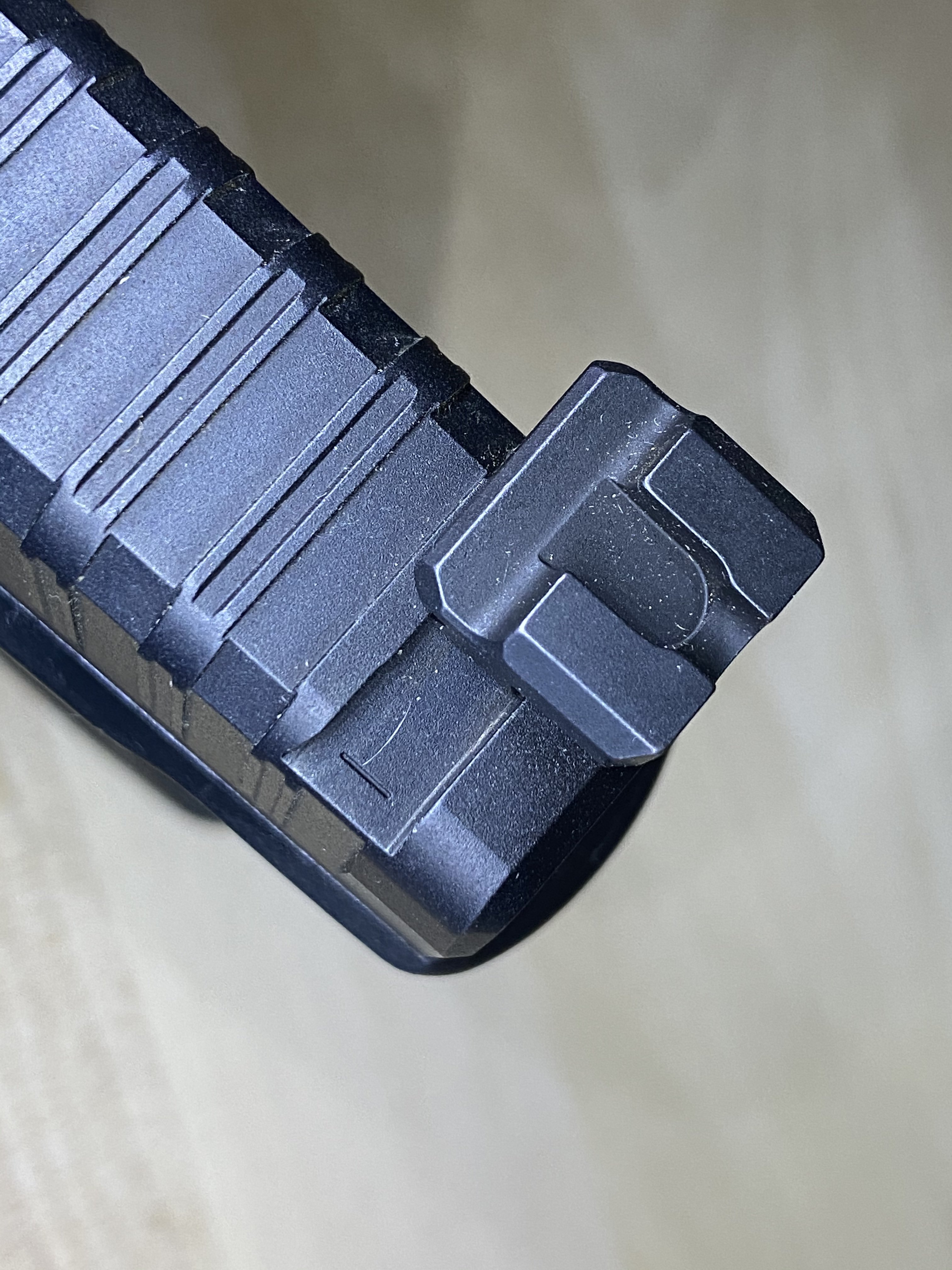

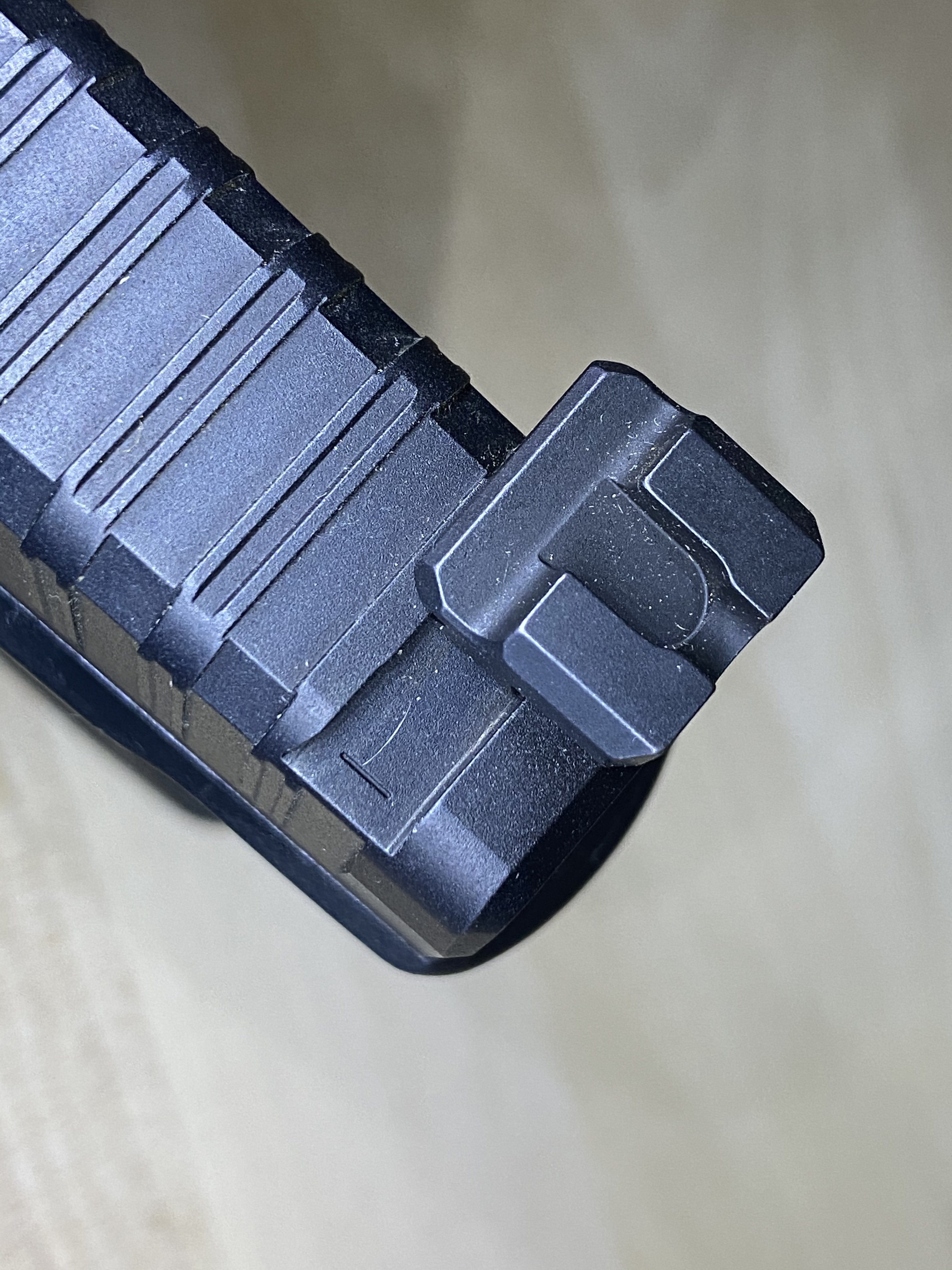

It's hard to see just how much "off center" your rear sight is actually 'off' from the pictures, but the marks are simply a reference to see visually where the sight is located and not a definite locating point. I'm just suggesting to give the gun every benefit of the doubt before making any changes. When my Hellcat came to me it was dead on accurate at IIRC 15m's. The sight is pretty close to centered between the two 'tell tale' marks, but if looking closely one can see a very slight difference one side to the other.

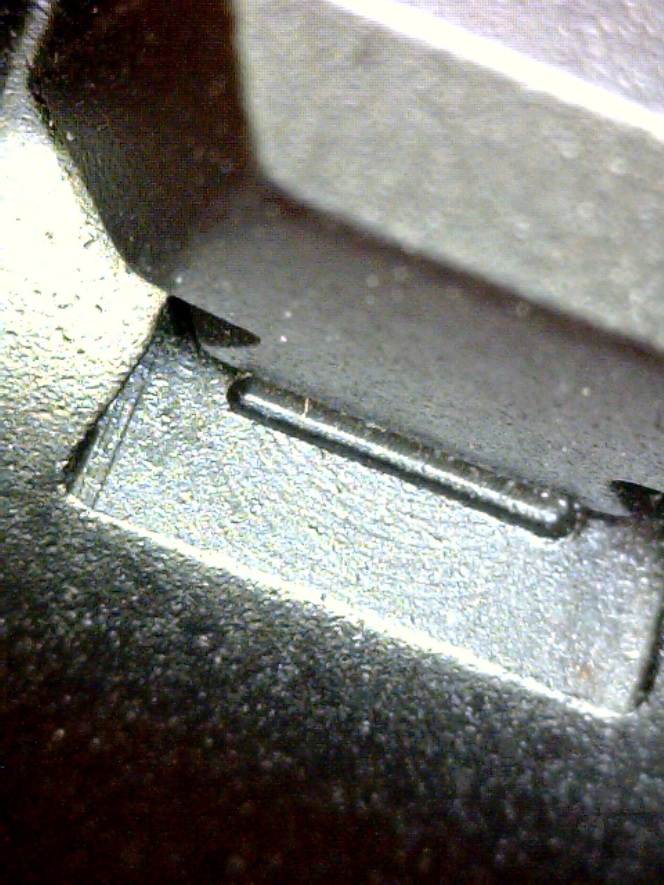

When I got my new gun and was setting up the red dot, I noticed the front post was off center. Being crude and old fashioned, I got out my little mallet and a brass punch and gently pecked it to the right until it looked centered. I put a bit of blue loctite in front of the edge that would run on to it to keep it in place.
Now I find out about these marks.. I got my gun out and using some magnifiers took a look.
There they were, front and back. It's right on the money.

New, kind of Hellcat owner here. Found this thread looking for ways to adjust my POI like many of you my group is about 3” to the left at 15 yards. Looking at the witness marks the left one, looking from the rear of the gun, is completely covered and the right one is completely exposed. A little quick math and some calipers say the distance is about what I’m seeing to move to the right visible wInness.
