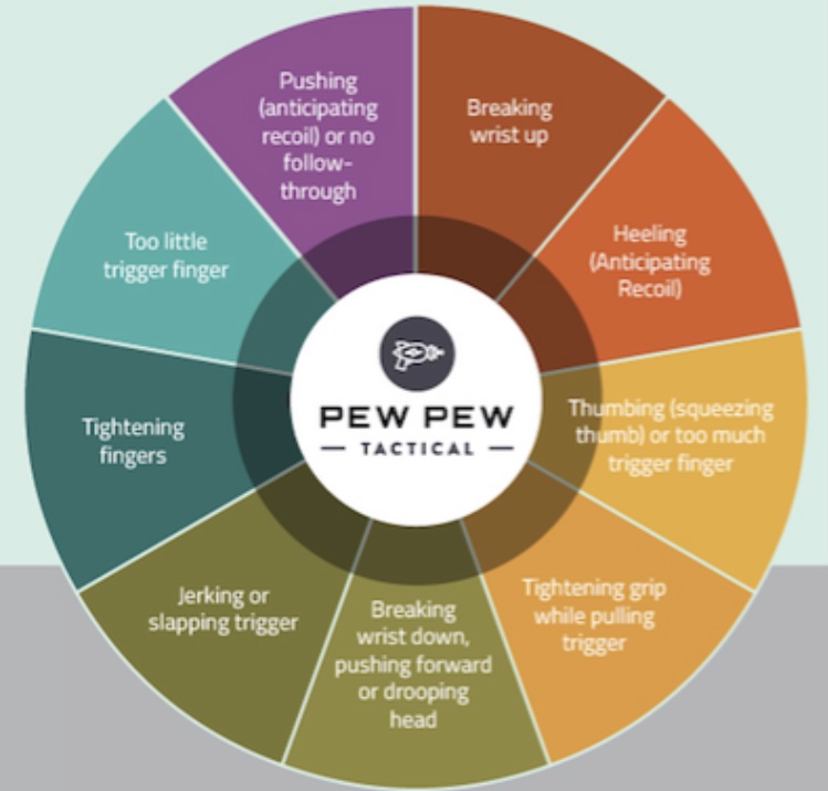

I had the same problem low and to the left. I had a retired deputy and firearms trainer monitor my shooting and shoot the firearm himself.
Tough pill to swallow but as good as I thought I was , the problem was in fact me. I have grown accustomed to the wall and break of glocks. Check with your local trainer and have them observe you and try it themselves.
This little chart may help you as well. If after all that and it is still off contact Springfield.
I hope you get it figured out. You need 110% confidence with a tool that your life depends on. Best of luck.

I always shot low left, I found out that I was jerking the trigger leading me to cant the gun some, I usually only have this issue with the smaller guns, I am good at doing this with my S&W Shield, with my G26 and my new Hellcat, not as bad with them.
Use a combat sight picture if you are using a 6 oclock hold. The Hellcat line up your sights even, but cover your target with your front sight. The front sight should be hiding the bullseye. This will raise your impacts.
Well... I have bought a bore laser (G-Sight 9mm Luger Training Laser Cartridge Gen 2) for $40.
So my OCD was satisfied... The laser flashes are really close to the aiming point of the steel sights, just a tiny bit to the right (rotating the laser in the barrel doesn't change that).
So all the lower grouping is just because me slapping the trigger? Even when I try to press really slowly?
The Sig doesn't do that because probably has better trigger?
