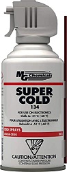

Can you hit the brass with a freeze spray to shrink it a little?
MG Chemicals - 403A-285G 403A 134A Super Cold Spray​

Can you hit the brass with a freeze spray to shrink it a little?View attachment 19953
