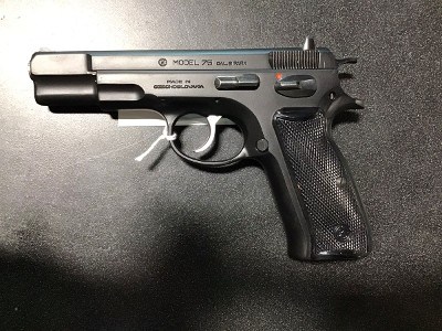

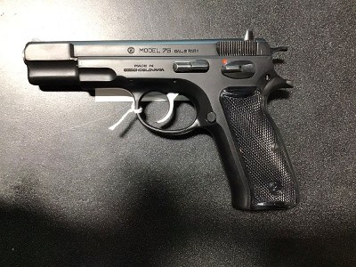

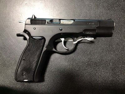

I like the old stuff. This one was made in 1990, and is used but looks near mint. It would be my first CZ handgun if I cave.
If anyone has experience with this model, would you recommend it for accuracy and reliability? Thanks!
If anyone has experience with this model, would you recommend it for accuracy and reliability? Thanks!View attachment 109913View attachment 109914
The classic CZ-75. reliable & accurate as a service pistol.
A nice looking "pre-B". Made from 1980-1993 and replaced by the "B" model, that's still in production and it's variations.
"Pre-Bs" have different mag well dimensions compared to the current "B" model and it's variations, so "B" mags won't fit in a "pre-B" properly. And...
The CZ 75 PRE-B MAGAZINES HAVE A SQUARE CUT NOTCH IN THE REAR OF THE MAGAZINE TUBE BEHIND THE FOLLOWER. THE CZ 75B MAGAZINES HAVE A MORE U-SHAPED CUTOUT. CZ 75 PRE-B MAGAZINES WILL FIT AND FUNCTION FINE IN THE CZ 75 B. THE CZ 75B MAGAZINES ARE A LITTLE WIDER AND WON'T FIT PROPERLY IN THE CZ 75 PRE-B. THE CZ 75B MAGAZINES ARE A LITTLE WIDER AND THEY WILL BE TOO LARGE TO INSERT INTO THE MAGAZINE WELL (TOO TIGHT OF A FIT).
Besides the originals CZ made "pre-B" mags for awhile then discontinued them.
But, Greg Cote has these that fit a "pre-B".
I like my pre-B but don't shoot it due to it's collectability. CZ has made "B" models (the past limited-production "Retro" and the current Anniversary "Legend") that resemble the pre-B 's on the outside but are "Bs" inside.
If you want to collect the pre-B that's fine, but if you want to shoot it a lot you'll need the above mags & it would reduce its collectability.
If you wan

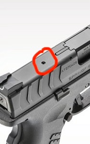

The XDm also has a roll pin that stops the firing pin, it to can wear if you dry fire them a lot without snap caps, and on the Beretta 92, you shouldn’t dry fire it extensively or it to will mess up the firing pin since on them, there actually a 2 piece system, my suggestion is if you dry fire any gun, use snap caps, relatively a cheap insurance

The XDm also has a roll pin that stops the firing pin, it to can wear if you dry fire them a lot without snap caps, and on the Beretta 92, you shouldn’t dry fire it extensively or it to will mess up the firing pin since on them, there actually a 2 piece system, my suggestion is if you dry fire and gun, use snap caps, relatively a cheap insurance
yes, i think you, me and a couple of others have ALWAYS said..."use snap caps"
cheaper then buying firing pins.
If you wan
Great info! Thanks. I did find a few actual pre-B CZ mags for sale, and are very expensive.
