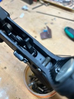

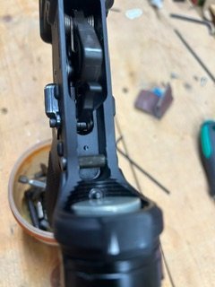

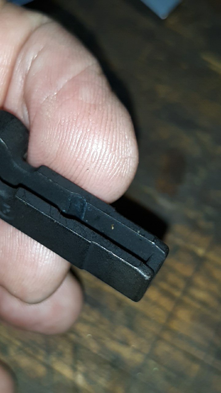

Oh damn I think I figured it out. I have a high Shelf in this lower. Is this something I can fix with a dremel?

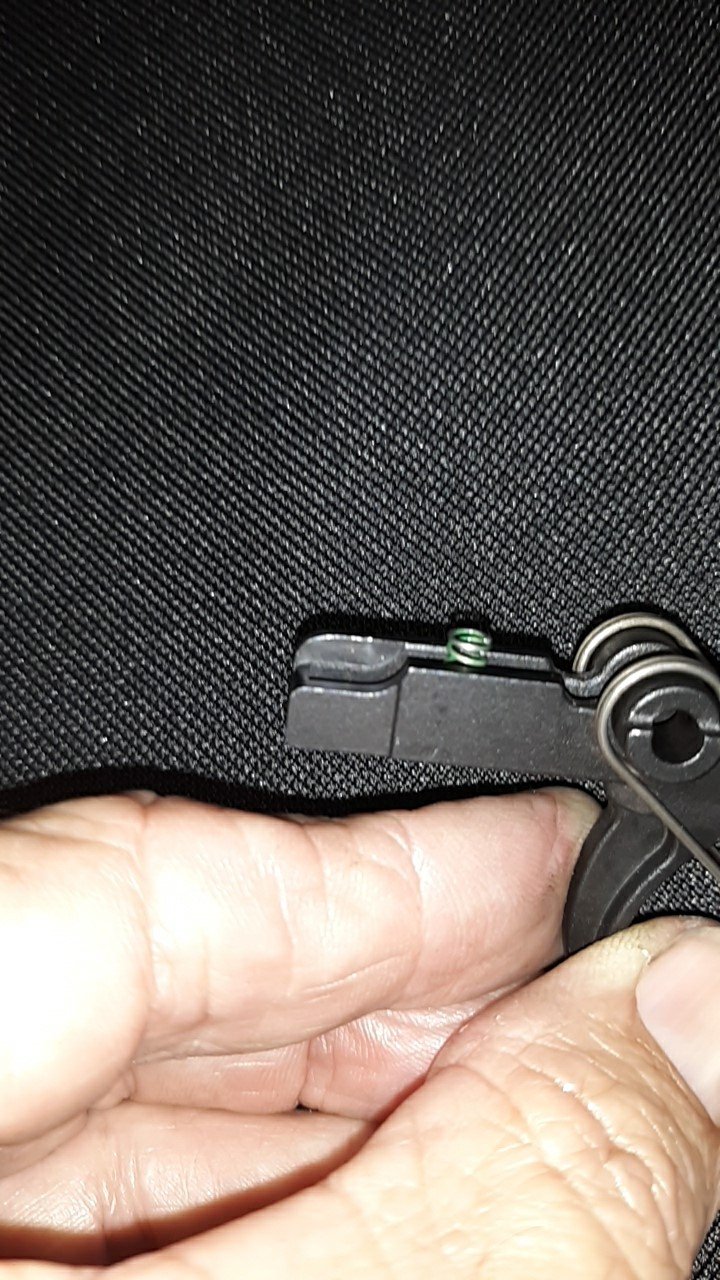

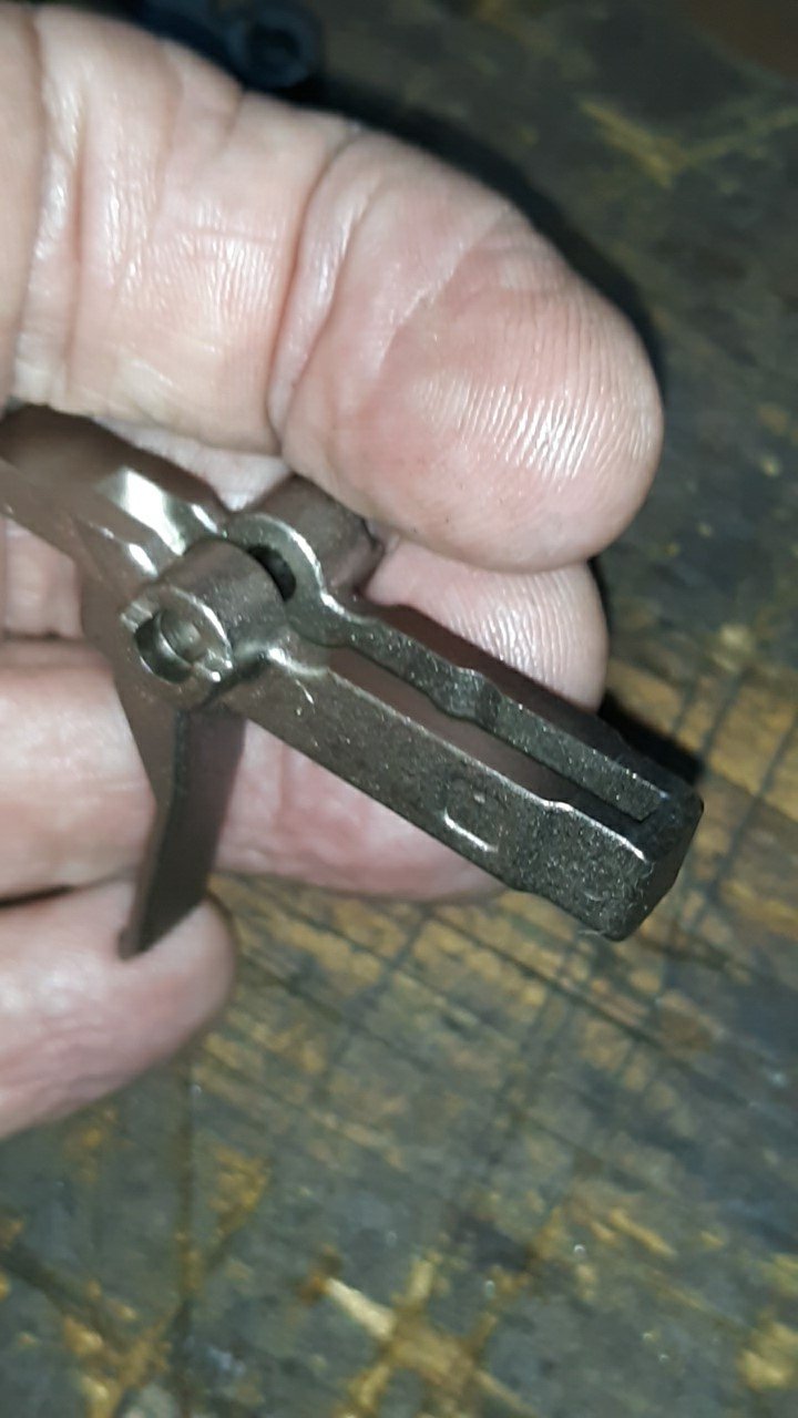

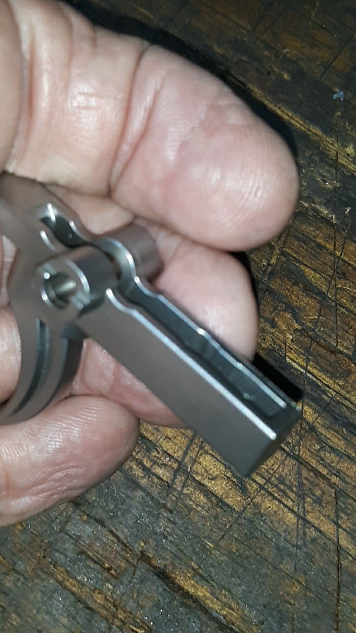

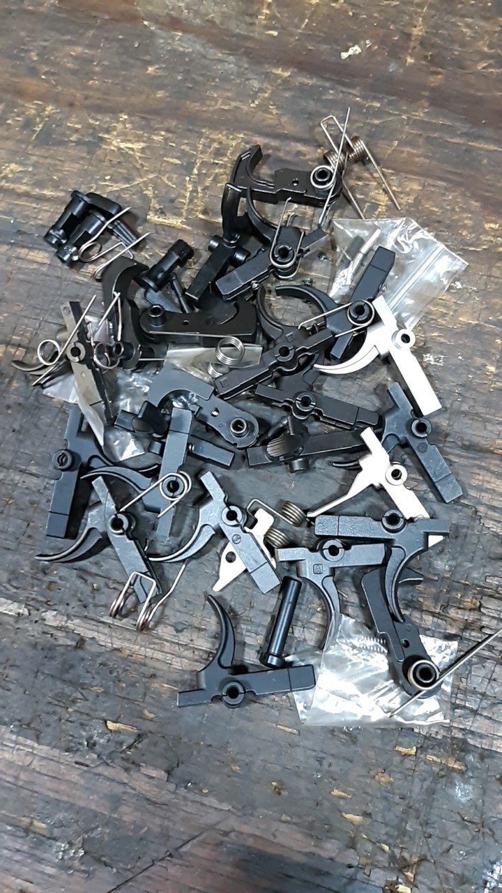

These are standard mil spec triggers, the rear part of the trigger is what you would need to take off. i have three or four bags of these triggers and hammers
Here it is. I just polished the curved part on the back of the trigger where you illustrated and put it back together. There is still binding, but it's a little better.

Yeah that's a higher shelf than needed. it needs cut back a little. how far will the lever go back before hitting the shelf?
I'll do a little more polishing tomorrow or before Monday anyway. I won't be able to test fire again till next week. Thank you for the help. I'll keep an eye on this post until I get things figured out and then post a paragraph on the steps to help the next guy.

I used an H3 Tungsten Buffer with the stock buffer spring. I polished the back of the trigger mechanism as illustrated in the photos above posted by Belt Fed.
The M&P Sport II that I purchased has a "high Shelf" as shown in the Pictures above. I used a small Dremel bit to taper the shelf so that when the reset mechanism contacts it, it contacts on a flat angled surface instead of an edged surface. This allowed the reset mechanism to go far enough back that an 1/8 inch drill bit will be impossible to remove when pushing down on the reset mechanism.
