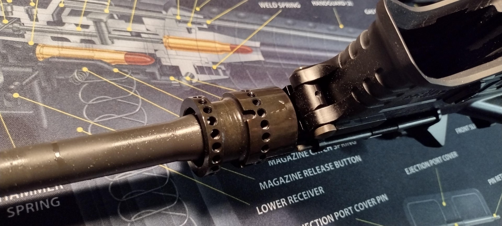

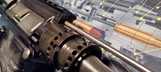

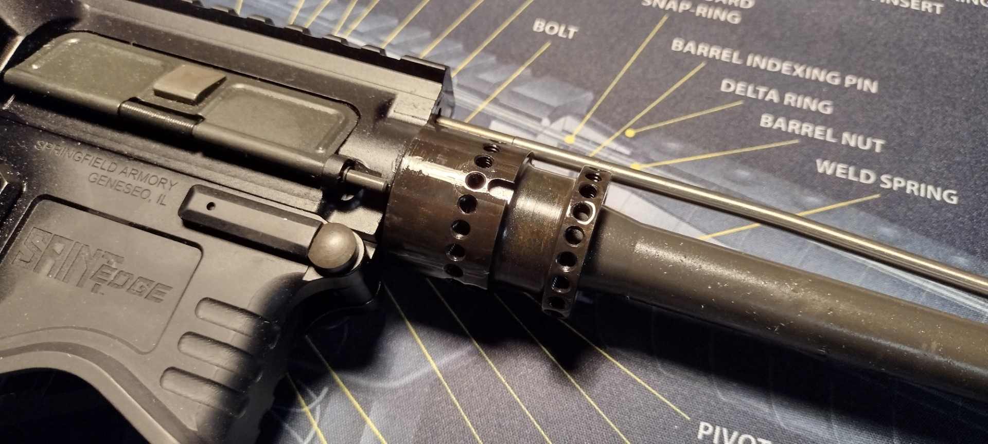

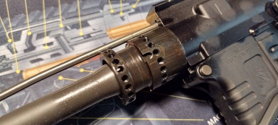

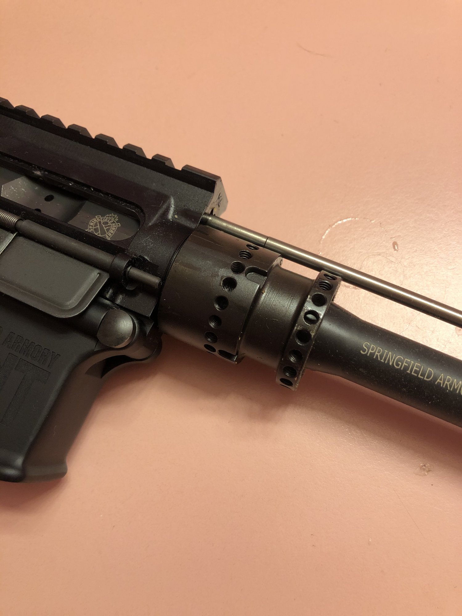

Can you post a picture of the barrel nut on your gun? That'll help me to help you.
Hi Texas...sorry for the delay getting back to you. Didn't see your posting till tonight. Here are the photos of the barrel nut you asked for, from all four sides, to advise me on the proper barrel wrench needed for my Saint Edge. There's four U-shaped notches around its circumference, spaced 90 degrees apart. One is hidden under the gas tube.
This is my first AR & first time taking her apart (aside from cleaning after range time), so any words of wisdom, help, or advice is appreciated. I'd also like to collect the proper tools to maintain & mod her downstream, so any recommendations you have for quality tools and where to get them is appreciated. I have decades of normal tools collected to work on my cars, computers & just about anything else, but only have a faint idea of what I need for this rifle & building my own as a hobby later on.
Thank you
Thank you
You're able to use 2 styles of barrel nut wrenches with that. There is 1 that slips into the notches (I think there are 4) and a pin style that fits into the holes (just 1 hole). The 1 that fits into the slots looks similar to a buffer tube wrench (probably not the same size?).
Thanks, Texas...I didn't know the holes were for that purpose. Learning, learning, learning, as I go along.

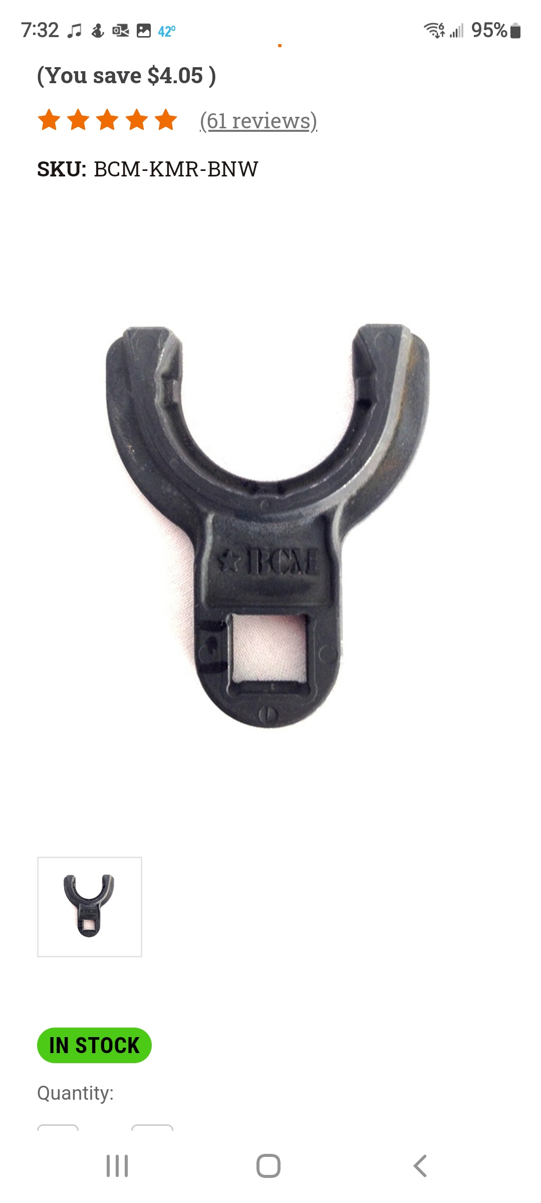

You were dead right XDMAN. Got the wrench today, worked great. Next time I see the BCM guys at our gun club I'll ask them why I was given faulty info. Thanks again for your help.

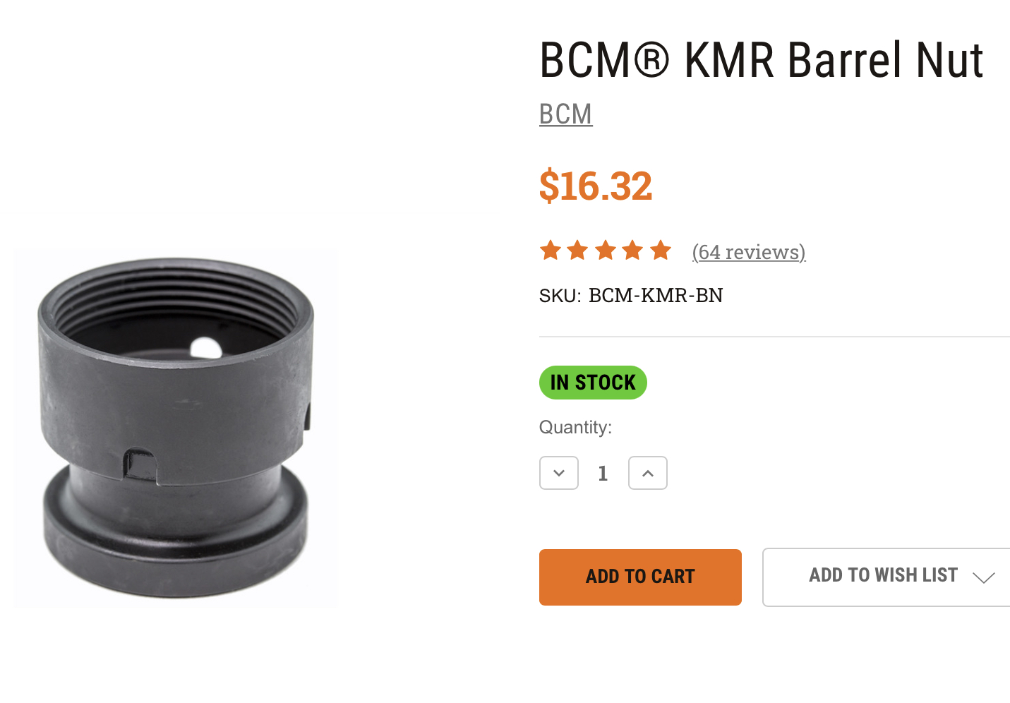

I also have a new Edge. Could you share the link to the BCM barrel nut wrench you bought?

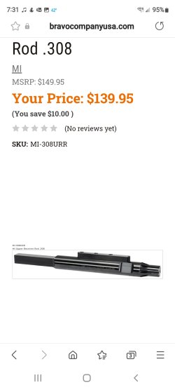

Here's what you'll need. The action rod isn't required, but helps on possibly keeping from twisting/torquing the upper receiver. Bev blocks (Magpul) would be a second choice.

Also putting some aluminum anti-sieze on the receiver threads isn't required for assembly, but isn't hurtful either. Remember you need a torque wrench (is required), unless you have a good way to know your limits.
Thanks...I missed that link earlier. I have torque wrenches, so that nut wrench will work great. I'll check out the action rod & Bev blocks when I hit BCM, Palmetto, etc, to bleed my wallet this weekend.
