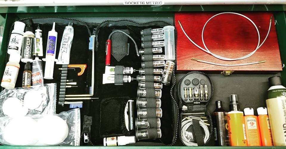

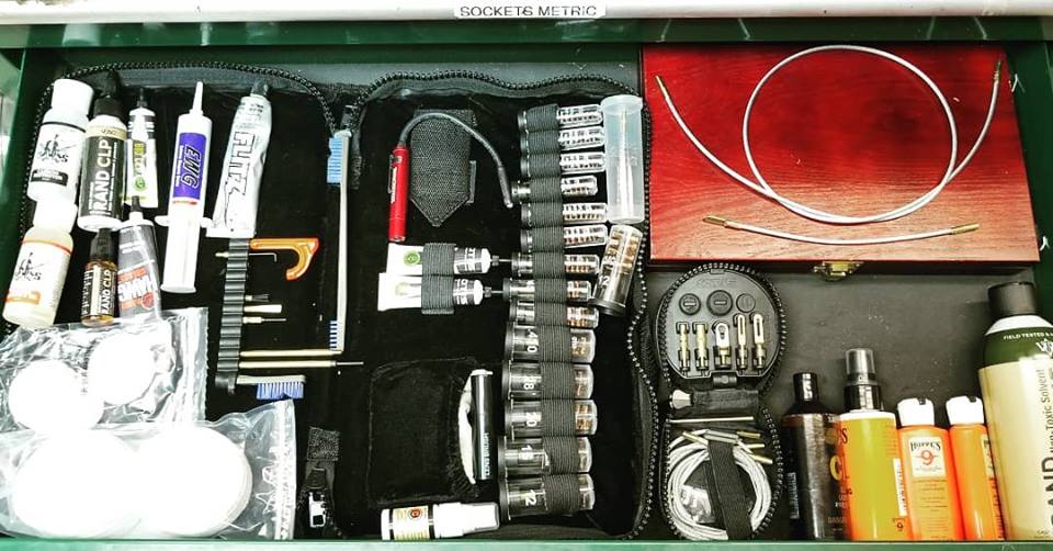

Yup, the complete Otis cleaning kit. Got it myself, has everything you need (of course it looks like you got some extra lubes & sprays, a bore scope light, etc.,) Mine had a few lubes in it along with all the brushes, cleaning cables of different lengths, patches, portable field cleaning kit, etc., likeTactical-Reviews picture shows. Thumbs up Tactical (y)
