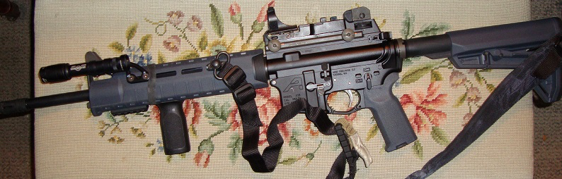

My AR came with a red dot, works great...but it did NOT come with any co-witnessing flip-up BUIS and I want to add them for obvious reasons. Front pic rail is the top of the gas block, so metal front sight is a must. Would love the KAC micros, but I can't spend $500 on BUIS. Leaning toward Midwest Industries (local to me is a plus)...but some I respect say the Magpul Pro should be in the mix. Troy makes good ones for that AK round front post guard look. Also heard the Bobro Lowrider should be in the mix. Anyone have comments? I'd prefer to keep it under $300...all the "reviews" online seem to be paid advertisements.
Any of the ones that you selected really should be just fine. I have first-hand experience with the Magpul Pro and MI, and have enough friends with the Troy. None have ever been problematic in terms of class/training use. Most folks just go with whatever fits the form-factor or spacial requirement that they're looking for.

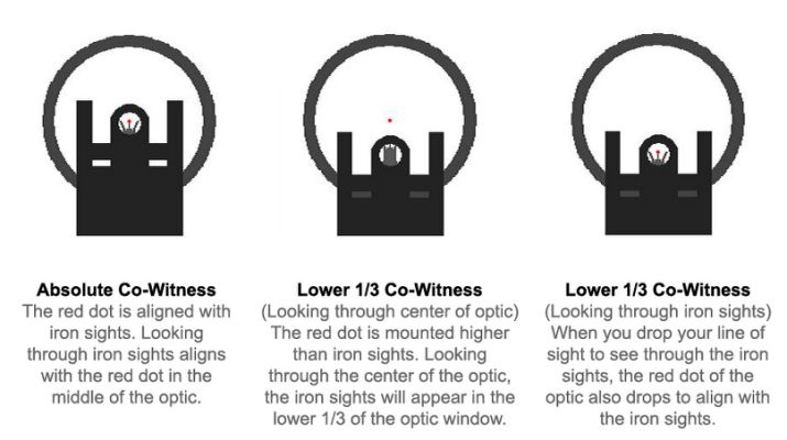

1st what height is your red dot at? Are you JUST 1/3co-wit or full? I prefer DiamondHead due to the shape even though I have do have Troy, various Magpul and some other stands. All range from poly to metal. Some I've change the front post out with a duel adjustable cross -hair reticle for a 2nd range. I chose more times over the DiamondHead for easier windage adjustments by visually knowing/seeing where the post is in relation to the diamond shape staying constant.

I want to co-witness, and astigmatism allows me to use the red dot out to between 50 and 100 yards, then the starburst covers the entire target, thus I would use the BUIS beyond 50 yards...probably have them up any time shooting. Read from you guys about certain dot optics that are better for astigmatics, but I'm not going to spend $500-1000 on a new optic any more than I want to spend $500 on BUIS. The rifle is a range plinker only...although I keep of enough ammo for end-of-times scenarios...I figure spending the $$ on the ammo is better than nothing. Appreciate the comments.
I am toying with the offset BUIS concept. Thought co-witness was the way to go, but offset is making more sense as I think it through (and maintain the field of view with an unobstructed dot)...
Tex, my dot is mounted full height on a riser. It's as cheap a dot as they come...Crimson Trace (came on the rifle). Smith calls it a CTS103, but Crimson Trace calls it a CTS-25. $80. 4.0 MOA (blech), but my eyes don't let me use a dot beyond 50 yards anyway, hence my desire for BUIS. Again, this a recreational platform for plinking. Any serious firearm usage around the home is covered by sidearms...

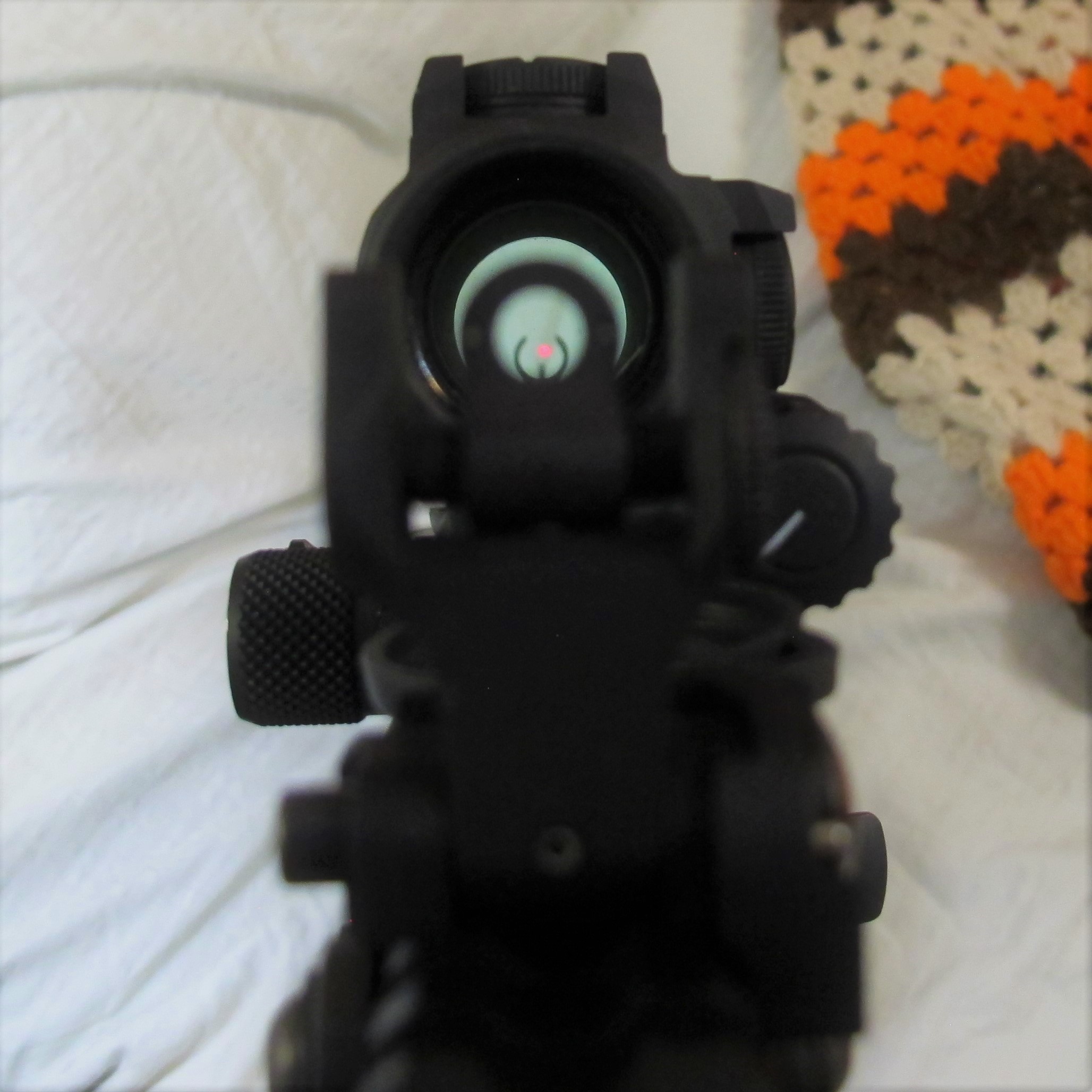

In addition to being full Coke-bottle nerd at -5.50 in both eyes, I have astigmatism in both eyes, too, -1.25 / -1.00 CYL, OD (R)/ OS (L - dominant eye, but my dominance can be overcome by "forcing" the right eye through an optic or aperture), both at -180-deg. axis.
A few years ago, while attending the first AR class that allowed me to actually go beyond the 100 yard line, as we started pushing yardage, the dot in my Aimpoint T1 (4 MOA, which doesn't help, but I'll get to the reason why I chose the larger dot to start with, later), I start seeing a growing "comma" that quickly began to grown to "starburst" as my eyes were and more more strained. At the 165 yard line, we moved to engage a 6-inch A-zone (from a progression of a full-torso to a 12-inch gong), I could no longer find the proper hold due to the growing smear I saw of what should have been a clearer dot, and I quickly started to fail to connect with the steel, losing it after just the first two shots (which both connected). And what's more, even as I had verbalized to the instructor that this problem was occurring, it actually worsened as we transitioned back to the larger targets, which I surprisingly also was no longer connecting with as we rolled back through them after my misses on the 6-incher.
The reason for the diminishing performance?
As my then-boss and professional mentor (we're talking about a full-fledged, tenured, Professor of Ophthalmology, Medicine, and Pharmacology, as well as a Veteran's Administration Career Scientist - and an outdoorsman to-boot) assessed, it was just a matter of my eyes having "gotten tired" - what I'd been able to hold and compensate for gradually eroded as the day wore on and as I asked more and more of my eyes for longer and longer periods.
My solution - after hashing it out with my instructor for the class (Andrew Blubaugh of Apex Shooting and Tactics, who, when he was active in the Marines served in FAST, and later taught at Rifles Only after discharge) - was to go the route of a LPVO. I later vetted this for myself in several close-quarters and low-light training classes, and it's now the route that I've been going. But at the same time, I also explored a bit as to what I can do to make RDS work for me, both with the understanding that the same T1 is still resident on my home-defense AR - for some very good reasons - as well as with future-proofing in-mind, in that I will likely have to transition to pistol-mounted RDS sometime within the next decade, too.
For me, for virtually any scenario I can possibly envision in terms of home-defense, the vision/optics limitations I experienced in class will most likely never come into play. The likelihood that I'll need to take the gun to the 50 yard line (for which I am perfectly proficient with the pistol) is nearly nil, to speak nothing of the 100, given that I live in what is a rather densely populated "near-inner-circle" commuter suburb. The bomb-proof nature of the the T1, its amazing battery life, and its low weight (it sits on a similarly flyweight Larue QD mount) really makes it an ideal partner for my defensive AR as it also allows my teenage daughter to wield the weapon. And even without corrective eyewear to compensate for my awful nearsightedness, that 4 MOA orb remains super easy to pick up (as I'd hinted above, this is primarily the reason why I decided to go with it instead of the 2MOA).
I simply understand and deal with my physical/vision limitations as just that, a true limitation on what I can - and should - do.
And towards this -
Proper technique helps a lot.
With modern RDS techniques, the reason why we us it is because it makes us fast to get on-target. To a certain extent, that reticle/dot does not even need to appear centered in the aperture of the sight for us to get a hit, and that gives a tremendous advantage to its user. However, in order to achieve this speed with the certainty of hitting, we must physically look at the TARGET (instead of the reticle). This (correct) technique is target-focus, and in-practice this also will help those of us with astigmatism to resolve a better "dot" - as we are visually "blowing through" that projected reticle, with both eyes open, seeing the TARGET clearly, with the "dot" projected over it.
This works both with long-gun and the handgun-mounted RDS.
It really wasn't until I started shooting RDS handguns that I started to realize just how much properly target-focusing can help overcome the blurriness and aberrations that my astigmatism caused, and this really translated over to my use of RDS on long-guns as well.
Towards the latter, upon my questioning in class (c.2017, APD Basic Carbine), John "Chappy" Chapman - one of the "BCM Gunfighters" and a true SME in the lights/lasers/optics sector of the industry (his expertise has been sought by the lines of Steiner and B.E. Meyers) flat-out said that a good shooter, even with significant astigmatism, should be able to successfully engage center-mass targets out to the 300 yard line with typical 1 to 4 MOA red-dot sights, without the need for magnification. This bit of encouragement by him really got me back into working with my RDS guns.
^ And that's without "cheating" - i.e. dropping your eyes behind the BUIS, whose rear aperture will, through optical principle, help even those of us with significant astigmatism to resole a much sharper "dot."

I understand that you don't like visual clutter, but, particularly with the use of a lower-1/3 cowitness setup, even with a fixed BUIS setup, the irons really won't intrude that much:
^ With proper use of "target focus," allowing your eyes to "blow through" the optic (and hence also the irons) - which might require a bit of extra practice/acclimation on your end :) - you may truly not find the irons all that intrusive: and this "always there" setup will also allow you to instantly sharpen the resolution of that projected "dot," by dropping your eyes through the irons.

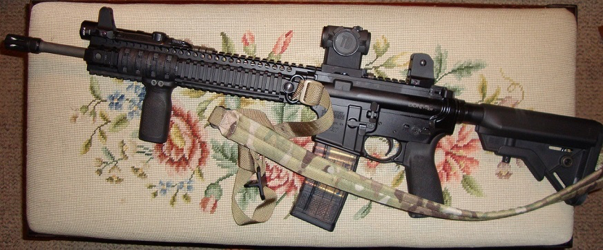

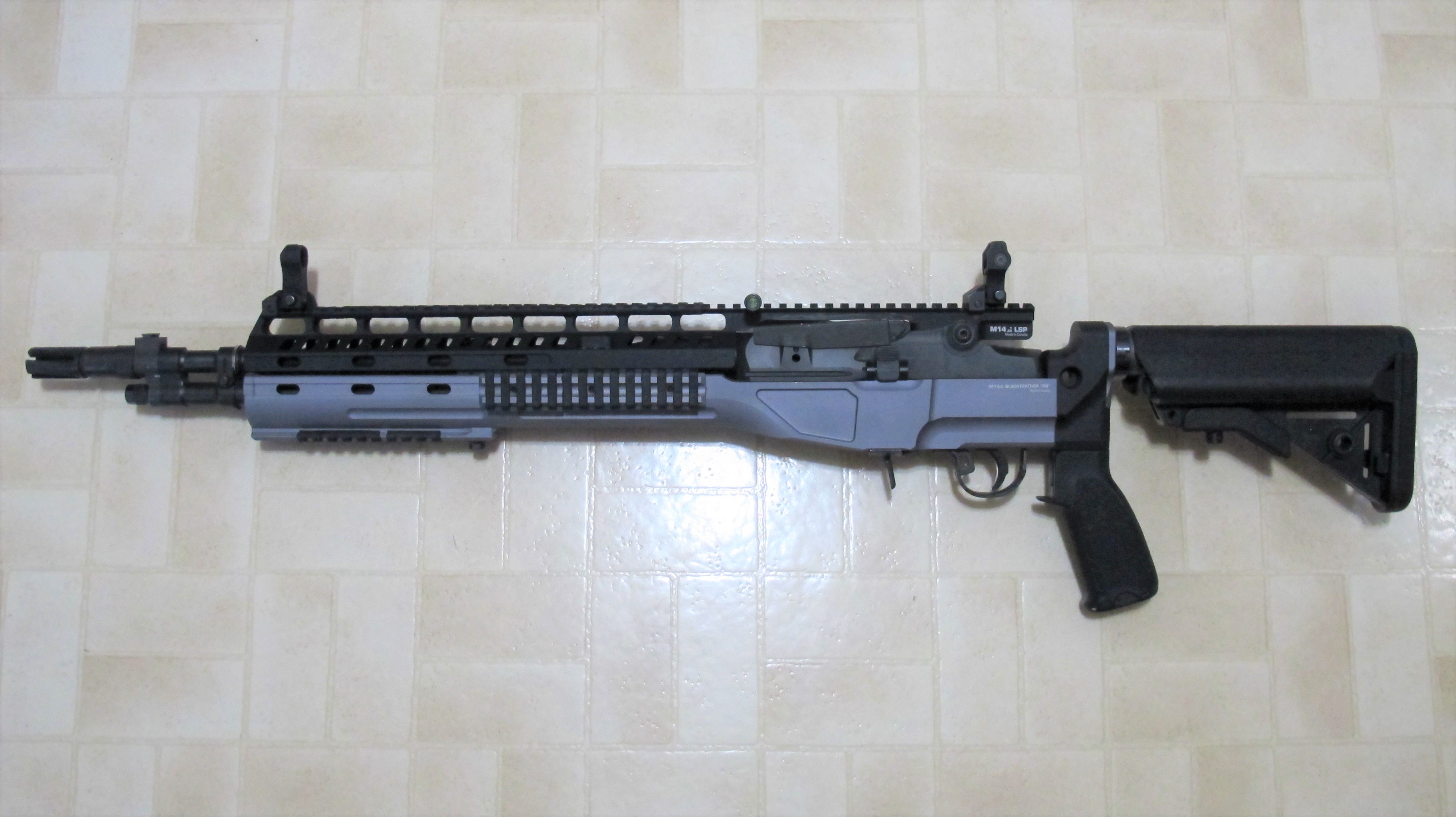

Both my HD and my hobby ARs are set up as fixed, lower 1/3:
^ DDM4V5LW, c.2012 - my home-defense AR. DD fixed front and rear.
^ My hobby gun, an Aero complete Midlength AC-15 which I bought to tear-down and put back together for a local armorer class. That's a C-More Tactical from back in the day, which is a flat-top mount reflex sight with an incorporated A3 rear drum. The gun is a middy, with a FSB (shrouded by the Magpul SL handguard).
The DD was the AR that I started really taking classes with, and by the middle of the first day of the second 2-day class I attended with that gun, when we were shooting from within the 100, I honestly wasn't even seeing the outlines of the irons any more.
