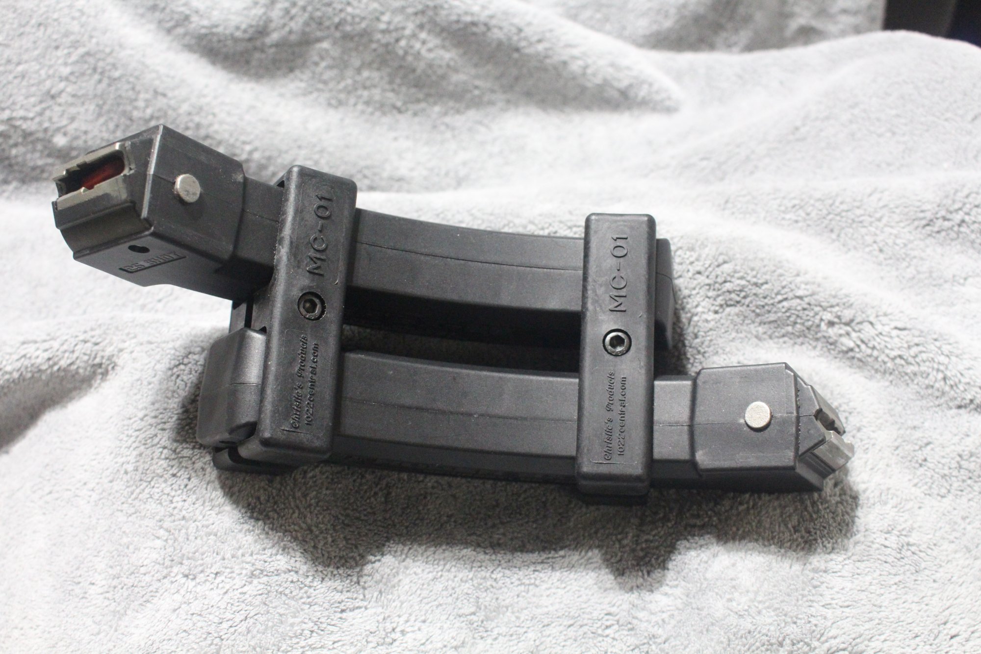

I bought the connectors that clamp two BX-25's together for my Ruger Charger 10/22 Takedown Pistol
They work great.

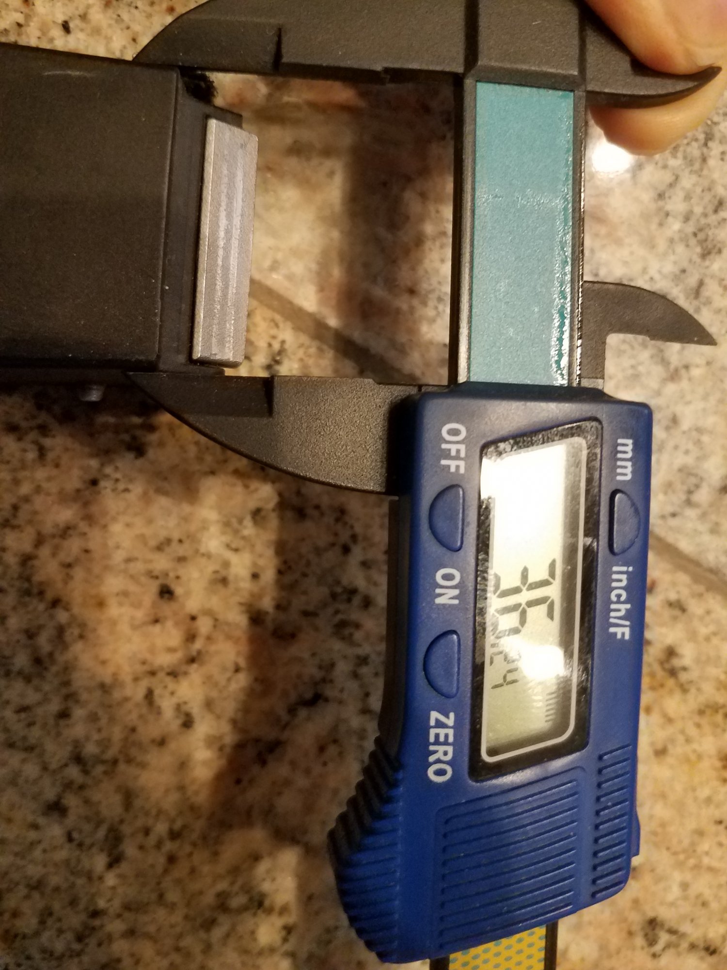

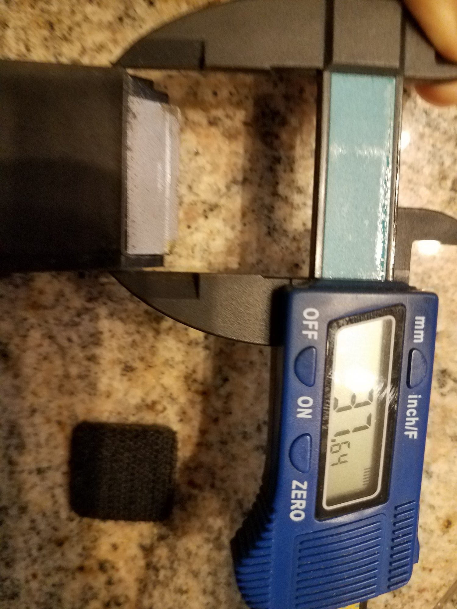

Its due to the dimensions of the top of the magazine. If you put 2-3 layers of masking tape on the front above the catch it will tighten and you will not have so many failures. However, it may get too tight with carbon. This is why i use the soft velcro. The issue is that the feed lips on the mag are moved out of alignment with the play. Compare it to a 10rd. Lock the bolt open, insert an empty mag and push on the front and watch how the angle of the feed lips changes. Its not much but enough to cause a FTF. This is how you get the rounds catching.
Also polishing the lip where the rounds might catch helps. Just use a dremel with a soft polishing stone to take off the edge, about 1/2 mm.
