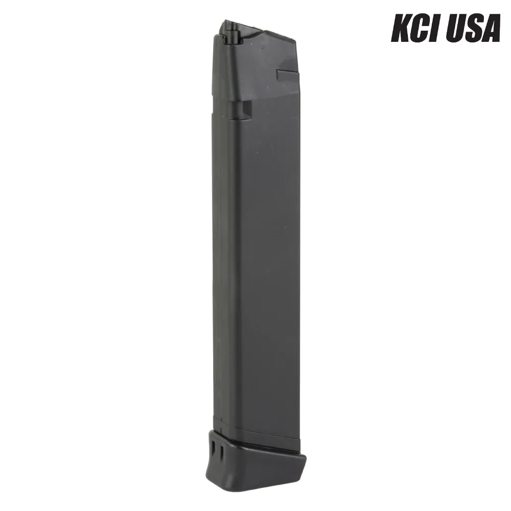

Yeah they might work because they are a oem glock mag with a extended base pad but $60 bucket per mag is 🤪 crazy
They're on sale at GMW for $53.49 (yeah still expensive I know):
https://gunmagwarehouse.com/kriss-v...d-extended-magazine-for-glock-21-pistols.html
You could also try Global Ordnance 26 round (The Mag Shack):
https://themagshack.com/shop/pistol...nd-extended-magazine-for-glock-21-30-pistols/
or KCI 26 round (The Mag Shack):
To see if either would work as a cheaper alternative to the Kriss Vector. Looks like the KCIs got a bit better review that the Global Ordnance on The Mag Shack website (although I didn't read them, just going off the amount of star ratings).
as for the kriss extended mags in 9, 10 & 45 in use for the vectors, none worked reliable for me..........10mm mags were the worst, but did better in an off brand lower i built. i will say it's the mag problem for sure on mine! the 45 mags took some tuning to work in the glocks and the vector. i had better luck with the kci drum mag. using factory glock mag and kriss extension it would bind where the 2 come together when the follower was at the junction. if you can find a drum style mag get it instead on the stick kind.............works best from what i've experienced
