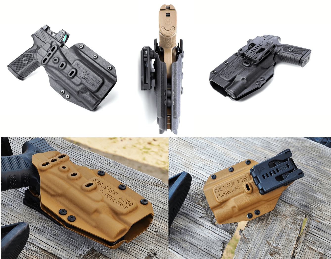

And lets also look again at the civilian side of the question, too. Currently, the de-facto Gold Standard for multi-gun/multi-light (the Modlite PL350 model will be released simultaneously with the light) capability IWB/OWB passive-retention-only WML-enabled is the PHLster Floodlight:
^Picture take from OPTactical.
Geared towards conceal-carry, it's gained a large following even among the "gear snob" crowd on the likes of P&S and similar. Yet, there's still an undeniable gap in that area....

^ And that's the up-shot of this one...
As you can see from the samples above, that "good" coverage really can only go so "good" before it becomes impossible to draw (or insert, for that matter) the gun.
So then the problem becomes one of purpose: i.e. "is the juice worth the squeeze?"
For those who must have a light/laser on their handgun, the form-factor of the accessory often, if not always, translates directly to the capabilities of that item, which in-turn has direct implications on whether or not it would be suitable for the specific use-context. Here, as a concrete example, the lower output and lesser reliability/durability of items such as the Surefire XC-1 and the Inforce WILD1/2, respectively, while suitable (if not acceptable) for a civilian legal concealed-carry context arguably would be insufficient for duty/service use. But with something like the Surefire X300U, that holster mouth/trigger gap has to be considerably bigger, or otherwise insertion/removal becomes impossible.

The companies making the gear above aren't fly-by-night operations. Safariland is one of the biggest and most respected in the duty/service segment, and names such as RCS, Bravo Concealment, PHLster and Dark Star Gear carries not only cachet with "the in-crowd" but have seen actual municipal/governmental contracts for concealed-carry/low-vis gear truly because they put exceptional thought into product design and execution. Unless the makers of the lights are able to further innovate and come up with a new form-factor, there's truly parameters-based limitations, here. Certainly, over the years, continued refinement and evolution of designs have narrowed this crucial opening, but even so, it's far from gone, and incidents such as this (or more tragically those involving innocent children) still occur.
You're absolutely right: the crux of it is that the end-users -be they the average-Joe/Jane legally armed civilian or a high-speed/low-drag professional operator- have to understand the limitations and compromises that their gear and its setup carries and demands, and train to best compensate for such concerns.

That, versus the same holster, designed for a different WML - you've all seen this picture before, from one of my previous posts in this thread, but here it is again:
^ Image taken from the OP Tactical site.
Note the difference between the PL350 variant, versus the Surefire X300U-enabled variant.
As I wrote previously, for those who do not know, PHLster is considered one of the leading and arguably most innovative Kydex concealment holster makers today, and is highly regarded both within the community as well as by SMEs.
