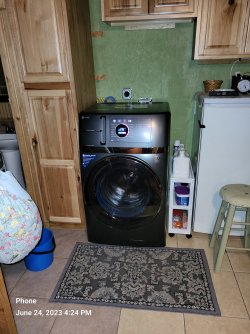

but last month we gave in after 20 plus years on the old kenmoore and its rebuild and got a new all in one GE
its a freaking game changer and at the time 1ks less than buying 2 machines washer and dryer
