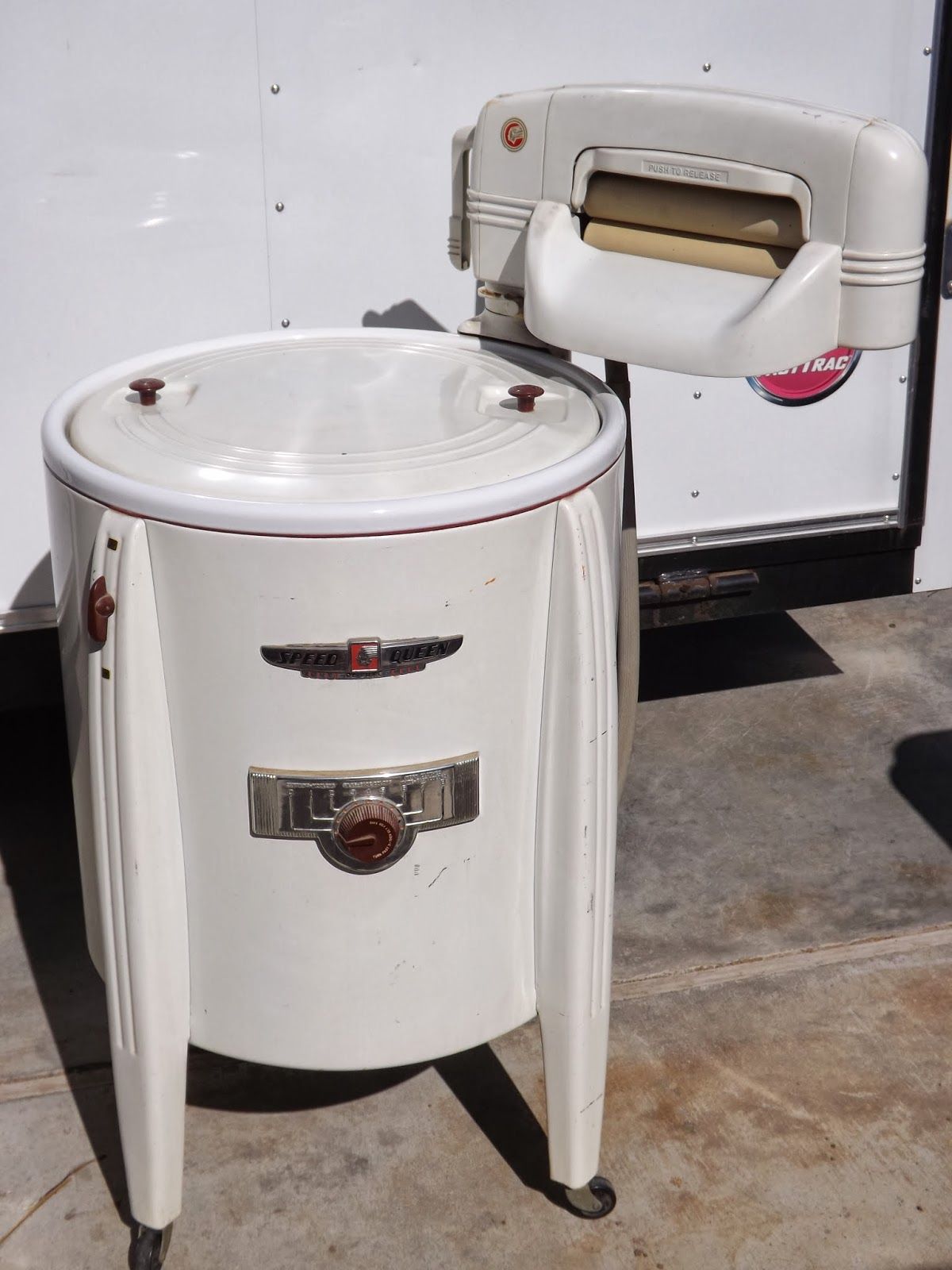

Old_Me, just a hint but since the machine is as old as you say, check around the underside of the lid of the machine for a small, probably plastic (maybe metal) pointy thing that matches to a small hole in the cabinet where the lid closes down. Inside that little hole is a micro switch that when made by the pointy thing, allows for water to fill the machine by closing the circuit to the water fill solenoid valve. Those little micro switches are prone after so many years to getting really brittle and breaking at the least opportune time, especially if the lid gets dropped hard. That may still be a safety on current machines, I don't know. Haven't had to go into a washer in a long time. If you find it, you can test it by sticking something down into the hole where the switch should be if it's the pointy thing that's broken and not making the switch, or open the cabinet up and find the switch and by-pass it if it's the switch that's broken.
But either way, here's to you .... good luck! jj
