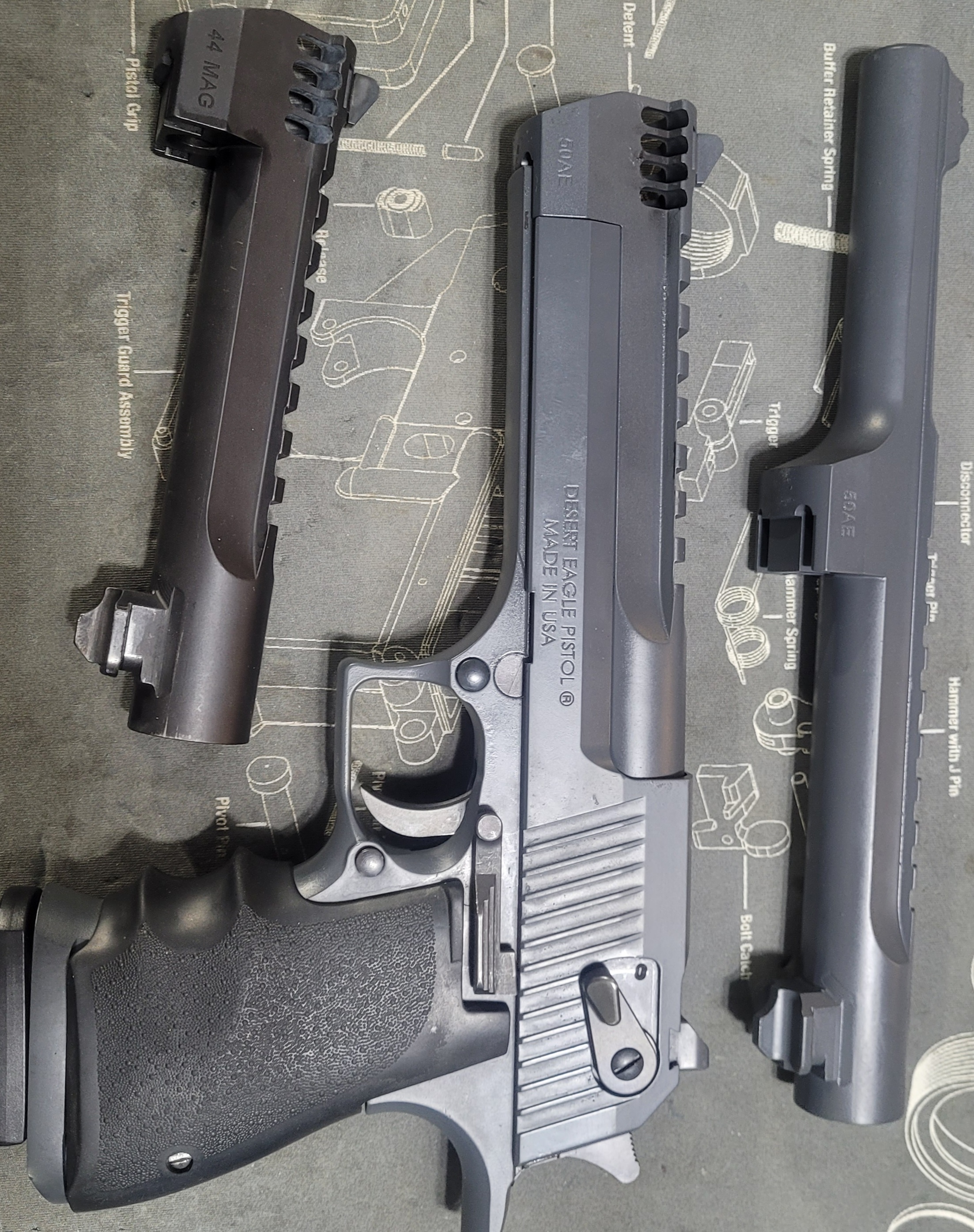

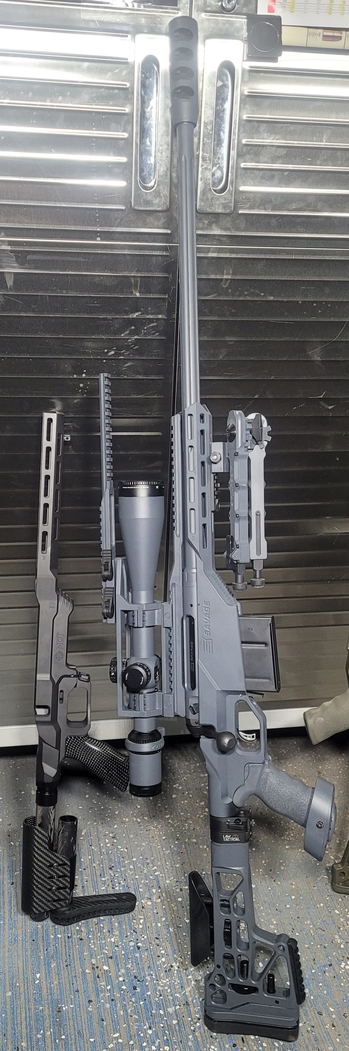

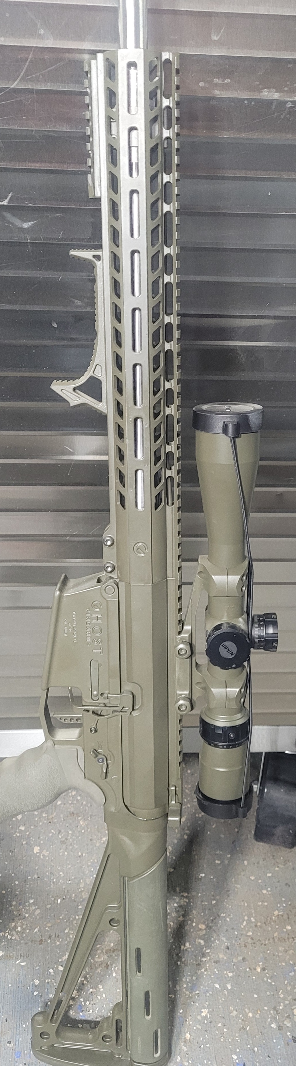

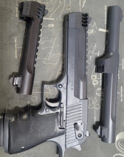

The DE in 50ae sniper gray (44mag didn't get sprayed). Savage110 stealth 338LM (sniper gray as all parts were in black originally) (will not paint bolt). AR-10 chambered in M118 CBI 22" in ODG. All parts painted were degreased and final denatured alcohol used as final prep. Everything painted were done individually (not as assembled when painted). Only trigger shoe painted, not entire assembly. Used a heat gun between thin coats for drying. It has withstood all chemicals used so far. True it isn't as good as ceracote, but does a good job when all oils/grease is removed.
