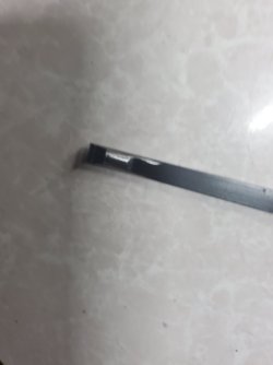

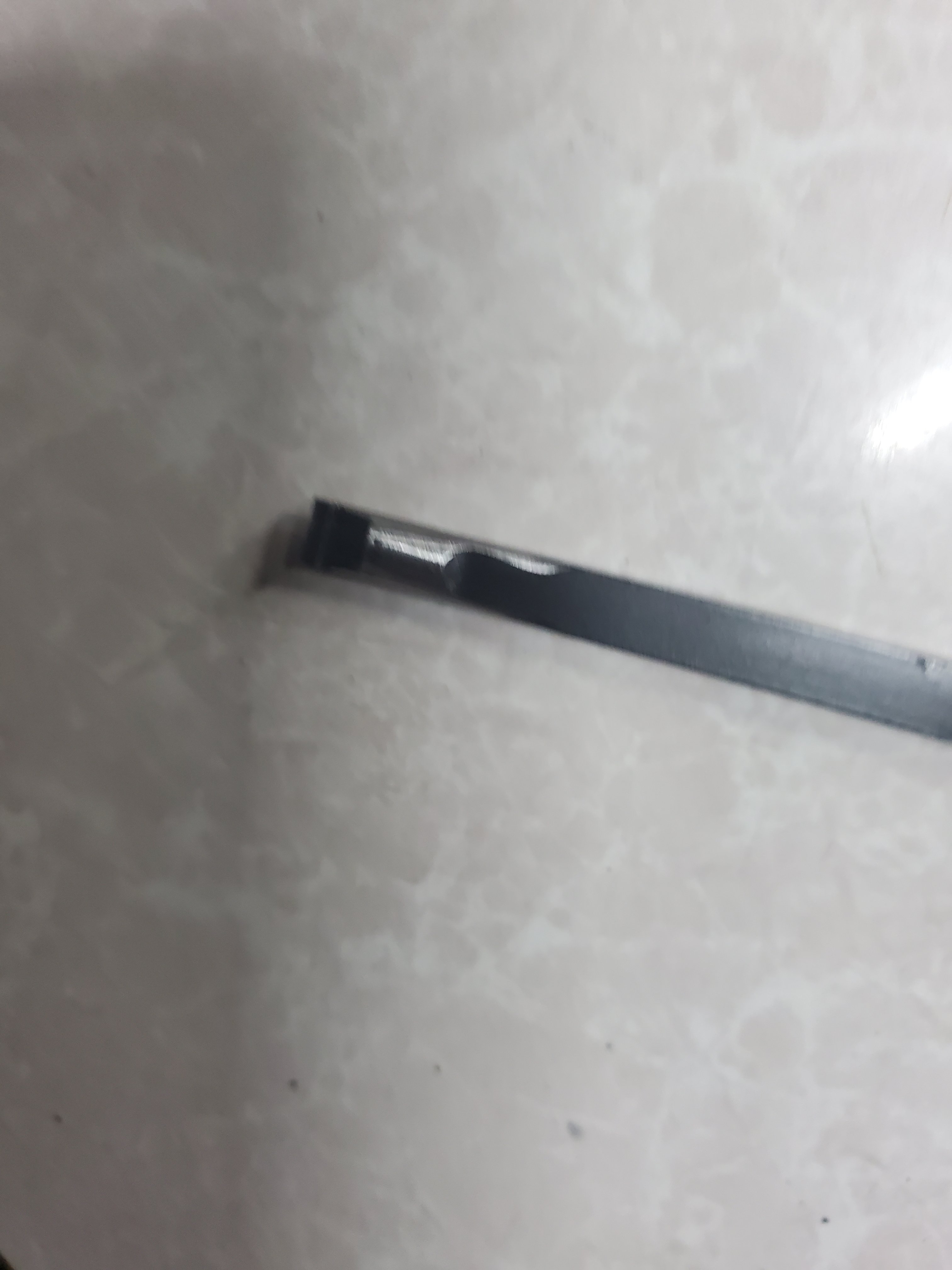

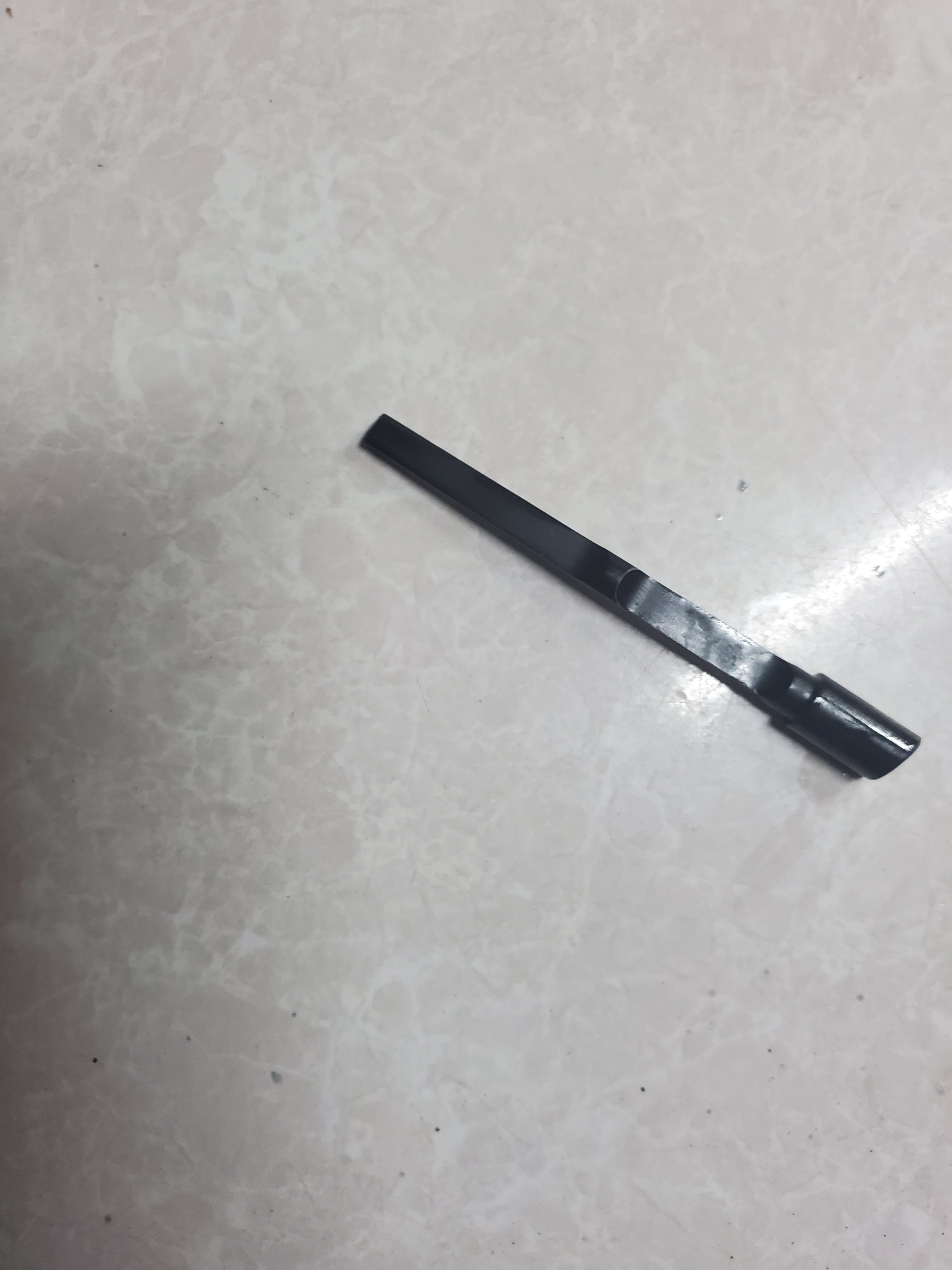

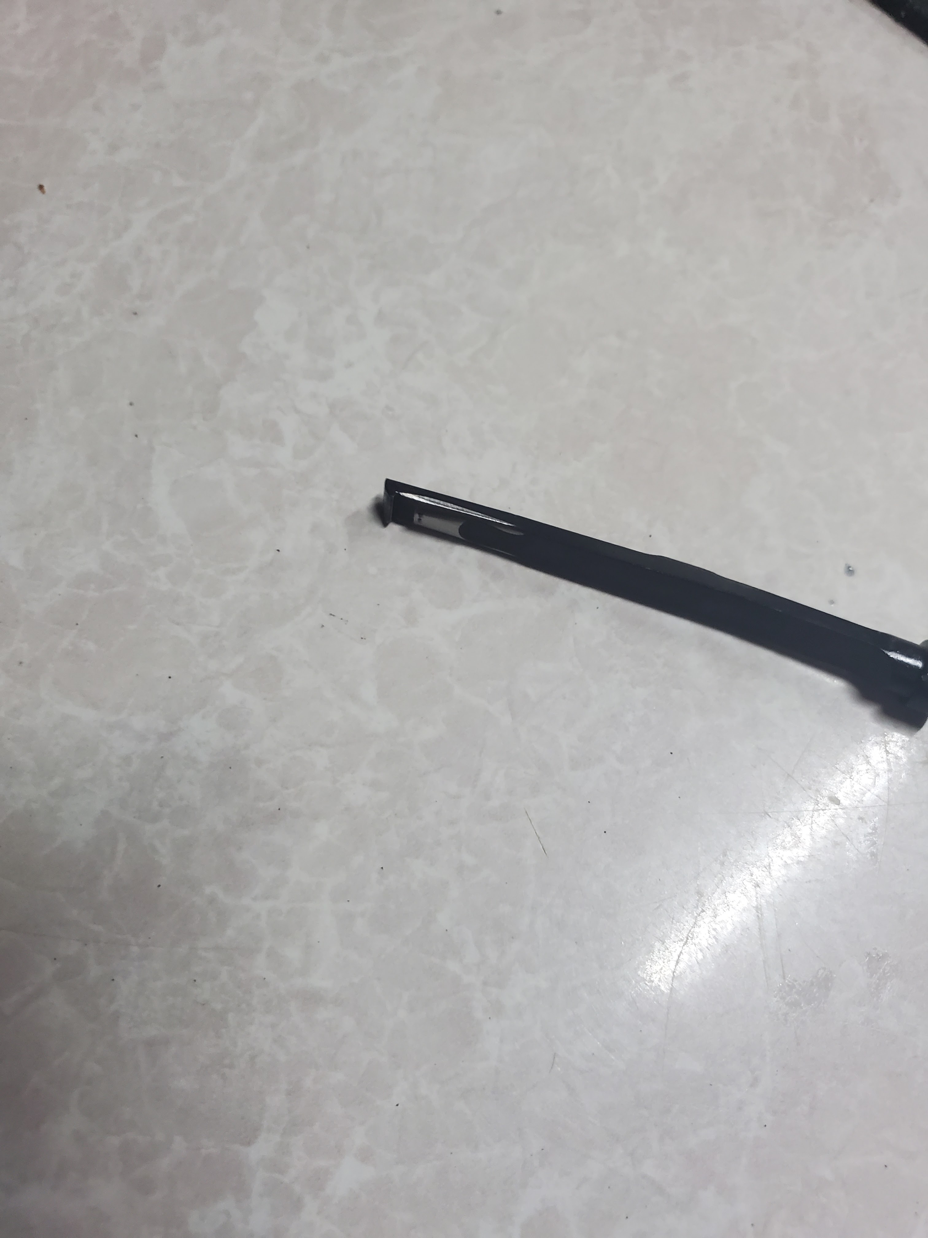

I was Cleaning guns today and took the garrison down and decided to clean the extractor. first it was hard as heck to get out . does this look ok, the wear int the pictures ?? Or is it normal for 200 rounds
Thanks
I’m guessing that scratch was caused when you pulled the extractor out of the slide, only the very tip/ hook extends from the slide.
Not much actually sticks out, that mark is behind the hook, and you can tell it’s from pulling the extractor out cause of the tight fit, like a drag mark
Ok not arguing with ya but in large the first picture? That's above the hook . My Remington comes out easy never a problem . Is it I haven't done enough 1911s ?
Some extractors are very hard to get out, and yes the mark is above the hook, that part is inside the slide, and you can’t compare 2 guns from different manufacturers, the reason, it depends on how they adjust and fit the extractor, I still say it’s a drag mark from removing it, there is no way an round could/can cause that mark. I’m no expert but with over 30+ years with various 1911’s, and having seen weird things with them and how some manufacturers fit parts, you would be amazed, also the extractor will move back and forth a tiny bit as the round gets chambered due the the normal spring type action of the extractor, which also could cause/help make that mark
I'll be lmao ok thank you learned something new. This is my 2nd 1911 except the military 50 years ago. I really didnts know they were all diffrent. I know now thanks lol
